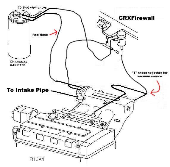

vacuum diagrams for a b16 in crx but should be the same for the most part.
What is all that stuff
