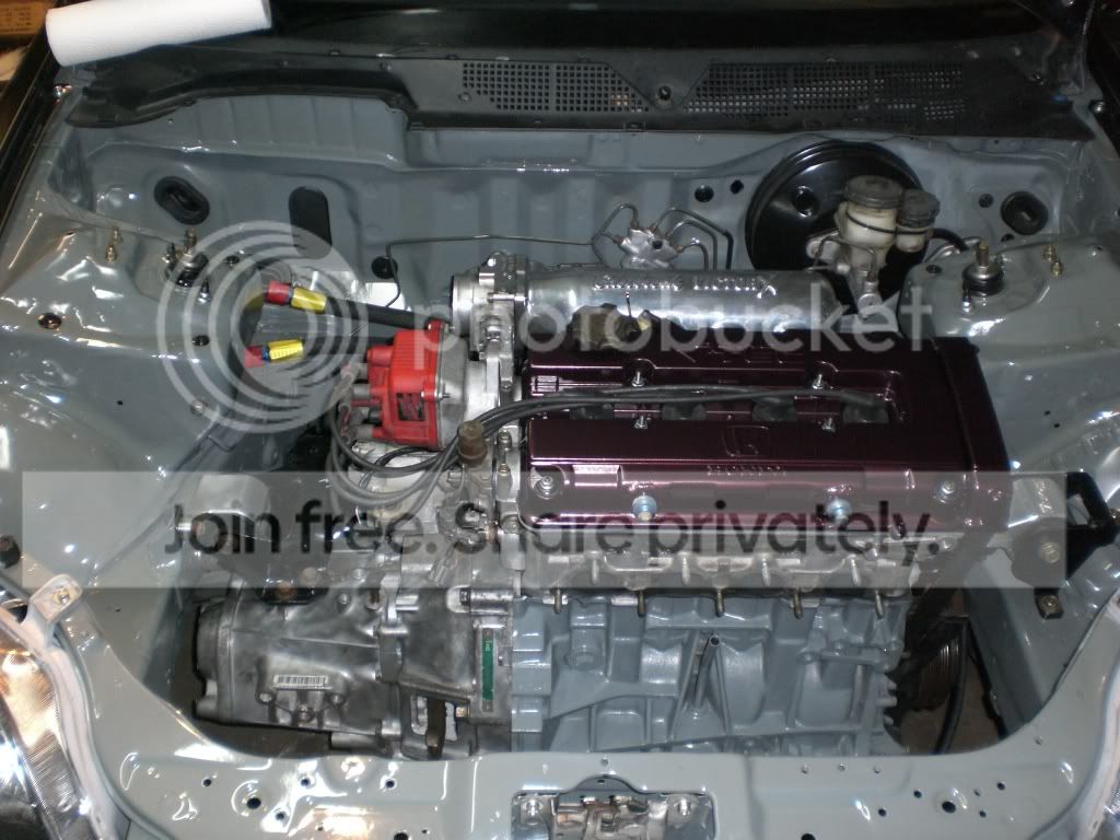

Holset users unite!
didnt know how to insert picutures on honda-tech so here are the links of yet another holset b16
thanks to all the members on the forum and for the valuable information i took while building my car.
http://img231.imageshack.us/my...8.jpg
http://img222.imageshack.us/my...3.jpg
http://img222.imageshack.us/my...9.jpg
http://img227.imageshack.us/my...5.jpg
http://img227.imageshack.us/my...4.jpg
http://img231.imageshack.us/my...3.jpg
http://img231.imageshack.us/my...6.jpg
yeh the manifold stays in one piece cus it does not hold the weight of the turbo. see the brackets ive put so the turbo rests on the block not the manifold
header wrap made a huge difference in spool times but also brought the issue of boost creep with a 3.5 inch downpipe
.. well had to run two wastegates to eliminate creep..

and the gsr should spool the hx35 i would guess at or right before 5k rpms
what would be the ideal manifold to run to avoid boost spike?? something of equal length I presume?</TD></TR></TABLE>
as long as the mani has good wastegate placement it should be alright
