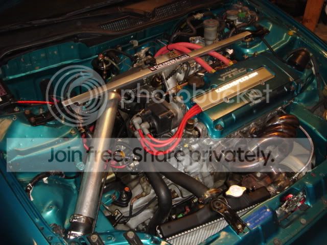

From: Elizabethton, TN, USA
Here's my build. All I'm waiting on is my body to come back from paint and a tune date to get scheduled! I want it done cause I'm tired of hearing that honda motor won't turn that charger over blah blah [freak]ing blah! Tell me what you guys think.
B18B .010 overbore
Wiseco 9.2:1 ceramic coated pistons
Eagle Rods w/ ARP 3/8 Rod bolts
Micropolished, knife-edged, and balanced crank
OEM Honda bearings
Moroso 5.5qt oil pan
ARP headstuds
Cometic Head gasket
Ferrea Stainless Steel valves
KMS dual valve springs and Chromoly retainers
Crower 404's
SKunk2 Cam gears
GSR water pump, oil pump, and GReddy timing belt
Edlebrock Victor X Intake manifold
680cc Venom injectors supplied from a walbro 255lph
AEM fuel rail and regulator
Custom manifold from MP Racing Development in Vegas
Manifold Jet Hot Coated by AMS also in Vegas
Tial 38mm Wastegate
Holset HX35 Turbo diesel charger
Spearco intercooler core with custom end tanks
custom intercooler piping from SRE
Fastturbo Couplers
Turbonetics Raptor BOV
3" downpipe w/ 3" E-Cutout
Apex'i N1 2.5" cat back
KOYO aluminum radiator
ACT stage 5 4-puck clutch
Competition Clutch 10 pound Flywheel
Hydro B16 Tranny w/ Gearspeed synchros and LSD
Energy Suspension Mount Inserts (5)
Tuned with an AEM EMS on around 18 Lbs
