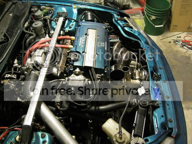

I know i just updated a couple pages ago, but i just had to share my improvement.
I upgraded my ssac manifold to a 44mm gate and rerouted the exhaust upwards. It used to be 2.5" downpipe the dumped about midway back. now its 3" and is about 1.5' long. As i stated before, it made 357 with a bad plug wire and 12psi. Its now running off the 1 bar spring and is making a full 15psi by 4500. Its roasting my 23" drag radials in 4th gear rolling into it. Its easily making over 400whp! Im looking for an Edelbrock Victor X mani. and ive got some custom grind turbo Skunk2 cams to get put in. I think with the stock sleeves and mani. and cams and a retune i can get 465 out of it with a little more boost.
What do ya guys think?

Ahh the good old exhaust through the hood days.
Love it dude. People used to love to see flames out the hood.

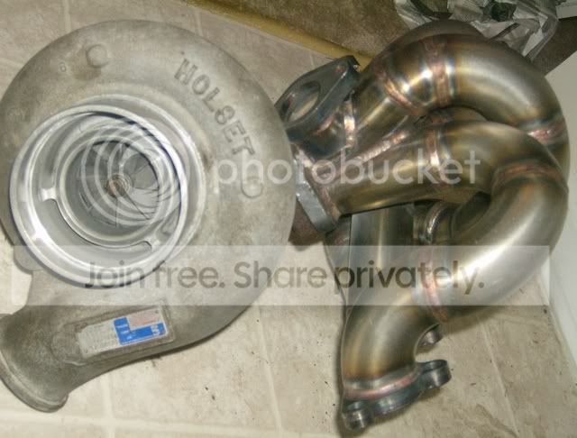

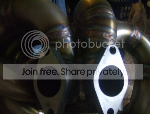

a couple of my new toys! it's been a good week lol...
twin scroll, dual wastegate, hopefully the D will hit full boost by 8K!!!

Default Re: (a1320honda)
nice dude!!!! looks sick

<TABLE WIDTH="90%" CELLSPACING=0 CELLPADDING=0 ALIGN=CENTER><TR><TD>Quote, originally posted by slowhitEJ1 &raquo;</TD></TR><TR><TD CLASS="quote">a couple of my new toys! it's been a good week lol...
twin scroll, dual wastegate, hopefully the D will hit full boost by 8K!!!</TD></TR></TABLE>
what turbo is that?
Holy hell!!! I hope you dont have much blow by! Otherwise you are going to end up in someones ***! Lol it look [freak]ing sick though!

Default Re: (big-cat)
<TABLE WIDTH="90%" CELLSPACING=0 CELLPADDING=0 ALIGN=CENTER><TR><TD>Quote, originally posted by big-cat &raquo;</TD></TR><TR><TD CLASS="quote">
what turbo is that?</TD></TR></TABLE>
dodge dealer said it was a hx35, from a 95-98.. the last one i had, that was stolen/ "lost" by a certain fab company, had a 7 blade 81mm compressor, but this one has an 8 blade 84mm wheel..

Default Re: (slowhitEJ1)
Nice! Don't be surprised if you hit full boost b4 8k rpm's with that setup. Too bad your 7 blade hx35 was stolen or displaced. The 7 blade they say flows a tad more. However you should still get nice results with your whole Twin scroll setup. Where did you get the manifold?

Default Re: (ceedawg)
<TABLE WIDTH="90%" CELLSPACING=0 CELLPADDING=0 ALIGN=CENTER><TR><TD>Quote, originally posted by ceedawg &raquo;</TD></TR><TR><TD CLASS="quote">Nice! Don't be surprised if you hit full boost b4 8k rpm's with that setup. Too bad your 7 blade hx35 was stolen or displaced. The 7 blade they say flows a tad more. However you should still get nice results with your whole Twin scroll setup. Where did you get the manifold?
yeah i hope so lol.. it should hopefully hit by 5 if it's anything like other people's setups.. one guy was running a standard compression vitara setup, ramhorn, and a hx40 and hit full by 5 on a y7 head with stock cam, but i don't know what his boost level was.... anyways, i'll have a 59500 cam, z6 head, milled as much as possible (.060??) vitaras, and this twin scroll mani, so i'm hopin i can cut it down some..
sorry, but i'm not telling you who made it.. he's out of business and rightfully so.. took 9 months, a district attorney, and a detective to just get my manifold.. lost the turbo in the deal.. you wouldn't want to deal with him if i told you lol
