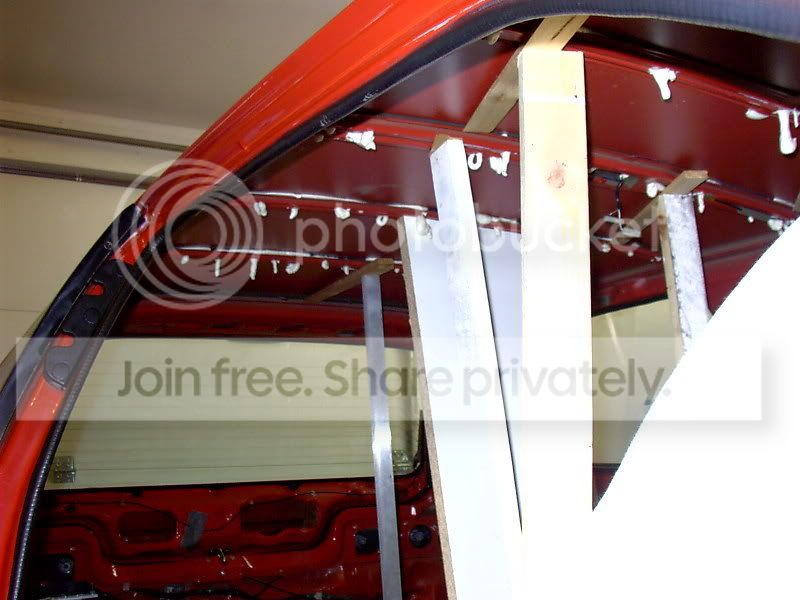

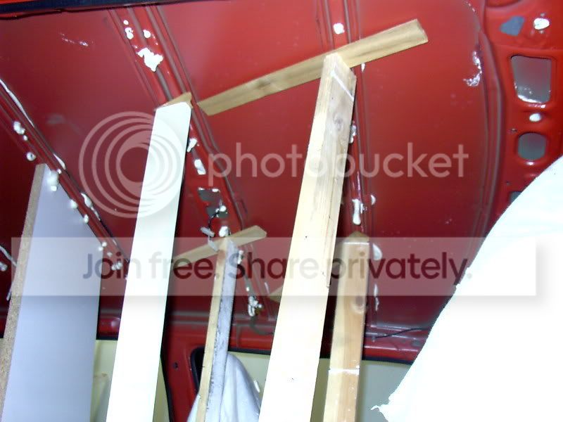

someone here had to re-glue the roof to the supports, and i was wondering what glue you used. all the supports on my project are separated

It was me. I used some stuff I had laying around to push the supports up, then I used Great Stuff expanding foam to fill the void between the supports and the roof metal. I covered the interior with drop clothes, because that stuff is very sticky. I also wore long sleeves and gloves. Where a hat too. I got some in my hair and it took a week to get it out. You can buy a 2-part epoxy at body shop supply stores, but I think it's about $100 for the glue and the special gun. This cost me $4. Be careful not to put too much foam in at once, because it expands quit a bit.

i have to do that to my roof supports i hope jb weld holds.

It's interesting that 2 of you from CA said your roof supports need to be re-glued. My hatch was from CA. I always assumed the sun and heat deteriorated the glue.

yea the sun plus i dont think that my friends beating on my roof helps at all.

You need new friends I'm not sure how well jb weld would work. The nice thing about foam is that the straw fits into the holes and slots in the supports. Plus because it expands it gets alot of surface area to hold.

maybe ill try to re-do that this weekend. thanks for the help
