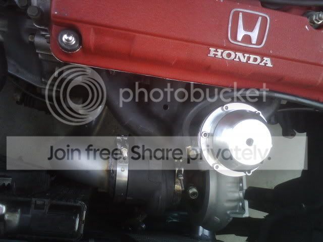

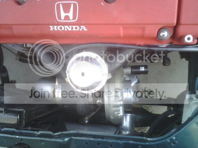

i got mine in but im still waiting on a few things before i can drive it.
here are some pics.
it took some fabing to get it to work. (comp housing is huge !!).
here is as it sits right now

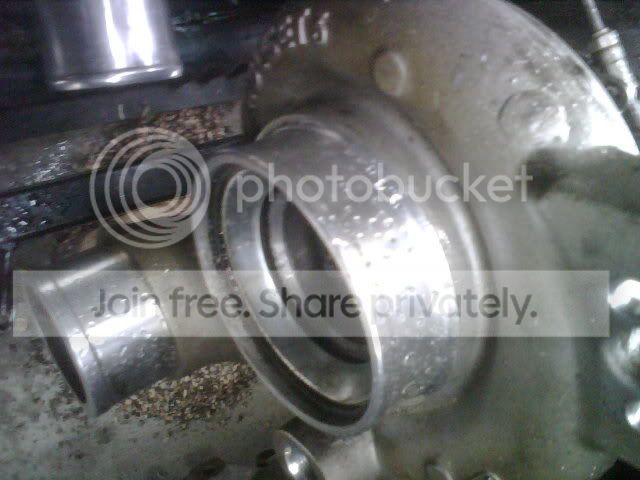

mine didnt come with the elbow so it took some time looking for the v-band flange. local diesel shop has them custom made. ~35bux.
here are some pics.
what about the feed line? i have one of those function 7 restrictors, will that work? do i need to restrict the flow? im using a -3an feed, would that be succifient to just thread that straight in to the turbo?
