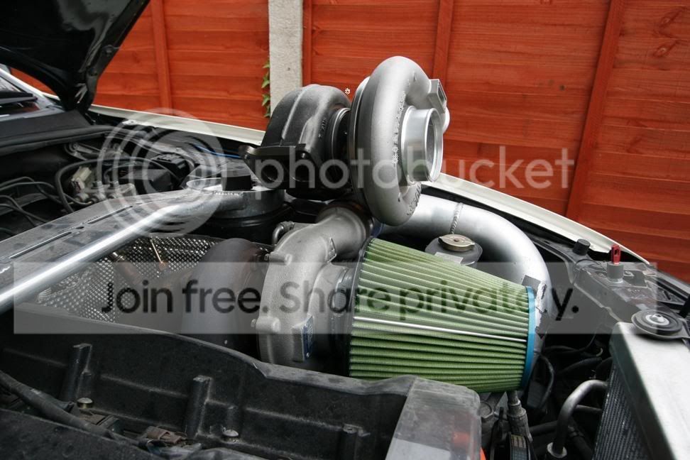

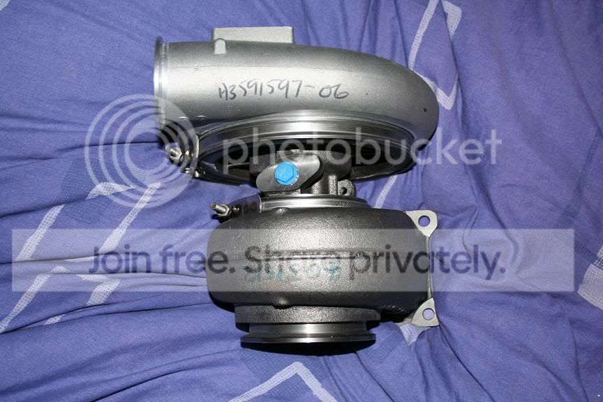

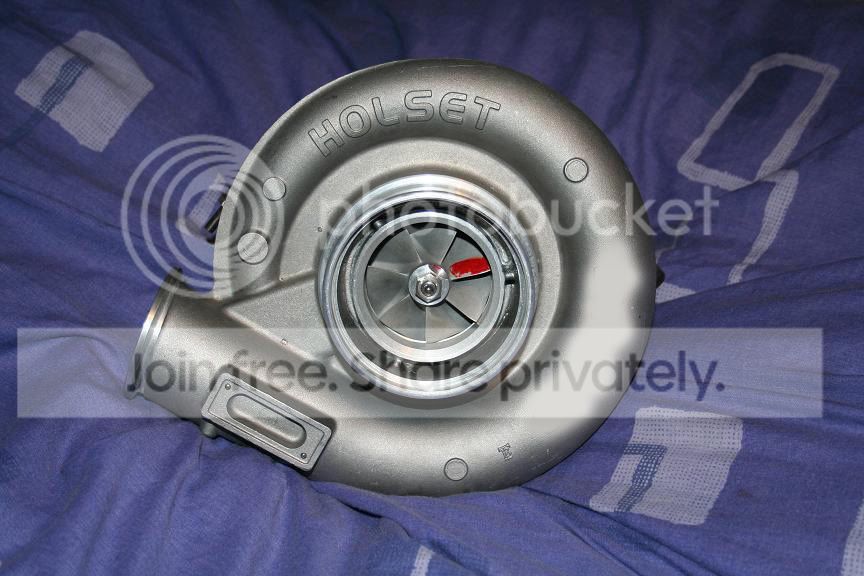

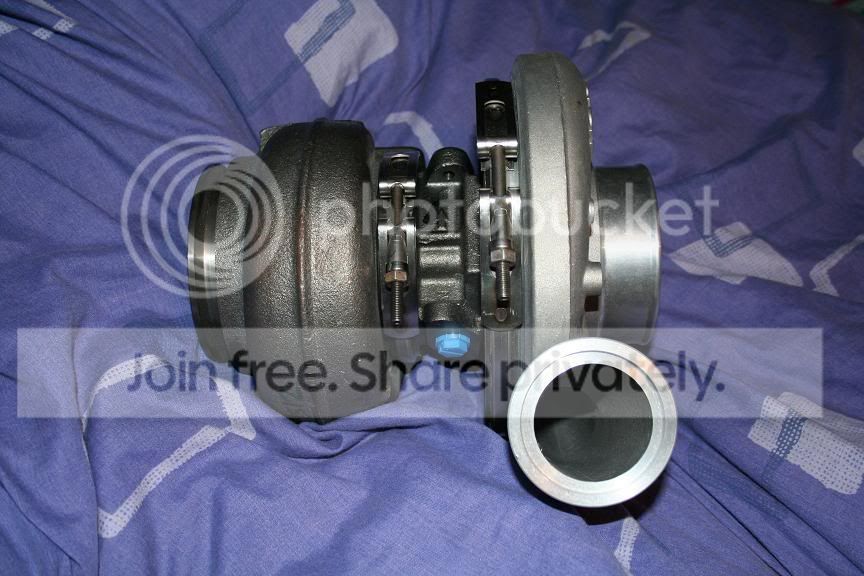

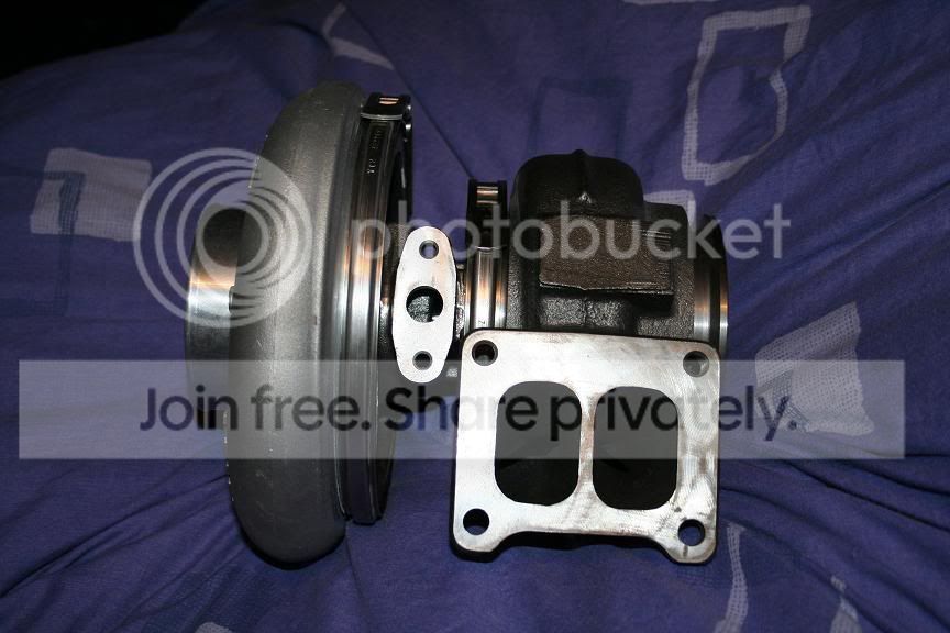

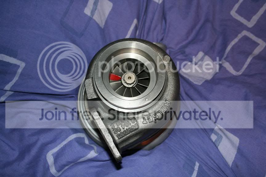

Default Any ideas about my Holset? (pics included)
Best thread ever guys, seriously.
Im from the UK where doing anything out the ordinary is frowned upon, but I love it, and need your help...
I've got a JZX81 Toyota Chaser with a Nissan Skyline GTR RB26DETT engine conversion, and im planning to put this Holset on it, and while im going to give it a go regardless, im curious to find out what Holset it is, how it will spool, power, etc etc...
I measured the wheels and this is what I got...
Compressor-
64.93mm inducer
97.71mm exducer
Turbine-
83.96mm inducer
69.97mm exducer
Housing wise we have...
Compressor-
Very large diameter with 4inch anti-surge inlet
Turbine-
Much smaller compared to the compressor. Divided T4 inlet. "16" embossed in to the exhaust housing near flange. Does that mean a 16cm2 housing?
Part number on the housing is... 3591953.
But a Google search finds nothing with that number, anyone know how to de-cypher it?
Also drawn in marker pen on the comp housing is...
H3591597-06
And on the turbine in marker pen this is drawn...
4037512
No ID tag on it for some reason, looks to have been removed.
Off a Scania engine it seems (says it on the compressor housing! :D
Here are some pics...

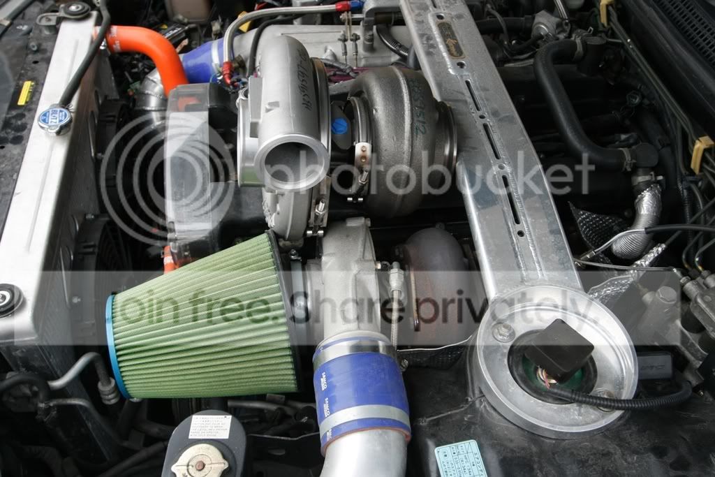

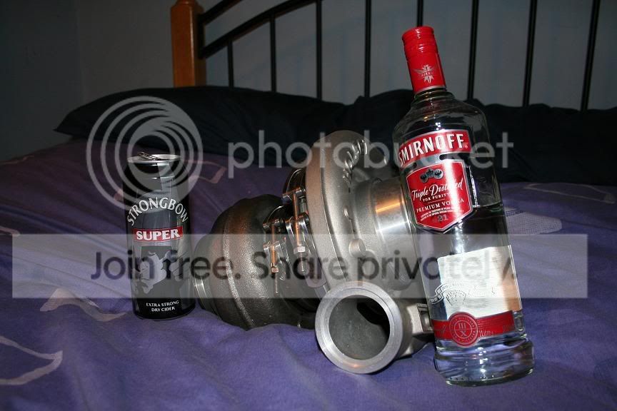

And here is a rough size comparison against a Blitz/KKK turbo that is meant to be good for about 650bhp and certainly spools up nice and quick on a 2.6...
So, any ideas what model of turbo this is?
How it will spool?
What sort of power its good for?
My "guess" is its a HX40, should spool pretty good, and going by comp wheel inducer size its good for about 700bhp.
But I dont know Holset turbos well, so ill leave it to you guys!
Any help MUCH appreciated

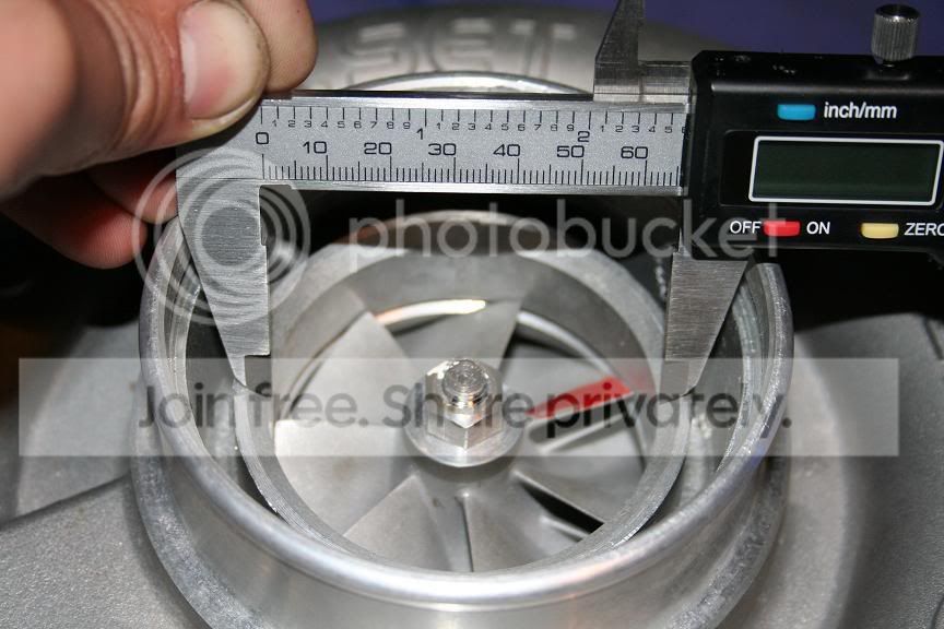

If you can. please take off the compressor cover and measure the inducer at the wheel and not the compressor wheel inlet. I am thinking it is an HX40 but with the 64mm inducer that is alittle large.
Old Feb 20, 2008 | 07:57 AM
  #2246
StavrosRedline's Avatar
Joined: Feb 2008
Posts: 9
Default Re: (TTT)
I did mate, ignore that pic I posted where it looks like I was measuring it with the housings on, its mis-leading, sorry!
The measurments given in the writing before the pics were all done with both housings off.
They had simple v-band clamps holding them on so was easy to remove

Default Re: Any ideas about my Holset? (StavrosRedline)
thats is an HX50 i can't find that exact model in the database i have but i was able to find some that where close that came from a scania and they where all hx50's

HX50 eh? Kind of what I found when looking at Scania too, that they all seem to be HX50
What will the spool be like? 16cm housing so not huge at least.
To me it kind of looks to be the equivalent of a GT40 sort of thing by compressor wheel size, ie around 700bhp.
Will be the first time I've used a Holset on a car, so any interesting info would be appreciated
