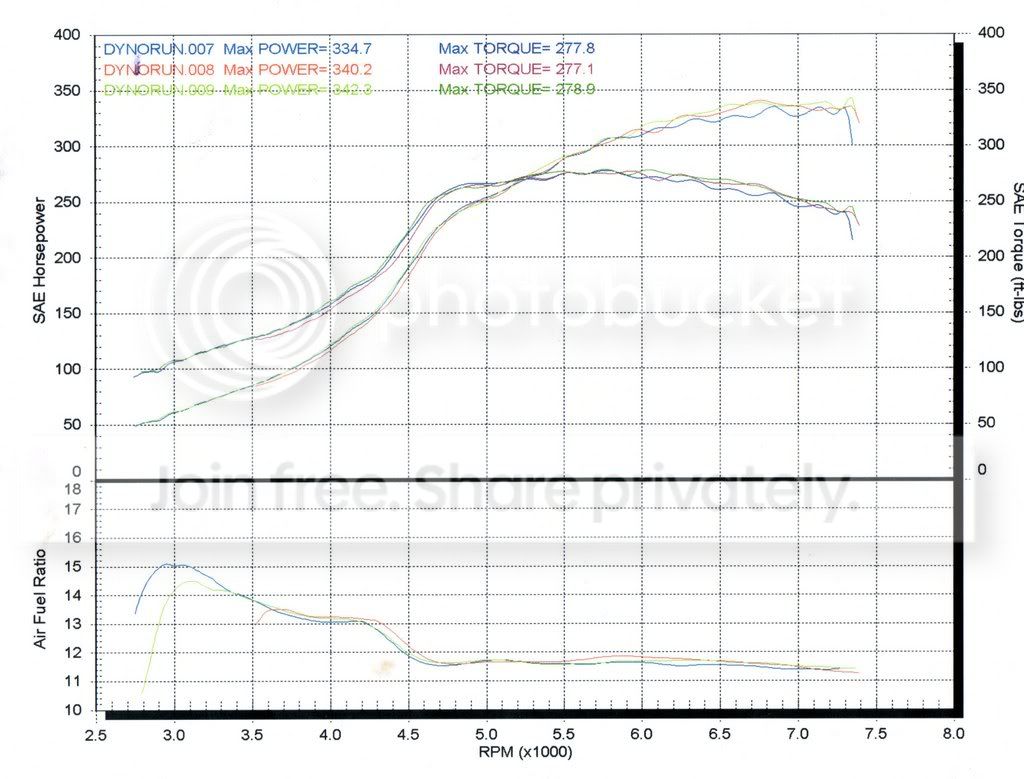

What's the cheaper end of Holset's available that can do 300whp? I don't have much experience with these, and I have a few setups which are more budget oriented but need to make some power.

the cheapest way i could think of getting a holset that is good to 300-400 whp is find a dodge diesel guy and most upprade there turbo and the one that they have left that was stock is a killer turbo here is dyno of one of these turbo's on a 1.8VW20V motor at 20 or 22 psi on pump gas looks like pretty good and cheap turbo to me

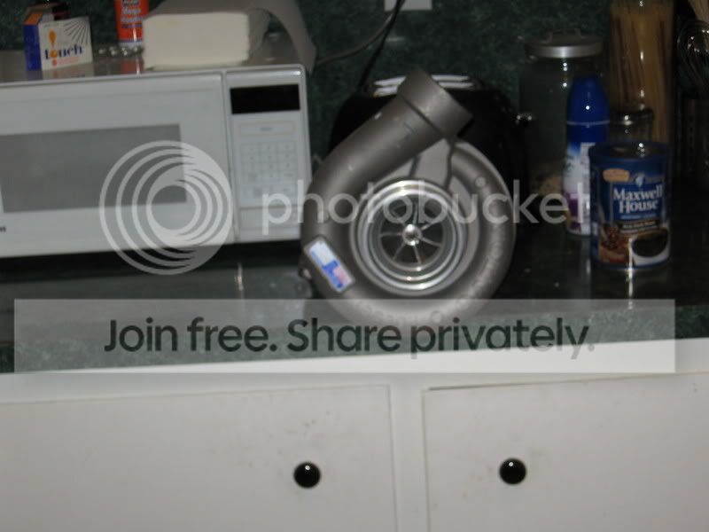

I have a nice new HX52 here check it out billet compressor wheel This is going on a 2JZ i just picked up will see what it makes at 30psi The exh side is a 16cm and the outlet is huge takes a 4.5" roughly Vband clamp but the compressor outlet is 3" which is nice.

looks sick Matt! must say i would have prefered that on a honda. but i guess a 2jz will be ok too
