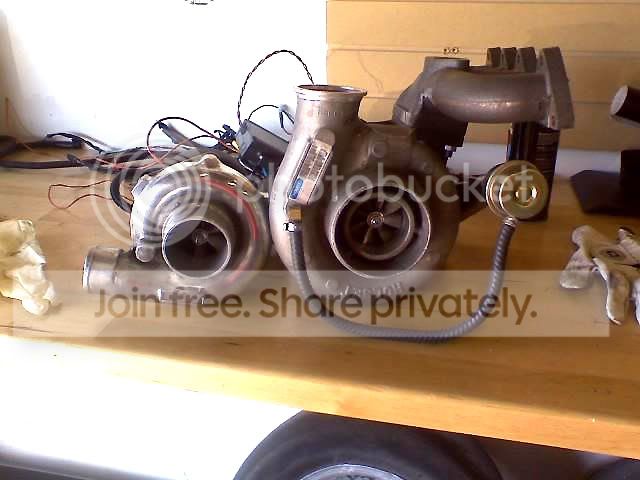

Just picked this up on trade:
Appears IDENTICAL to the one in this EBAY ad HERE
