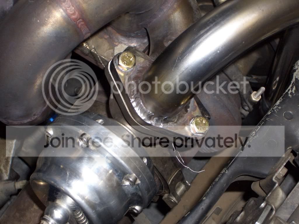

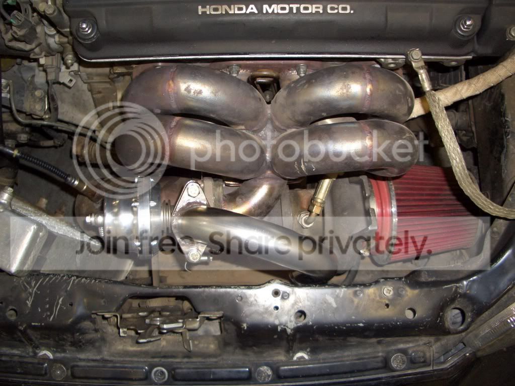

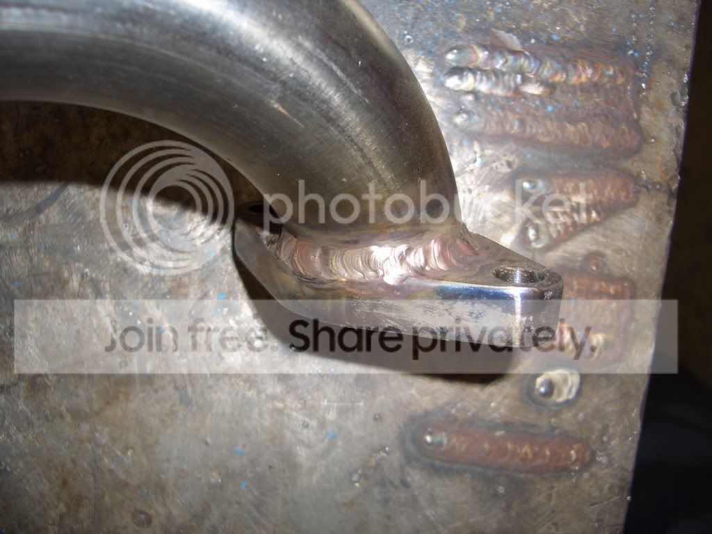

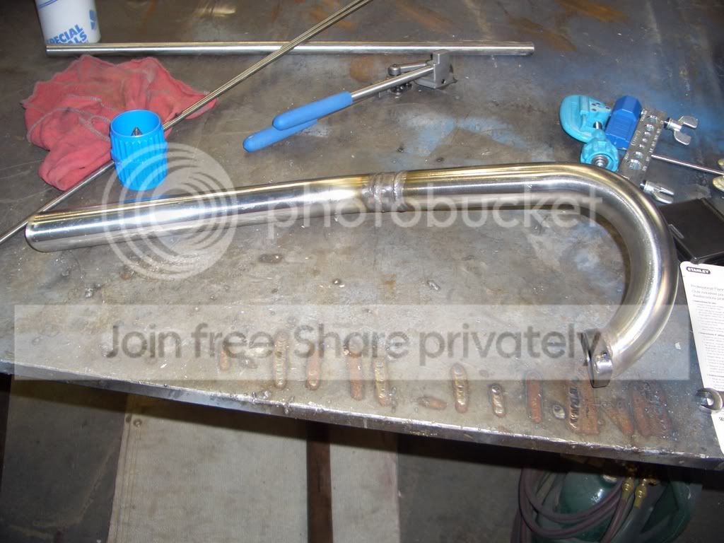

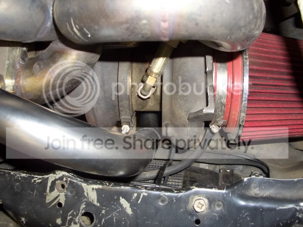

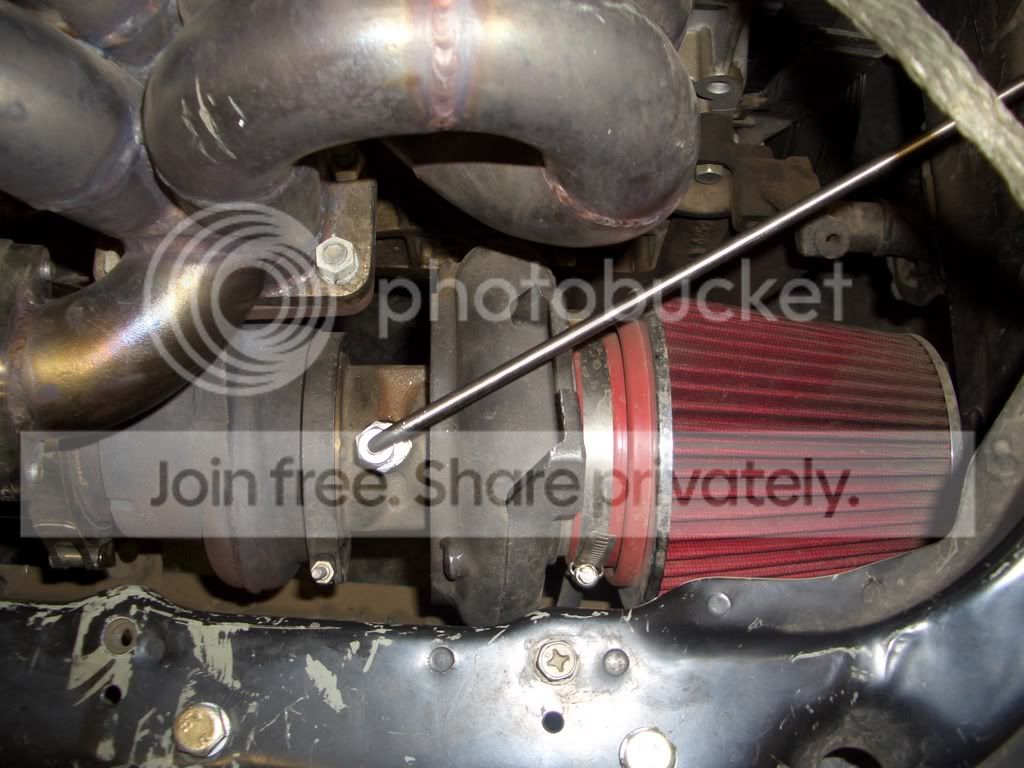

Hey guys just thought I would post up a few upgrades that I made in my bay recently. I recently got an LM-1 and noticed that I was leaning out on top, so I though it might be because my wg was dumping directly in my bay. Then later I found some oil in my charge pipes so I thought I might have to much oil flow as the turbo was fresh when I got it and I haven't been running it that long. I work night shift sometimes so we have some extra time to kill and I decided to make myself a dump tube and a new oil feed line. Here are the picts. No laughing at my welds!!! This is the first time I have ever used a TIG.
Dump Tube.....
Feed Line.....
I know how much shane likes my pictures so I'm whorin' it up for him!!!

That has got to be the sweetest feed line ever.

<TABLE WIDTH="90%" CELLSPACING=0 CELLPADDING=0 ALIGN=CENTER><TR><TD>Quote, originally posted by boostedej1 &raquo;</TD></TR><TR><TD CLASS="quote">That has got to be the sweetest feed line ever.</TD></TR></TABLE>
Thanks man.
It's two pieces because we didn't have a long enough 1/4 single peice of tubing at my work. I figure it will be good if I ever decide to put an orifice in there. I was told I can put a 1/16" orifice and the turbo will be fine. Maybe I'll make another one in one complete piece when we get some more of that ss tubing. Swagelok FTMFW!!!!
