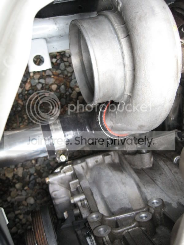

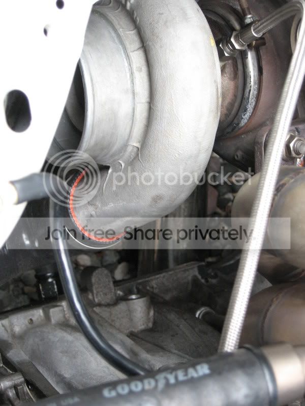

It is not a name brand a custom one but it was not designed for a Holset so it puts the turbo way out from the block which made the downpipe a headache to build.It was designed for a T3/T4 type frame so any off the shelf mani should put the turbo way clear of the block for you.I have literally 6 inches maybe more between the block.

Cool.. Thanks for the pics.
