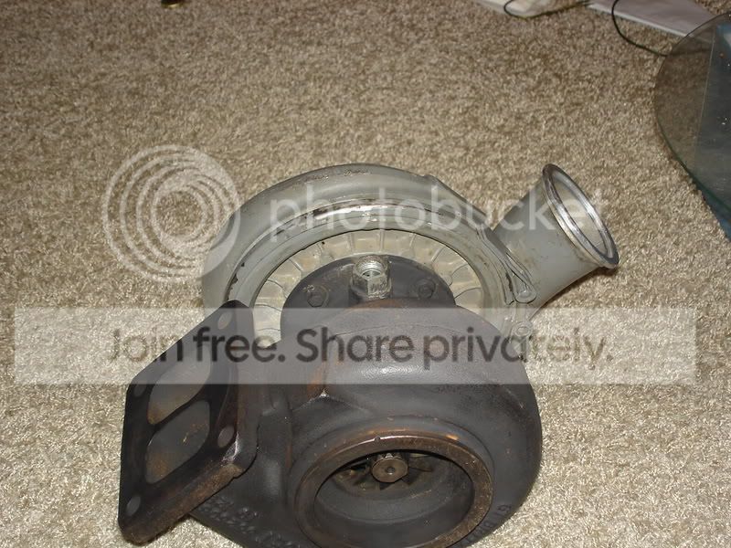

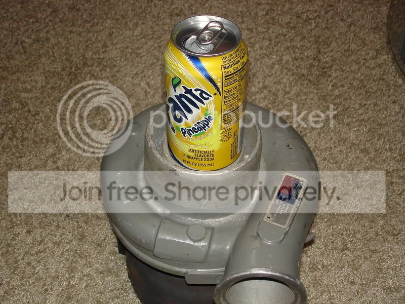

Sup guys,
I wanted to join your oh so secret cult (

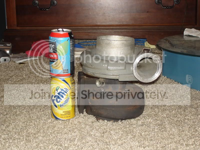

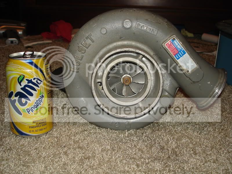

), so i picked up one of these bad boys. Holset H1E. Hopefully, it'll be going in my Vigor (2.5L for those who don't know). I have a complete engine that i'm going to be rebuilding before dropping this bad boy on. I won the bid last night and i'll be picking it up tonite. I'll take some pictures tonite after i pick it up. Has a couple of problems, but should be fine after i take care of them.
<TABLE WIDTH="90%" CELLSPACING=0 CELLPADDING=0 ALIGN=CENTER><TR><TD>Quote, originally posted by paul vang »</TD></TR><TR><TD CLASS="quote">If you guys need anything holset, let me know. I can hook you guys up with whole turbos down to separate wheels or flanges</TD></TR></TABLE>
I will definately need to be talking to you. The seller stated that this turbo will need a compressor wheel and a rebuild kit. I'd much rather try and put some money in a fellow tuner's hands than hit the store. Also, he stated that he thinks the exhaust housing might be 19cm...and i believe that might be a little too big even for my motor. I'll probably look into maybe a 14cm or 16cm. What do you guys think?
), so i picked up one of these bad boys. Holset H1E. Hopefully, it'll be going in my Vigor (2.5L for those who don't know). I have a complete engine that i'm going to be rebuilding before dropping this bad boy on. I won the bid last night and i'll be picking it up tonite. I'll take some pictures tonite after i pick it up. Has a couple of problems, but should be fine after i take care of them.<TABLE WIDTH="90%" CELLSPACING=0 CELLPADDING=0 ALIGN=CENTER><TR><TD>Quote, originally posted by paul vang »</TD></TR><TR><TD CLASS="quote">If you guys need anything holset, let me know. I can hook you guys up with whole turbos down to separate wheels or flanges</TD></TR></TABLE>

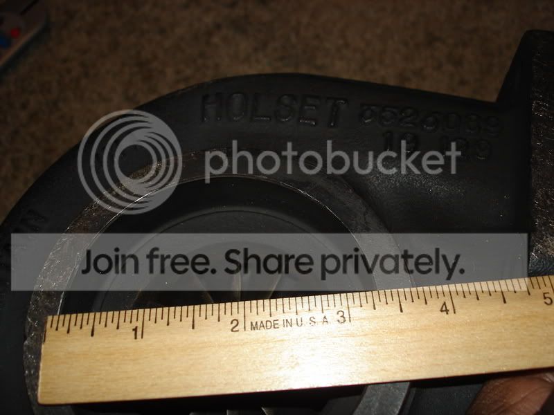

is my assumption correct that the 19 stamped on the exhaust housing means that it is 19cm? if so, do you think that is too big for my 2.5L to spool?
by the time i'm ready to put this bad boy in, it'll be all taken care of.

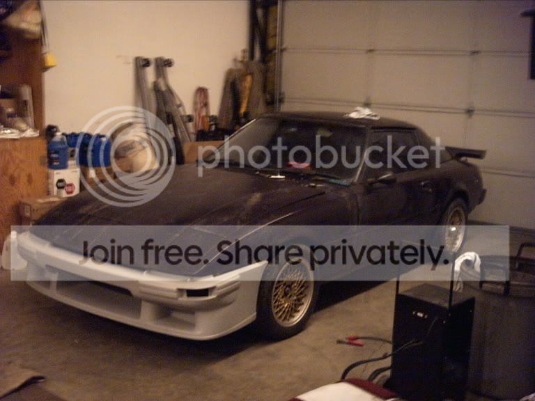

I have a holset turbo setup... its not a honda though... I have a 78 RHD rx7 with a cosmo 13b in it with a tec 2 ems and a BIG *** holeset turbo... Just another project I never got finished... had it running a few times but never got everything worked out on it...

<TABLE WIDTH="90%" CELLSPACING=0 CELLPADDING=0 ALIGN=CENTER><TR><TD>Quote, originally posted by j-spec_cc2 »</TD></TR><TR><TD CLASS="quote">
is my assumption correct that the 19 stamped on the exhaust housing means that it is 19cm^2? if so, do you think that is too big for my 2.5L to spool?</TD></TR></TABLE>
