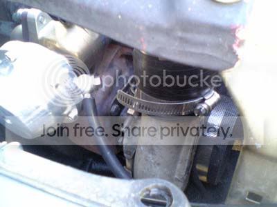

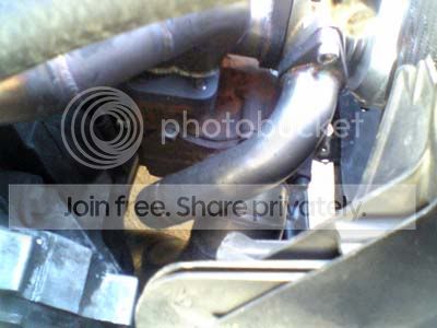

i have a holset turbo but the compressor side looks kinda small here are the number on the exhuast housing 3521934-02 and under the numbers it has E4 16 what kinda holset is this...on the compressor side it 2 3/4 inch inlet

here some pics of the turbo is this a **** turbo or not cause i want to boost

<TABLE WIDTH="90%" CELLSPACING=0 CELLPADDING=0 ALIGN=CENTER><TR><TD>Quote, originally posted by stockb18c &raquo;</TD></TR><TR><TD CLASS="quote">here some pics of the turbo is this a **** turbo or not cause i want to boost
Looks like a holset h1c with a 16cm^2 exhaust housing. if i remember correctly thats equiv to like an .82 ar

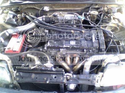

whats your setup? you should see way befor 6 but if you get the bullseye housing you knock it down to around 4-5000 if not lower

its a stock ls with a WH1C...i think the housing might actually be a 12cm one not really sure...is there any way i can tell? it has a divided inlet t3 flange...there's some numbers on the housing if that means anything...my bro said he saw a 14something on there but couldn't find it myself with it cramped in the engine bay...here's a pic of the set up
