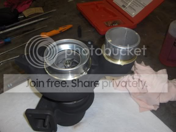

Ok, just coated my hy35.........and it looks like ****! J/k I think it turned out pretty good. Lemme know what you think.
Started out looking like this....
and this.......
Took it apart......
Picts of it dirty.........
Picts of it bead blasted......
Picts of it coated.......
Picts of it complete.....
Old Oct 4, 2005 | 06:23 AM

looking SOOOOO GOOD!
nice man. paint, or something else?

HTV header coating. It is supposed to be baked on or heat cycled while on your car. I baked it in our rod oven here at work, lol. Three stage bake, first 250 deg F, then 400 deg F and lastly 600 deg F (though I only did this one @ 550 because the rod oven couldn't go any higher. Did all of this last night @ work.

that looks really good mang

Thanks. It turned out just how I wanted. I am not one for flashy stuff on my car. Its just a black 95 coupe on black rota slipstream (I know, I know, old *** rims), was thinking of getting the black gab replicas, but would rather spend the money to make my **** fast. I'm having my ic anodized black as we speak. Function over form, but I do like the stealth look. I think subconsciously I am just a knight rider wannabee, oh well. My ride = No stickers, no wing (but I am a sucker for a nice type r or mugen lip), no chrome, no big *** tach. Dunno, just my wierd taste.

KeyserSoze: in your pics after you coated it. is that a retaining ring tool in the top left corner? if it is where did you get it.?

Yeah, that's the tool I used. I think it's a craftsman. It is from my work, I'll find out for sure when I'm back on shift. They prolly got it from mcmaster or grainger, we have accounts with both of them.
