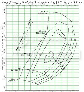

lets put it this way.. ive seen an hx35 comp. map, you can fit an entire t04b map inside the 75% island of the holset

<TABLE WIDTH="90%" CELLSPACING=0 CELLPADDING=0 ALIGN=CENTER><TR><TD>Quote, originally posted by KeyserSoze &raquo;</TD></TR><TR><TD CLASS="quote">
What eff % is that island akin to??
It looks like at a pr of 2 (15psi) which is what I will be running this thing flows up to ~52lb/min! ~43lb/min max @ pr = 1.68!
The 'island' is the outermost edge of the map, with an efficiency of say 60%. I have the rest, but I won't be posting them. The 70% island covers around 1/3 to 1/2 of that map.

<TABLE WIDTH="90%" CELLSPACING=0 CELLPADDING=0 ALIGN=CENTER><TR><TD>Quote, originally posted by _Morphius_ &raquo;</TD></TR><TR><TD CLASS="quote">
The 'island' is the outermost edge of the map, with an efficiency of say 60%. I have the rest, but I won't be posting them. The 70% island covers around 1/3 to 1/2 of that map.</TD></TR></TABLE>
Well, I just got the hy35 map and I'm not sharing either!!! LOL, jk. Here it is.
It's all about sharing the wealth guys.
I have a couple of other pdf's that the holset engineer sent me let me know if anyone wants a copy.

told you it was huge
