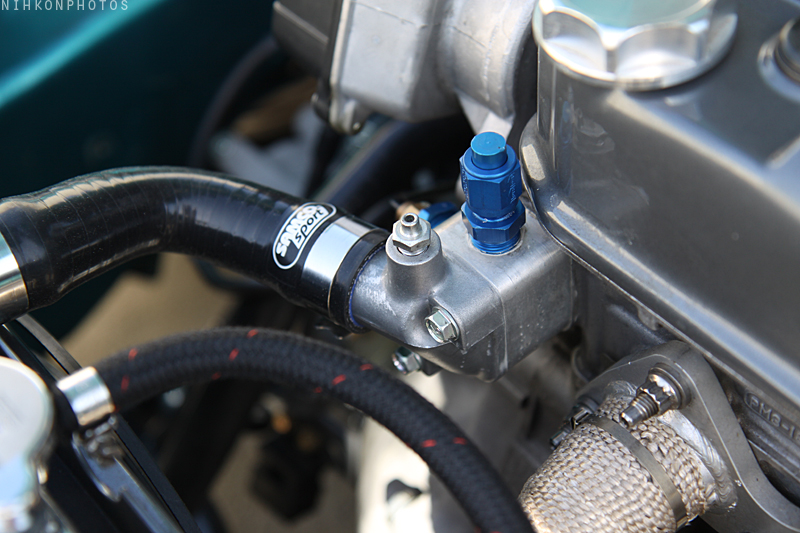

Add me to the list of "no issues" with rollbar/seat/harness on the streets. Been running that setup in my daily driver CRX's for 9+ years. Only pulled over twice during "click-it or ticket" campaigns. As soon as they saw the harness they turned and went back to their cruiser.
Originally Posted by B16CRXT
Anyone have suggestions for longer intake manifold studs besides ARP? Their **** is way too expensive. I thought the $25 I was gonna spend in the hardware store was too much(theirs wasn't exactly what I needed)!!
This is for a set of 4. I really need 10 but that thing is $80!
http://www.race-mart.com/ARP-400-8003.html
I need them unequal like that with a size of M8 X 1.25 X45mm long. Thanks if any of you have online ideas!
I'm running those ARP studs for my exhaust manifold. That's some nice quality hardware right there!
For the intake manifold I'm running extended studs as well, but not the ARP ones. I think I got them at KingMotorsports. http://www.kingmotorsports.com/p-619...old-studs.aspx
I think you can also get those same studs at McMaster-Carr. It can kind of a pain to find stuff there though.
You can kinda see the ARP studs I used here:
