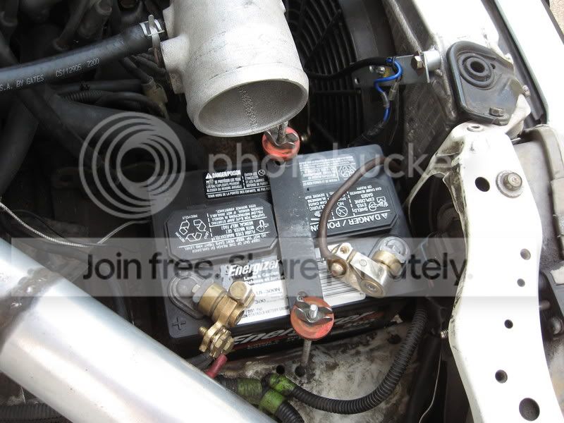

We have a place called Batteries Plus locally that sells the pc680, but they wanted like $125 for it, so I just bought it from summit and the aluminum battery tray. I didnt mount mine in the fender like I had planned, because it didnt seem I could since the surface wasnt flat enough without a LOT of modification/welding. I'm trying to find a way to use it in my trunk or creating a type of battery tray that will stand the battery up in the cargo area that I can bolt down. If you do buy some other battery, make sure its a dry cell if you move it inside the car.

there is a open hole in the frame rail I welded a 12mm nut in it and built the tray around the bumper support bolt and that one....you can move the car around by the tray
