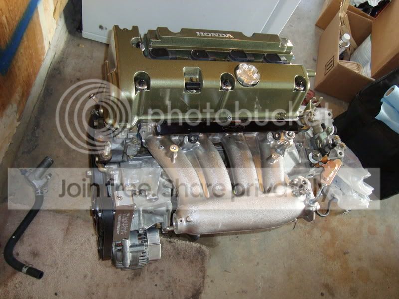

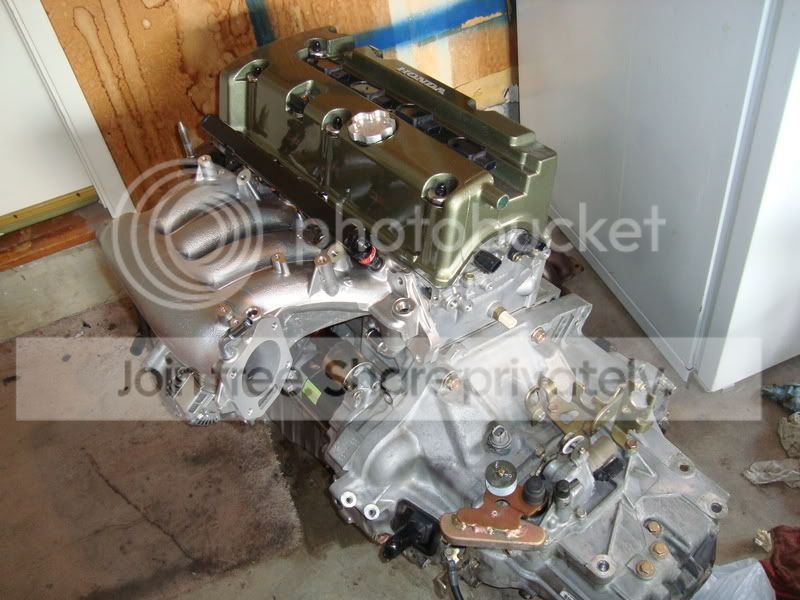

Here is the intake mani and valve cover color matched to exterior... It looks amazing in sunlight, but all I have is a dark garage...
