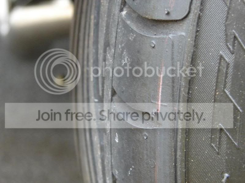

You can see the red paint mark on the tire
