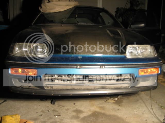

From: Normal, Illinois
Default Re: (gospeedgo1)
I like that cf zc hood. I don't know of anyone that makes one for a sedan though.
