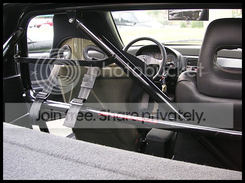

After your close up shot I see that is not meant for the harness. I know the angle can not be too steep with the harness or your spine can get compressed in an accident. I would probably attach the front harnesses to the rear seat belt bolts
Old Dec 21, 2006 | 11:00 AM
  #10502
civicandy's Avatar
Posts: 4,562
From: Madison, WI, USA
Default Re: (nihkon)
<TABLE WIDTH="90%" CELLSPACING=0 CELLPADDING=0 ALIGN=CENTER><TR><TD>Quote, originally posted by nihkon &raquo;</TD></TR><TR><TD CLASS="quote">I'm pretty sure that the thinner flat bar is a helmet restraint.
How so? The seat would be higher than that bar anyway. Maybe it's in case you have a reclining seat, so you don't recline too far back and risk getting your head to close to the bar (if you're not wearing a helmet)
Old Dec 21, 2006 | 11:11 AM
  #10503
xDicktonesx's Avatar
Posts: 6,291
From: Hessian Aggression
its a secondary "hold your seat in place" device in case your sliders are shitty when you get rear ended.
youre both right kinda, i guess.

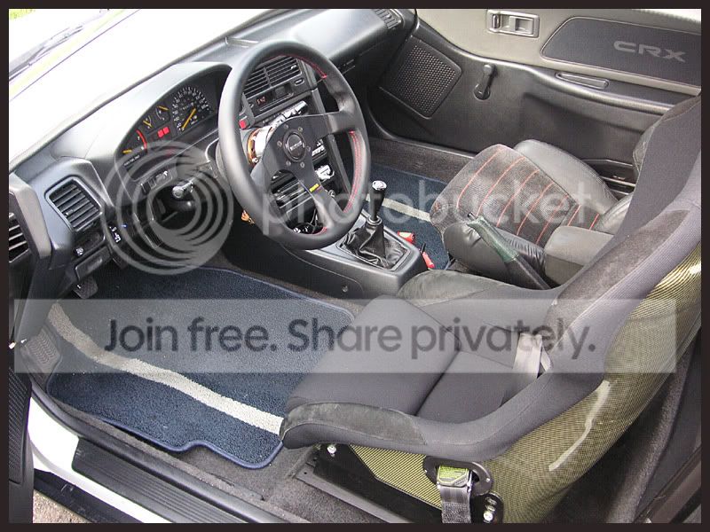

Since we're talking about roll bars, I'll post some old pics of mine.
^ i love your car, its so hot. theres my insperation
Old Dec 21, 2006 | 11:57 AM
  #10511
Posts: 6,291
Default Re: (pandarex)
that is a nice set up. i have to pick up anotehr set of the leather bolster si-r seats. i regret lettign mine go. they have a good home in brad's crx.

Funny it says race, but it there is no harness bar. I noticed in your crx your harness has a steep angle from the seat back to the harness bar.

Thanks guys. Yeah, in my opinion, those are just about the best oem seats you can put in an EF. They do look good in Brad's CRX. I remember seeing them in his car at CRXpo in San Diego. I had just installed mine around that time.

<TABLE WIDTH="90%" CELLSPACING=0 CELLPADDING=0 ALIGN=CENTER><TR><TD>Quote, originally posted by civicandy &raquo;</TD></TR><TR><TD CLASS="quote">Funny it says race, but it there is no harness bar. I noticed in your crx your harness has a steep angle from the seat back to the harness bar.</TD></TR></TABLE>
The harness bar is an option.
Regarding the harness angle. . .You are correct. And that is exactly the reason why I'm having the harness bar modified.

you can mount the drivers-side harness to that little flat cross-bar vega has his mounted too...thats what their for

The flat bar looks like it would bend if you crashed. I've been meaning to check with autopower on this. I can see why you are moving your bar up. I think my seat is low enough it would work they way yours is

<TABLE WIDTH="90%" CELLSPACING=0 CELLPADDING=0 ALIGN=CENTER><TR><TD>Quote, originally posted by Stefndogg &raquo;</TD></TR><TR><TD CLASS="quote">you can mount the drivers-side harness to that little flat cross-bar vega has his mounted too...thats what their for </TD></TR></TABLE>
im sorry man i hate to say it but that is wrong. especially if you have a sparco seat. the correct postion is about 18 inches below that which equates to about a 40 degree angle to your shoulder.
jesus ***** christ, why do we do nothing but argue about cages here?
im going to write a rap song about mastershake and his brown dash 4 speed. thats more contructive.

thanks for the info you guys. I thought it was for harness. Now the question is now, is the lil bar strong enough to support a harness in case of a accident??
is the angle the issue or is the integrity of the bar the issue

<TABLE WIDTH="90%" CELLSPACING=0 CELLPADDING=0 ALIGN=CENTER><TR><TD>Quote, originally posted by vega_box &raquo;</TD></TR><TR><TD CLASS="quote">"Race" EF bar for sale
is the angle the issue or is the integrity of the bar the issue</TD></TR></TABLE>
its plenty strong. its the angle in relation to your SHOULDERS. close your eyes and picture your self being rear ended in an automotive, non-****** type manner.
there is nothing to keep you from flying forward if the belt is almost parrallel or, at a 0degree/180degree angle from your shoulders.
your honestly better off adjusting your harness to reach the floor of your car, right about where your back seat is, if your back seat wasnt there, drilling a couple holes and fastening them there.
coem to think of it, its almost impossible to properly mount a 4/5 pt harness with a back seat in your car.

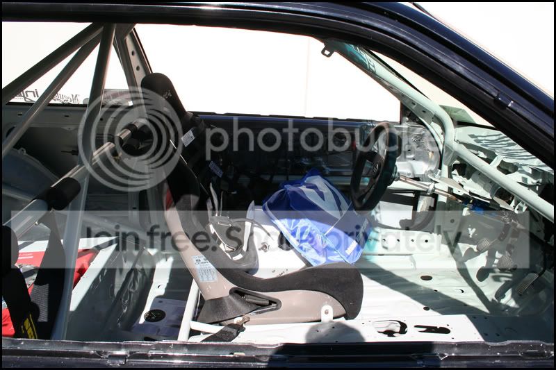

Since we're digging into the archives, you guys should post any pics you have of EF interiors with full cages. I think the only pic I have is the white hatch with the zc style front, J's wing, and low offset wheels.
coem to think of it, its almost impossible to properly mount a 4/5 pt harness with a back seat in your car.</TD></TR></TABLE>
minus the gay comment thanks
I get it now. So with that being said, my fake "harness bar" can be used only as an adjustment if I mount in the rear??
Thats the only reason I have been trying to hold on to atleast one of my harnesses but if its totally pointless then I might as well sell the ******* to someone who has a cr-x
