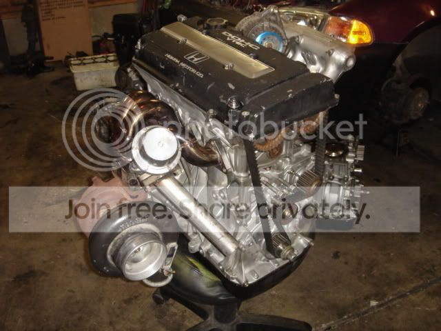

update:
new radiator and heat shield to keep everything cool. and yep..... that sticker melted shortly after turning it on.
H1C, TTT turbine housing, built Z6 yada yada

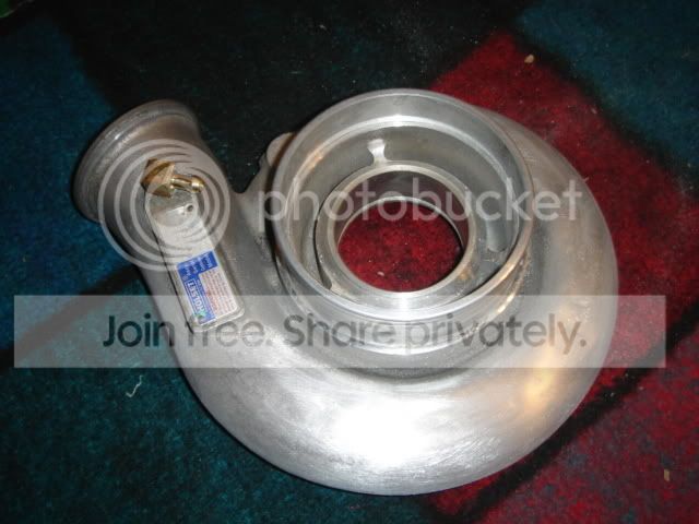

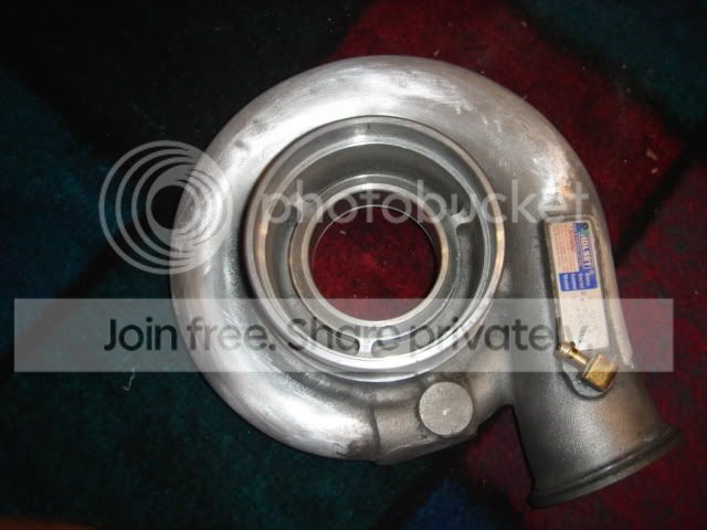

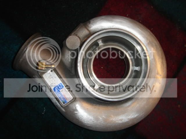

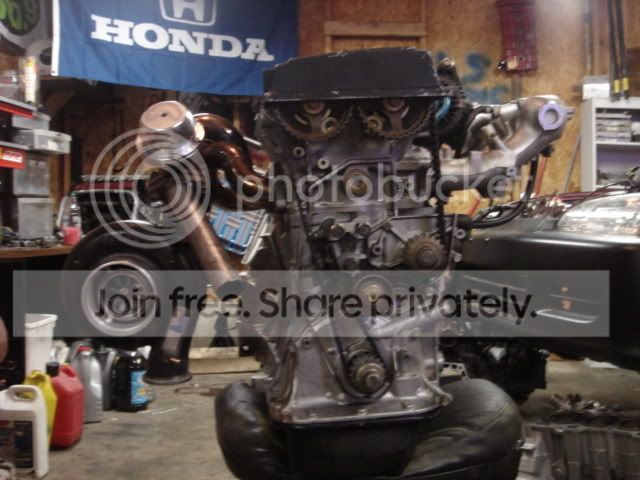

Decided that since i got a week or two before i bolt my HX35 on, that id do some cleanin up on it. Let me know what ya think.
Before:
and after about 2 hours of work so far:
Old Aug 27, 2007 | 03:38 AM
  #1897
gokhan's Avatar
Posts: 23
From: Istanbul, Tukiye
Default Re: (sq_creations) (a1320honda)
nice job
