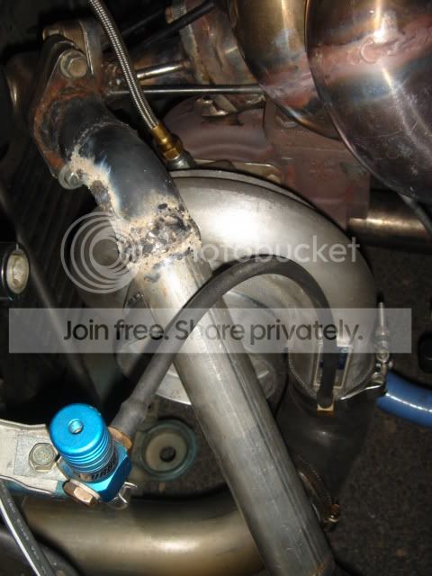

16cm 10psi at 4300vtec at 4500 in first. boost comes on smooth as expletive and rips like a monster to 9500

Wow I am surprised this post is still running strong I am currently almost fully underway on my project and the car is almost done. Currently I am running a holset H1C on a B20A in an 89 Honda prelude, the cylinder head is fully ported and I am currently running a 3 pound spring in my wastegate. I currently am still trying to hook-up my electronics and swap out my burnt up clutch. All I can say is this turbo does have quite a bit of lag compared to my t3 super 60 but wow all I have to say is this. In first gear the car really wakes up around 3200 and then when I hit second it just blows the clutch away. All I have to say is this keep your holsets running this is by far the best bang for the buck junkyard turbo in my opinion.

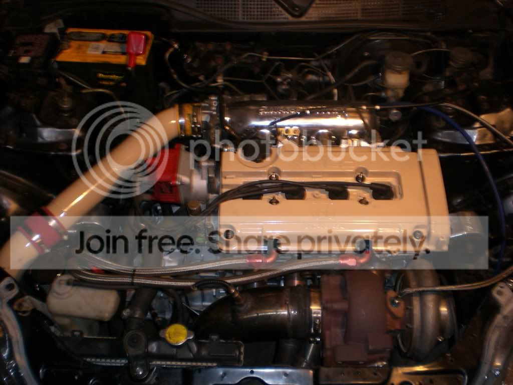

Well i just got mine on, it took a little work. Mines the HX35 with the 16cm housing on a B20B at 10psi. Its a little laggier than the 57 trim but when it comes in, it definatly feels much more solid.
I had to move the fan to the front and reverse its polarity to push, but it enabled me to use the V-Band on the exhaust.
