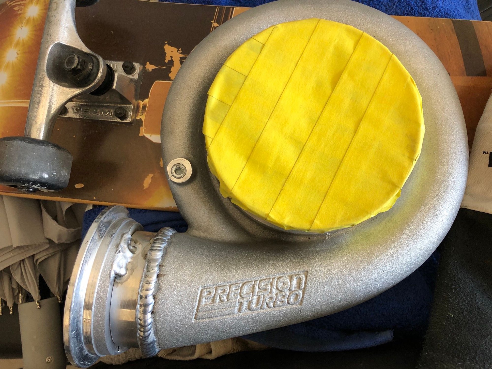

So when I bought the Precision 7285 I thought I was going to have to modify a bunch of things. I got the turbo mounted up and the up pipe fits, oil lines, return lines all work. The only thing that will need to be modified is the compressor housing since this one had been modified before.
Once I get it modified I will be ready to go back out and see what this can do.

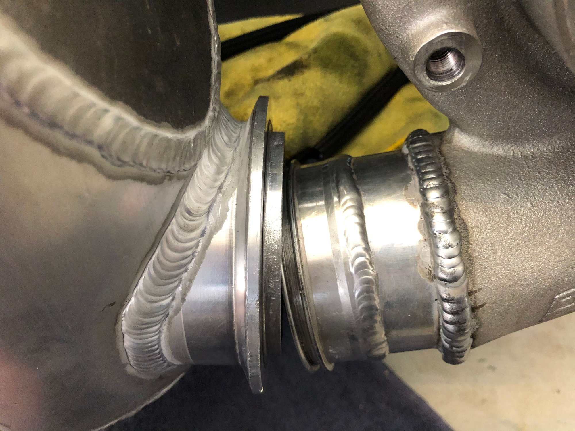

I fricken hate welding cast to tubing.
Which is why I am having my buddy John from Future Fabrication handle that LOL. That guy is a bad *** fabricator and this will be easy for him to handle, I would spend more time screwing up than just letting him do it.

It's not really different, it's just a pain with how the casting is always dirty with inclusions that pop out. You could get the job done just fine, comparing your baffled box welds.
My biggest problem with this particular task is that the particular male adapter piece you see on the intercooler can be purchased the female piece cannot be purchased so I have to cut that off the Comp Turbo housing. I don't want to take a chance and screw something up.
I also have issues with figuring out the right amperage to use for certain thicknesses, good fabricators look at it and know exactly what to do, with me I have to sit there and play around awhile until I get it.
Let's just say I need more practice especially with aluminum, I've been messing around with stainless steel and that is much easier for me. I also need more practice on round objects.

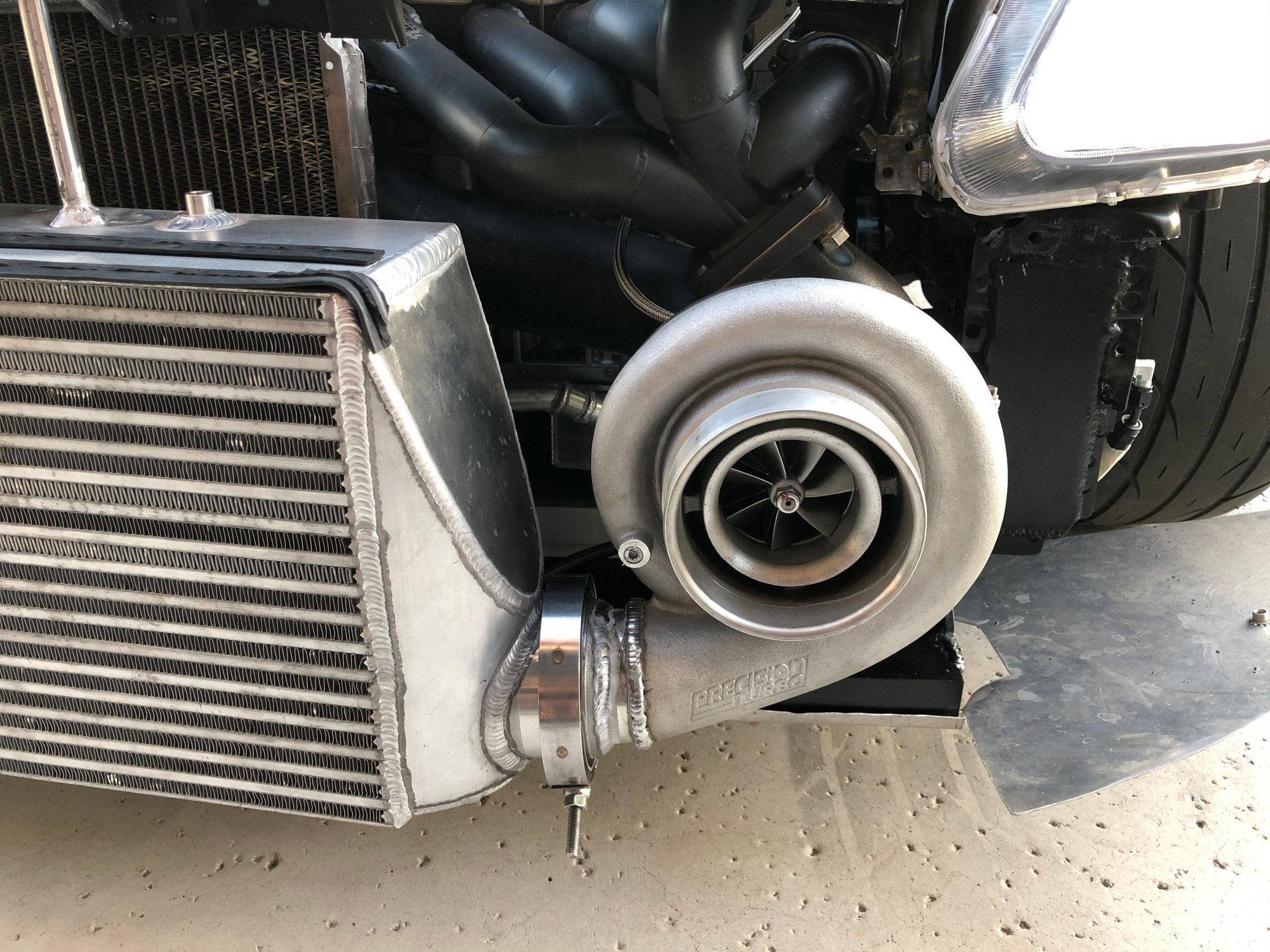

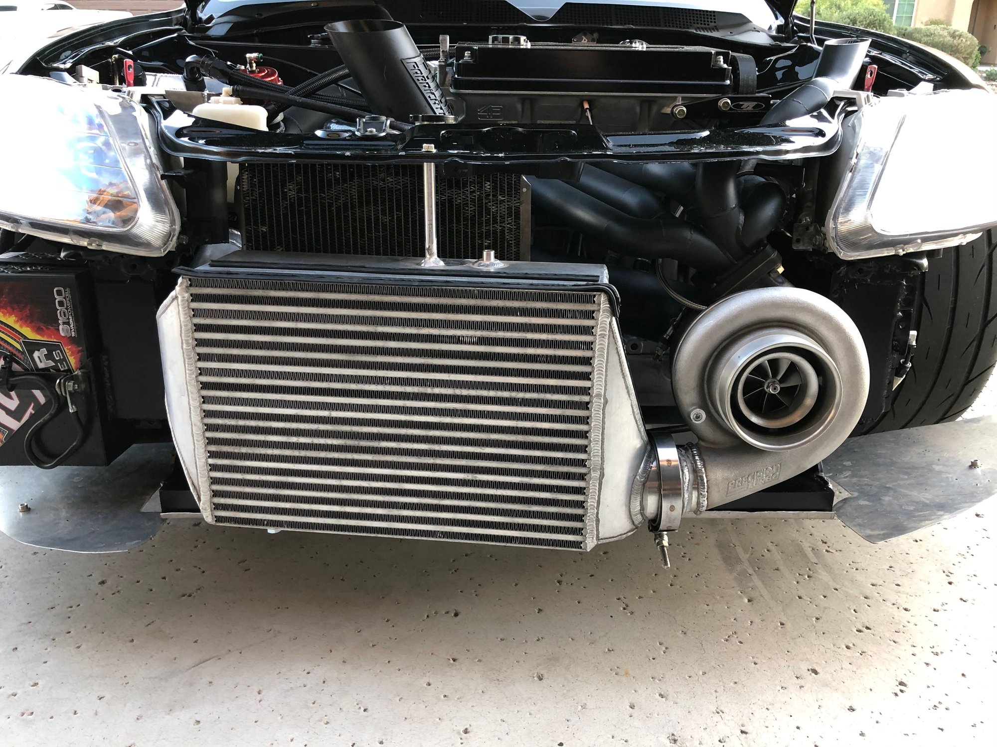

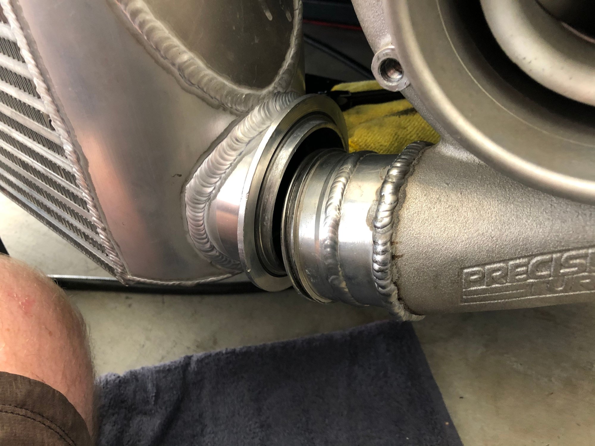

Well the car is up and running, I was able to cut the fitting off the Comp and reuse it for the precision. I had to shift the intercooler back about 1 inch and raise it up a little, so do do this I had to make new tabs for the intercooler.
got everything tacked and fitted and then my buddy did the final weld on the housing inside and out. Got home put everything together for a final time and fired it up.

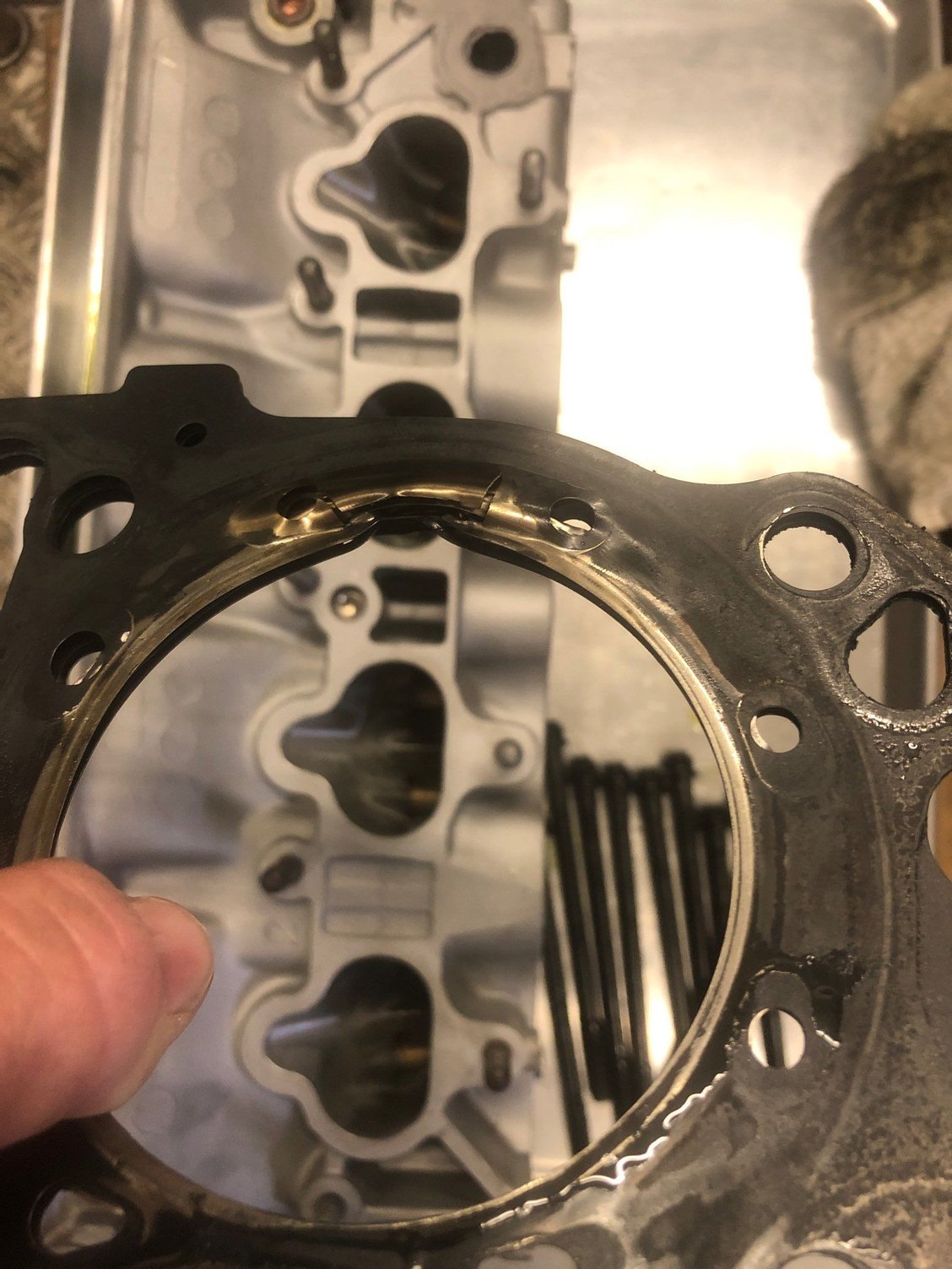

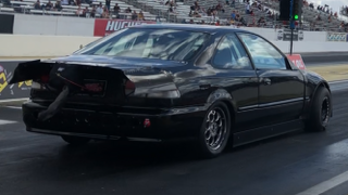

So Sunday was IFO, pretty damn hot that day first of all LOL. Second we has some fast cars including both of Speedfactorys cars, the FWD Outlaw and the AWD car.
So from the get go I was having issues, first pass was breaking up like crazy. Checked the logs and the secondary injectors were running lean, so Joe thought maybe they could be clogged and decided to setup to run on all primaries. Second pass was the same thing, so swapped ECU's with another M800 box and Joe messed around and thought everything was good but next pass same thing.
The only good thing was I made it to the finals for FIP to race Speedfactory's AWD car, which ran an 8.0 but I didn't make it because of a blown headgasket which was the cause of my issues. So I got runner up LOL, the car actually was 60ft with a 1.51 and getting better. This Precision is a bad mother.
I already pulled the motor and the motor is apart with the head gasket as you can see below. So, not sure why the head gasket blew and this is the JE Pro Seal. Anyway, I did buy Speedfactory L19 head studs and am moving my radiator to the rear of the car. I will get pictures of how I am going to do this but we now a couple California guys doing this that never see over 170 degrees.
