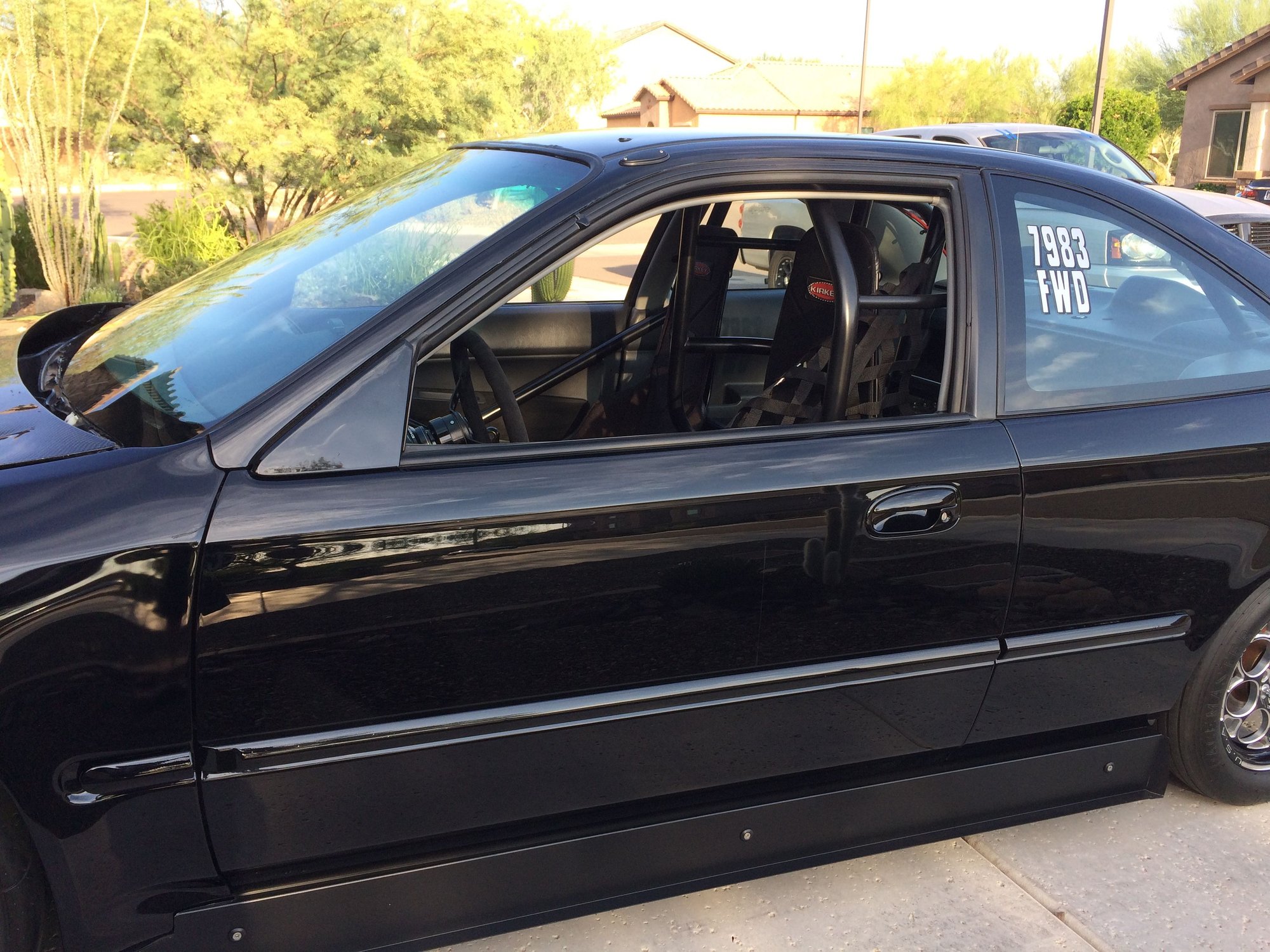

Just some updates: Got the interior all back together, finished everything up with the body. Now just waiting to get the cage 7.5 certified and then motor will start to make its way back in.
Old Aug 15, 2018 | 06:07 PM
turboLScrx's Avatar
25 Year Member
Loved
Community Favorite
Joined: Mar 2001
Posts: 1,859
Likes: 591
From: Bowling Green, ky, USA
Default Re: AZ_CIVIC'S Build, Testing Things, ETC.
Incredible build man, extremely impressive, I can tell you have put your heart and soul into this car
Old Aug 16, 2018 | 12:11 AM
extremeracer's Avatar
Joined: Jul 2008
Posts: 540
Likes: 17
From: Johannesburg, Gauteng, South Africa
Beautiful car - but then I'm a black car fan. I've always thought Black suited the EG and EK's
Old Aug 16, 2018 | 12:41 PM
AZ_CIVIC's Avatar
Joined: Mar 2010
Posts: 2,503
Likes: 375
From: Phoenix
