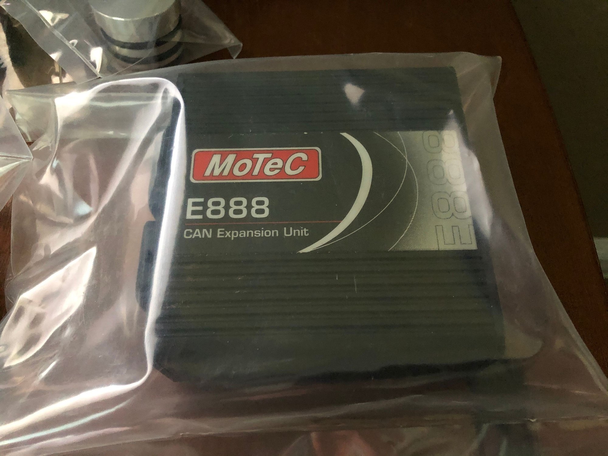

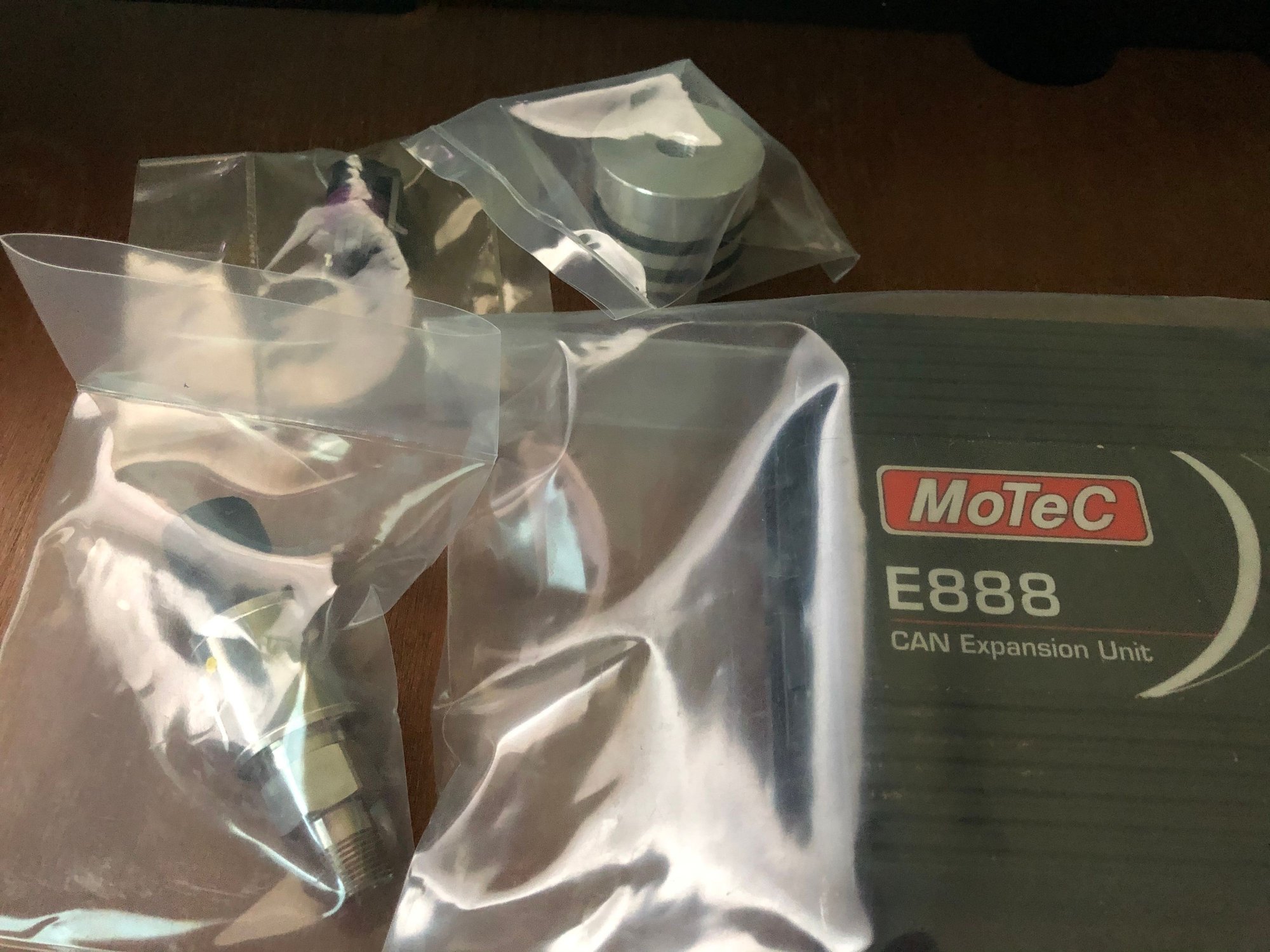

Got a couple little things, purchased a Motec E888 expansion unit that will allow me to add additional inputs. Also got another sensor that I will be using to monitor crankcase pressure. I may add an intercooler temperature sensor as well.

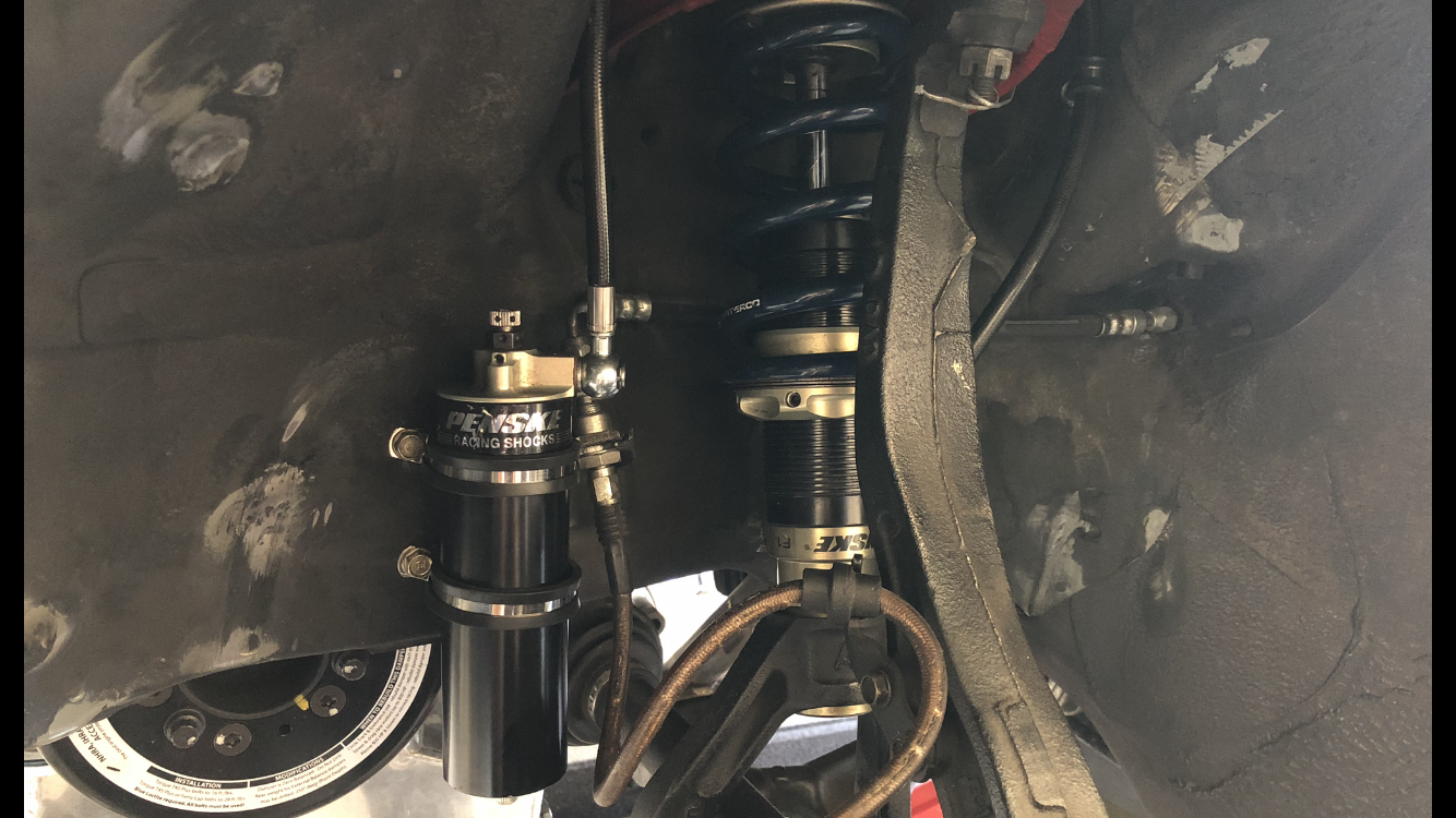

Got the sensor added and finished installing the Penske’s.
What we do on sensors like that is get a small section of braided line and let it hang a bit or zip tie it somewhere.
In this spot i would add about 4 inches of line with a 90 and add a bolt and spacer and zip tie it to that.
Those sensors are too expensive to chance it breaking. (If it is an aem or similar 150 dollar sensor)
