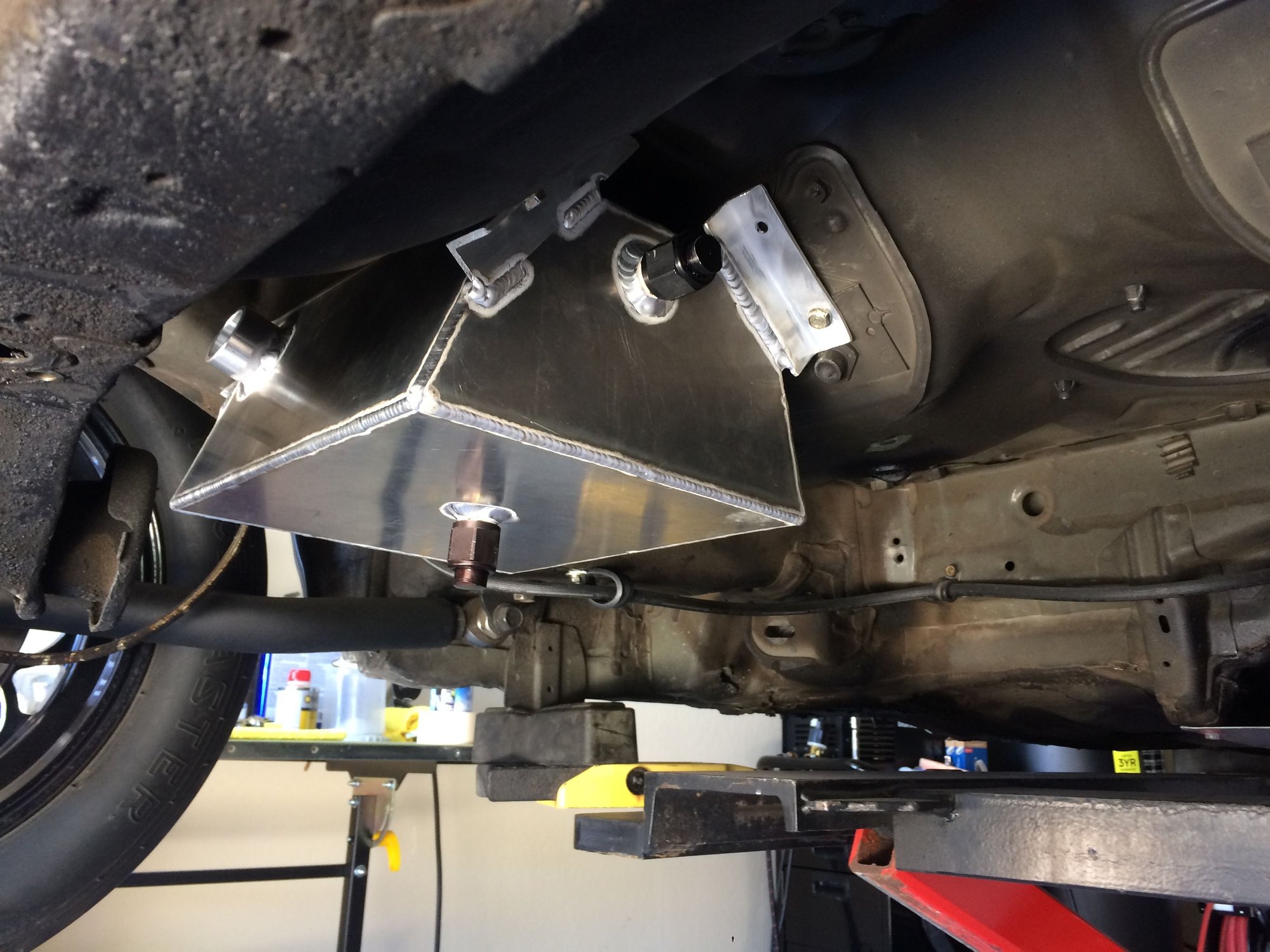

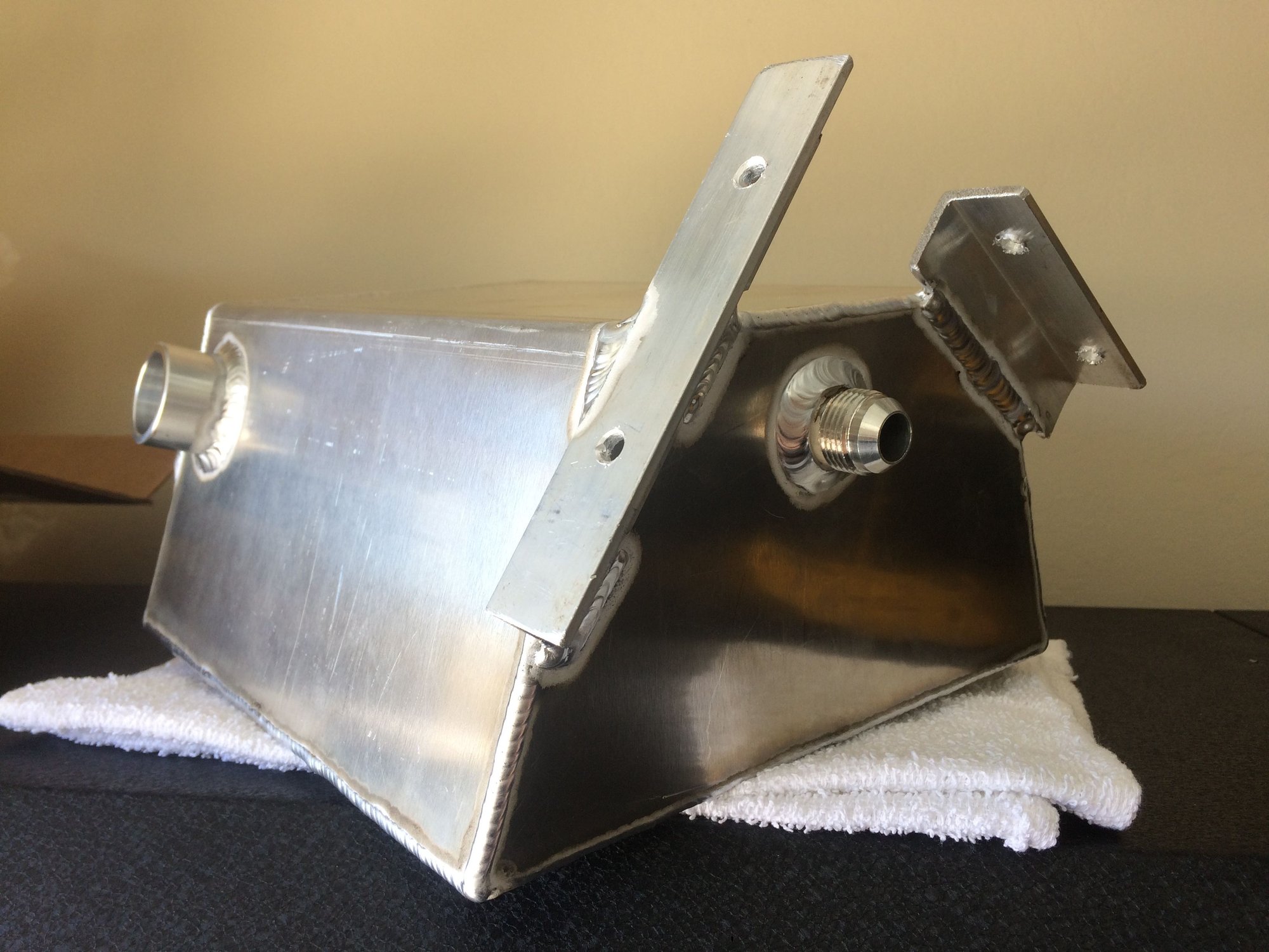

Been pretty busy working on another car I got from the auction but now that I’m done I got a little done on the race car. I built another breather catch can that will be sitting under the car where the stock fuel tank used to be. I had so much pressure that would build up I had oil push out of the catch can up front. Now I did do a bunch of restrictions on the catch can up front and haven’t tested it but my buddy did the same thing I did and it stopped the issues we were having.
This will help a lot because the line will be about 10 feet so I can relieve the pressure and the cool thing is that it will vent out of the old gas filler neck.

Very nice! Looks like it belongs.

Thanks man, it too me all but 20 minutes to get some cardboard and make a template, this one was a pretty easy setup, especially since it doesn’t return to the motor.
