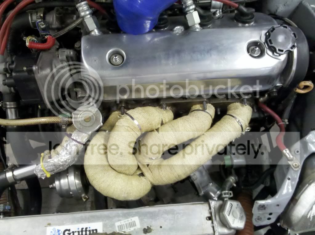

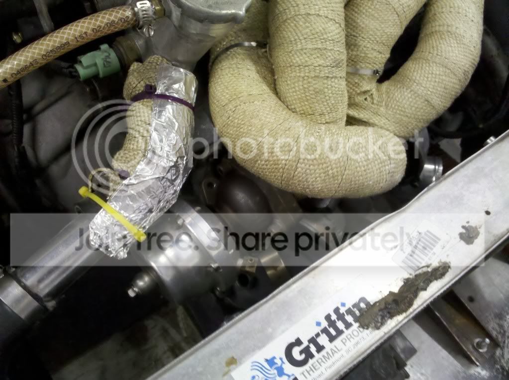

since i am whoring pics, here are more! boosted chemist should like this
putting my turbo setup back together, with a new turbo. check out that massive outlet on the huffer...NEAT! should have a good powerband with my f23/f22head setup
had to cut/weld a little "kick" on the outlet...had to angle around the radiator a bit. my old turbo had a slightly odd housing on it. this one (borg warner GM8) is different. welded V band on the exhaust too.
i obviously wrapped a bunch of stuff to keep some heat where it needs to be... i'm also putting a turbo blanket on. its basically a track car now....it'll make some HEAT. used to run track events turbod, but its been a year or so. trying to fix what i wished i fixed before.

Looks good man, glad to see you getting right to it and then some! the ever evolving civic!
bet your glad you held on to her now!
are those axle straps on the header?!

looks like header wrap ties
