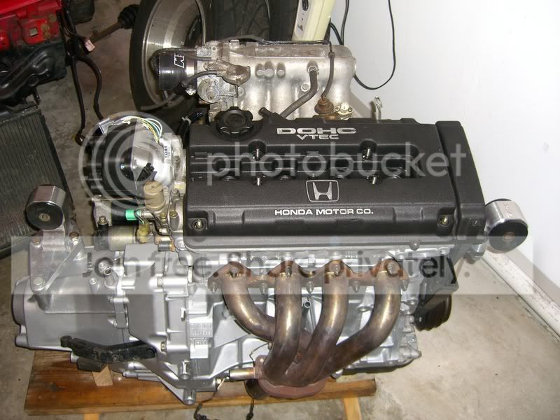

how did you get that SO clean?

I painted it! When I got that tranny case, it was so nasty I had to put a wire wheel in a drill to clean it up. I did it in the yard because the sludge was going everywhere. I originally wanted to leave it bare metal, because the block looked so nice after I had it cleaned up and reassembled. I'm normally not into painted engines, but it was the only way to make it look clean. The wire wheel gave the tranny case an ugly appearance because of the swirl marks.

looks nice
I need hasport mounts

what kind of paint did you use. looks sweet!

that transmission looks huge!

A couple of you asked what I painted my motor/tranny with. It was duplicolor high temp. engine paint. I think it was just the standard aluminum color. The block was cleaned by the machine shop. I cleaned the head and tranny. Painted them all seperatly. I wiped everything down with rubbing alcohol before I painted, to removed oil/grease. So far the paint seems to be ok. I've heard it sticks better once it gets warm. We'll see.
