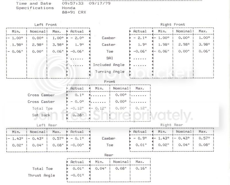

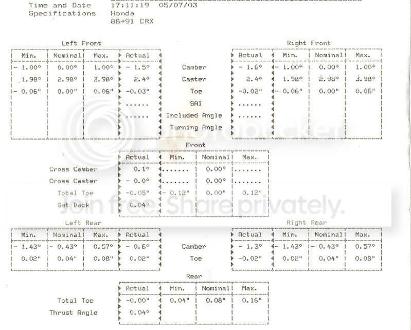

<TABLE WIDTH="90%" CELLSPACING=0 CELLPADDING=0 ALIGN=CENTER><TR><TD>Quote, originally posted by blaak-crx &raquo;</TD></TR><TR><TD CLASS="quote">Okay here are my results with proof:
Stock Crx Si 1991 brakes set-up: with Neuspeed Race, Koni Yellow.
Camber was modified but it was at around 2 degrees.
DA brake kit (knuckel and caliper): with Neuspeed Race, Koni Yellow
Caster no big difference (0.5 degree difference)
Camber: I used Ingalls camber kit to set at 2 degrees.
Toe: my set-up
It's been two years that I have the DA brakes and frequently use my Crx on the track. Way better braking and it never faded like my stock Si brakes.</TD></TR></TABLE>

what was he proving??
