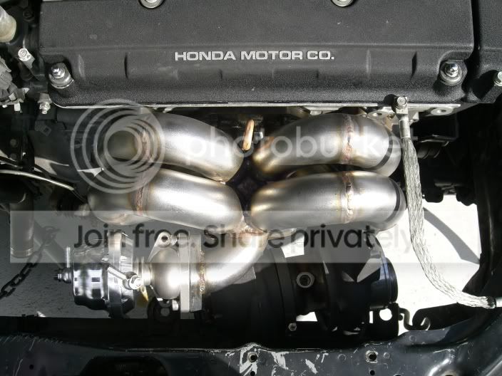

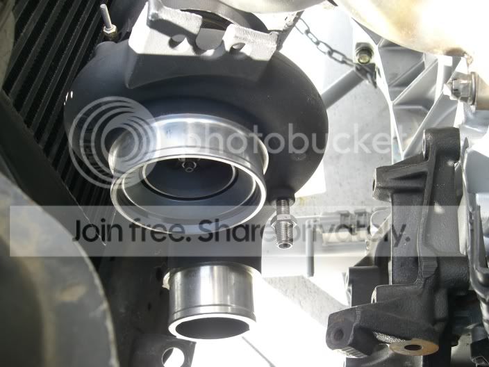

Picts of my bay with Neukin and hy35.

You Jewish?? I know the Shema. Hehe, went to a Mesianic church for a while.
The chains are from my tow dolly that the car is on. I was towing it to and from the fabricator (well, the wannabe fabricator anyway) to get my dp made. I have since taken it to my friends shop 160+ miles away to get it done right. This is what he did...........
https://honda-tech.com/zerothread?id=1533197
He also welded on my turbo, which I don't really care for either........and then he was a real tool about me not being satisfied with the job.
