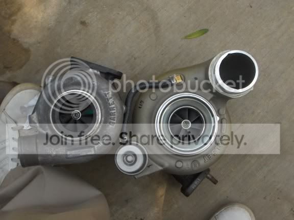

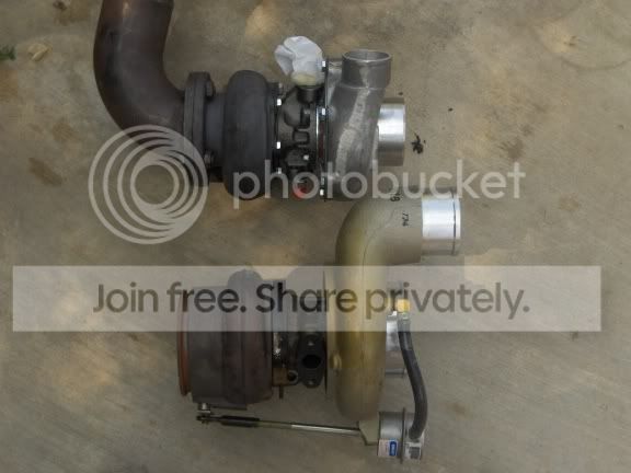

Here are some picts of the turbo.
Next to my garrett
I'll post some picts of my setup when it's all together, the engine is in and just waitin' for the all the turbo goodness.
Oh, yea, the turbine housing isn't split so hopefully it will still spool alright. Anyone know where I can get a different comp housing, that wierd outlet will be a pain to plumb up.

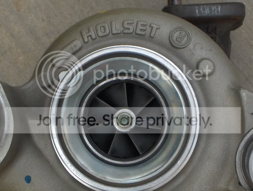

<TABLE WIDTH="90%" CELLSPACING=0 CELLPADDING=0 ALIGN=CENTER><TR><TD>Quote, originally posted by drumking15 &raquo;</TD></TR><TR><TD CLASS="quote">
there are already links w/in this thread...look for them and you shall find them...dam pics take to long...my guess is you have a 90 off the compressor which is a dead giveaway thats its a hy35 </TD></TR></TABLE>
You mean this??
Strange this says hy35w, but this turbo is not water cooled. Oh, well, it was free 99 right??

the w doesnt stand for watercooled

it means internally wastegated

Crap, I coulda swore that I read in one of the manuals that the "w" stood for water cooled. Prolly just confusing it with another brand.

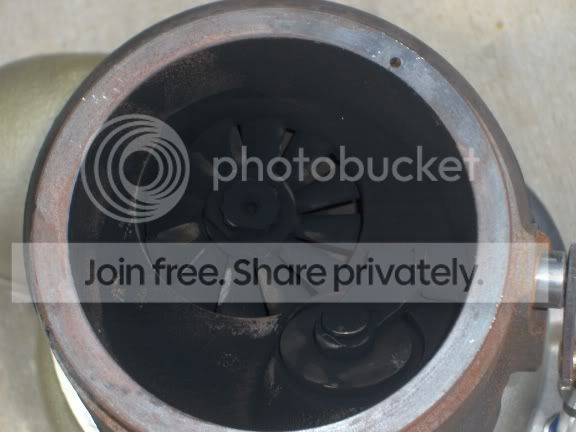

I just realized something, if I build a split housing manifold, won't the internal wastegate only vent 2 cylinders? That would be retarded...
I wonder if it would be worth it to get a non wastegated housing and use 2 wastegates to vent each side separately..

vening two cylinders would work just fine, if you cut half the turbos exhaust flow, its gonna slow down drastically. or you could get a non wastegated turbine housing and use one wastegate and place it on the manifold, that is, have two runners going to the wg, one from either side of the collector
