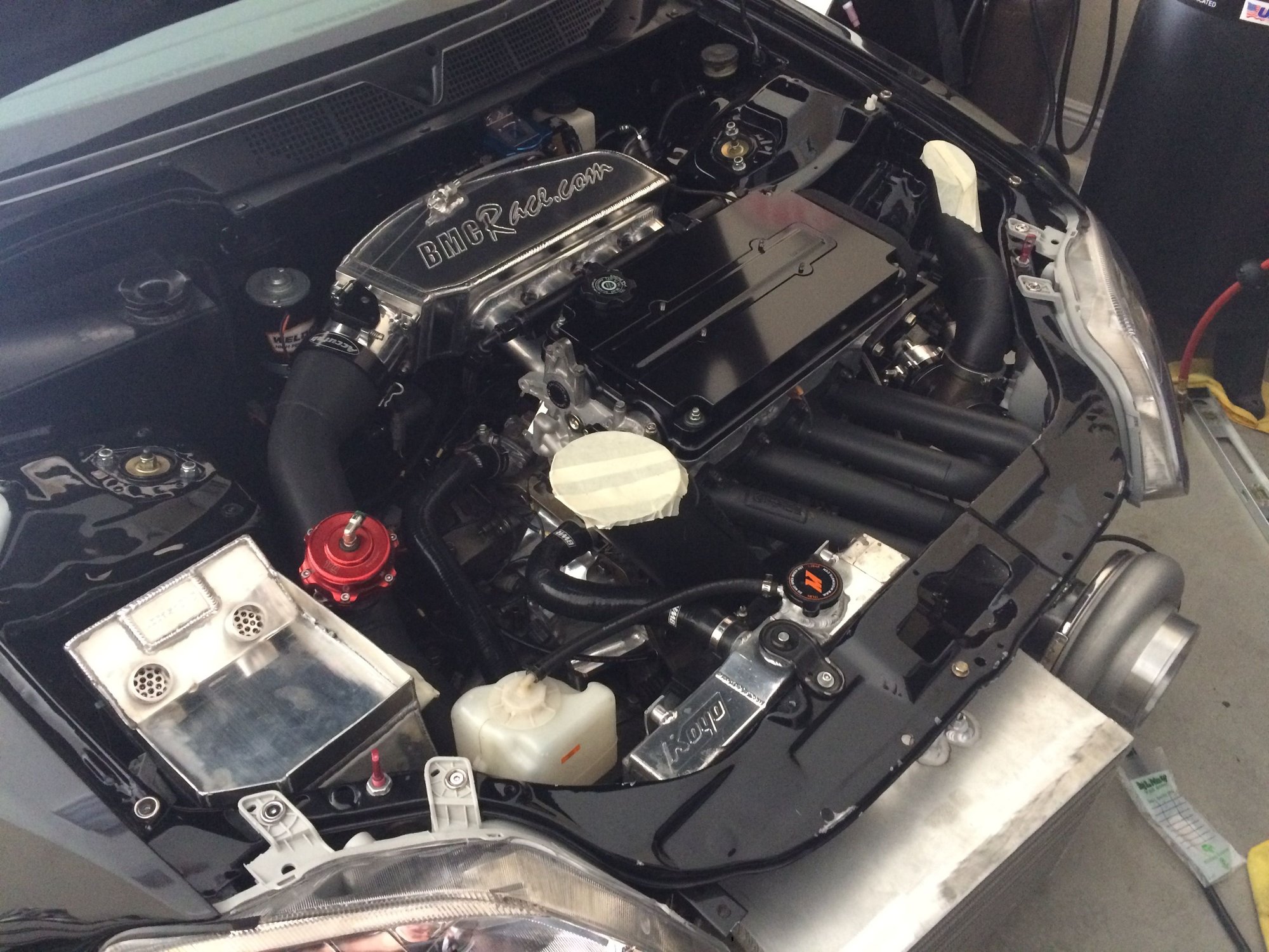

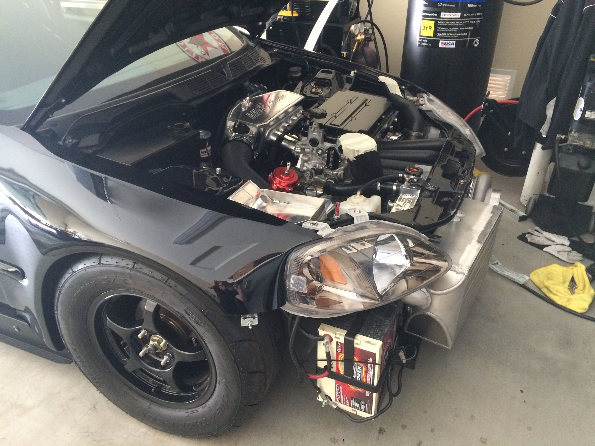

Got it all in, now I need filters for the box.

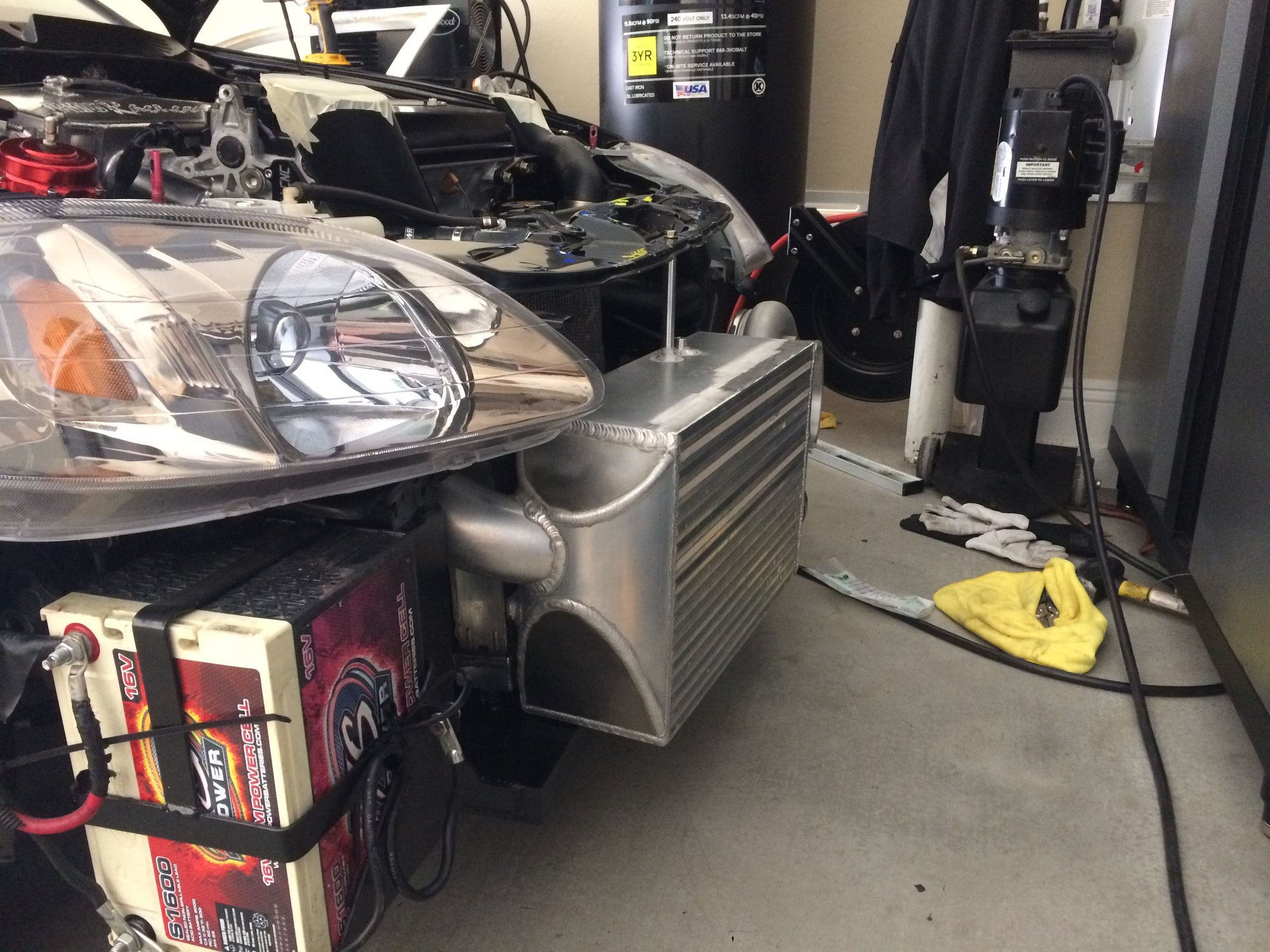

First - that's the deepest intercooler I've seen...it almost looks comical. Not hating, that thing is just THICC. Second, your build is so meticulous and clean - I really enjoy following this thread and hope you meet your goals.

Thanks man! Yeah the intercooler is 6 inches thick and rated for 1300hp and pretty much needed.

One picture, a thousand WOWs... Is that a bllet valve cover??

Yes that is, anodized black.

Incredibly clean. Love the billet cover and the BMC intake.
And yes, that intercooler is thicc

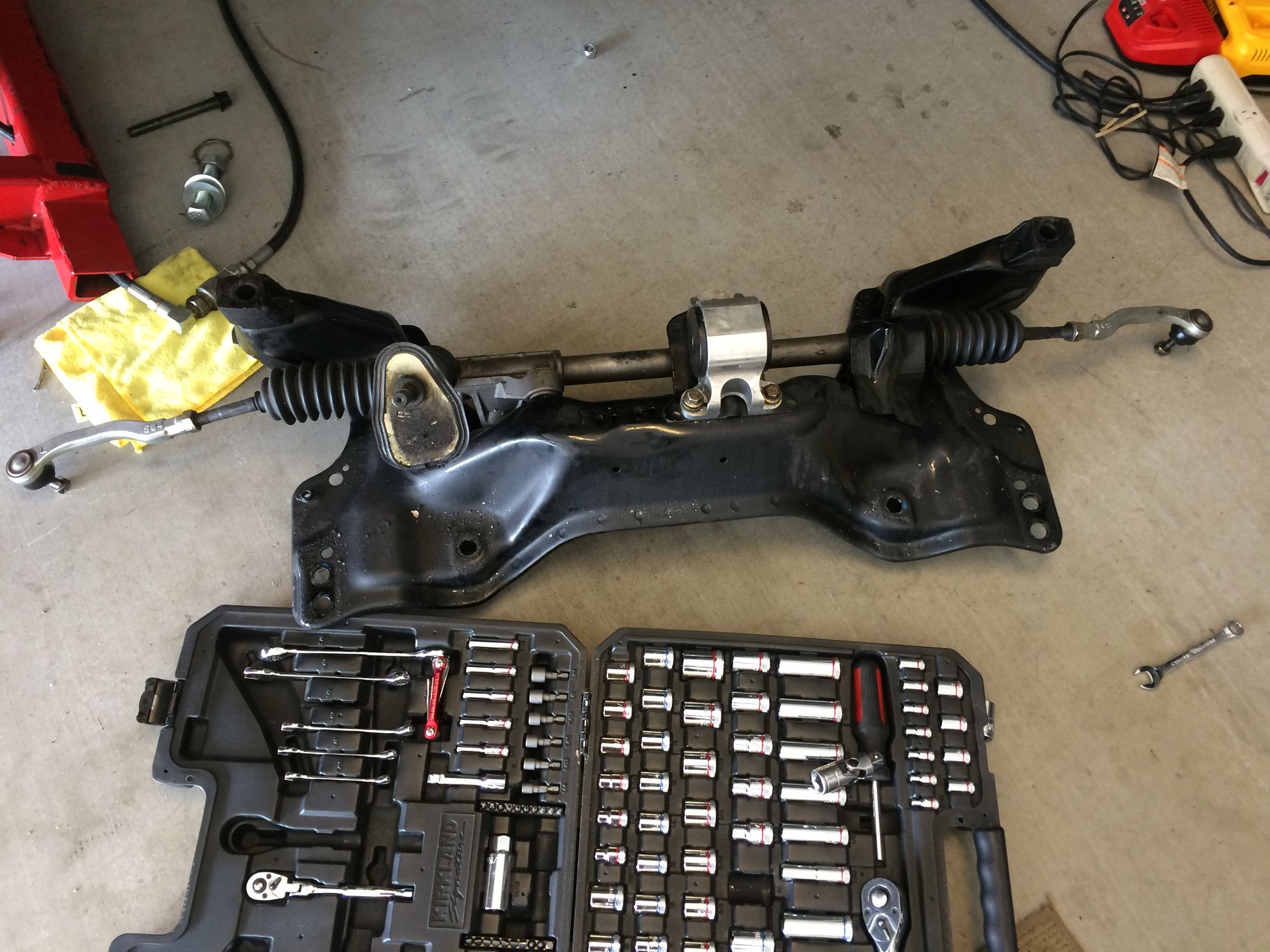

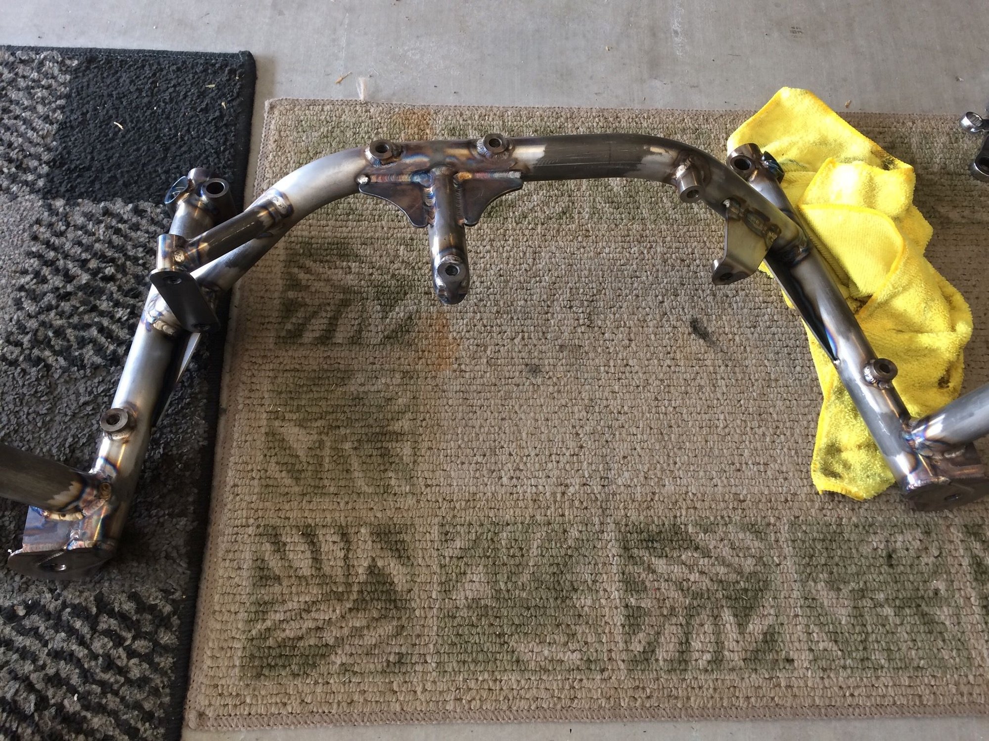

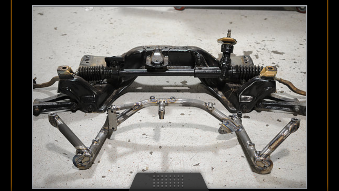

Thanks guys!! So about 5 years ago when I was doing all my Kingpin suspension upgrades I also switched from the EK Power Steering rack and subframe to the EG manual rack and subframe. Over the years though the lower control arm welded nut on the inside of the subframe broke on the driver side and I had to do the old cut a hole in the subframe and weld the nut back on. Well one thing I noticed on my car awhile ago was play on the passenger side lower control arm and sure enough the welded nut on that side broke free. So again I had to cut into the subframe and replace the bolt, at this point I decided to order the NRG Subframe and just ditch the stock crap.
This subframe only weighs 8 pounds compared to the stock 31 pound subframe so I not only get a better subframe but I also drop some additional weight which is awesome. This was a pick off of NRG's website so can't weight to get it in.

Dang.. Looks like there's nothing to it. Lol! 31lbs is no joke either. Good purchase!

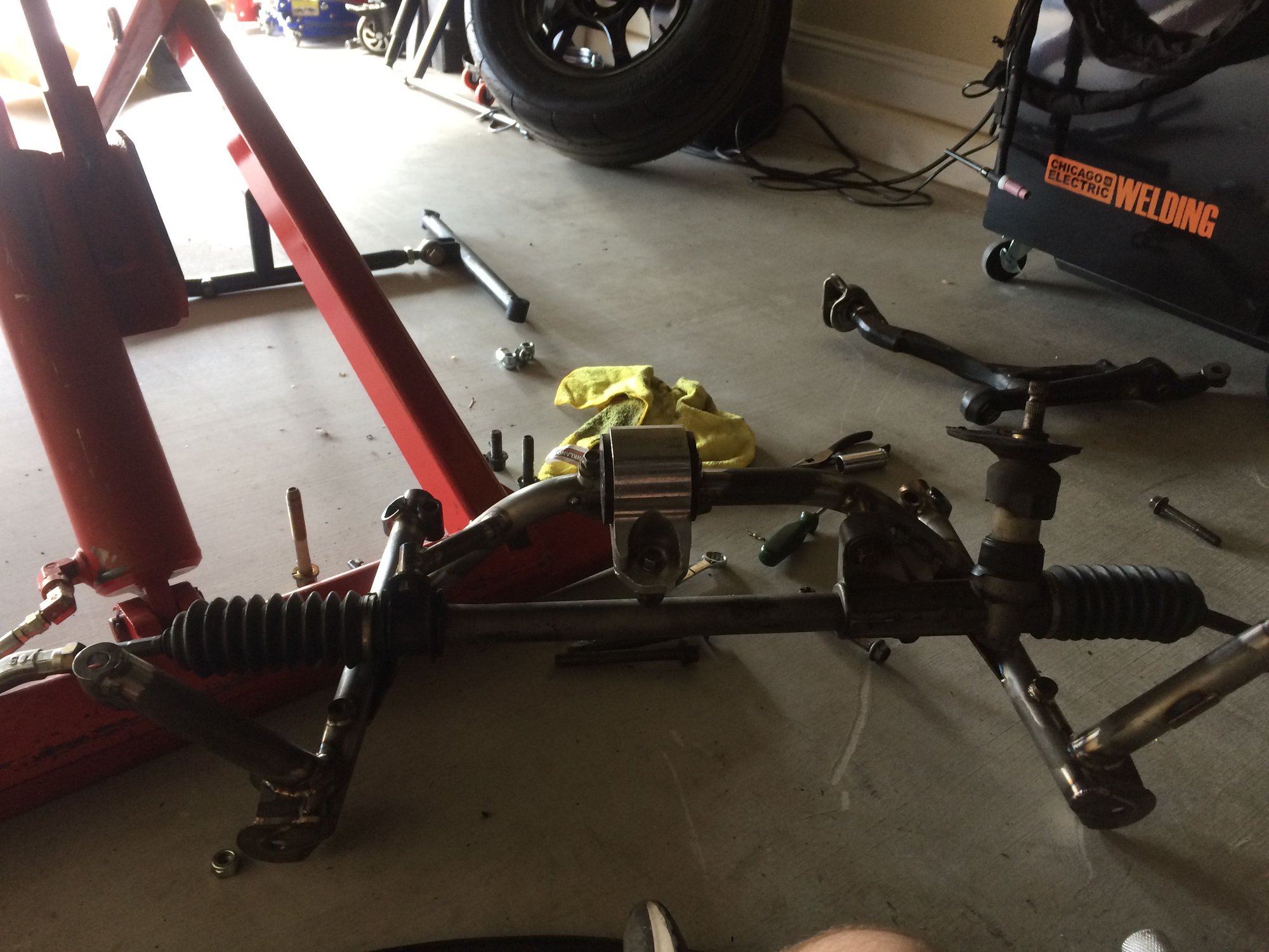

Got some things done.

Nice! If it wasn't such a pain to find a manual steering rack right now, I'd convert while my engine is still out. Looking good, AZ!
