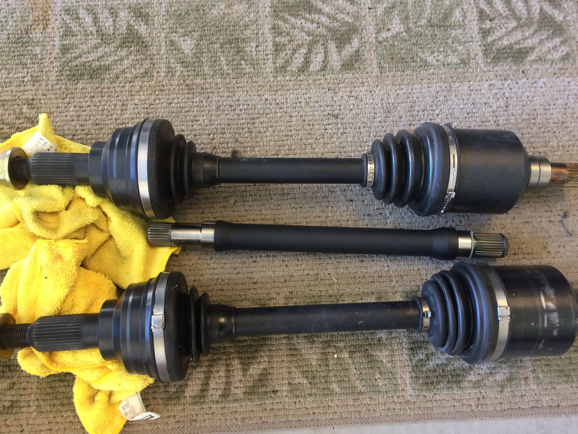

Pulled the bearing off the old intermediate shaft and pressed it on the new DSS shaft. Thought it would be harder but it was easy.

I’m wanting to upgrade my front hubs and go to larger axles also, I have not started pricing them yet since it will probably depress me. Lol when will you have this track ready again? Spring?
I’m trying to get it ready for IFO in Vegas on 12/2/2018.

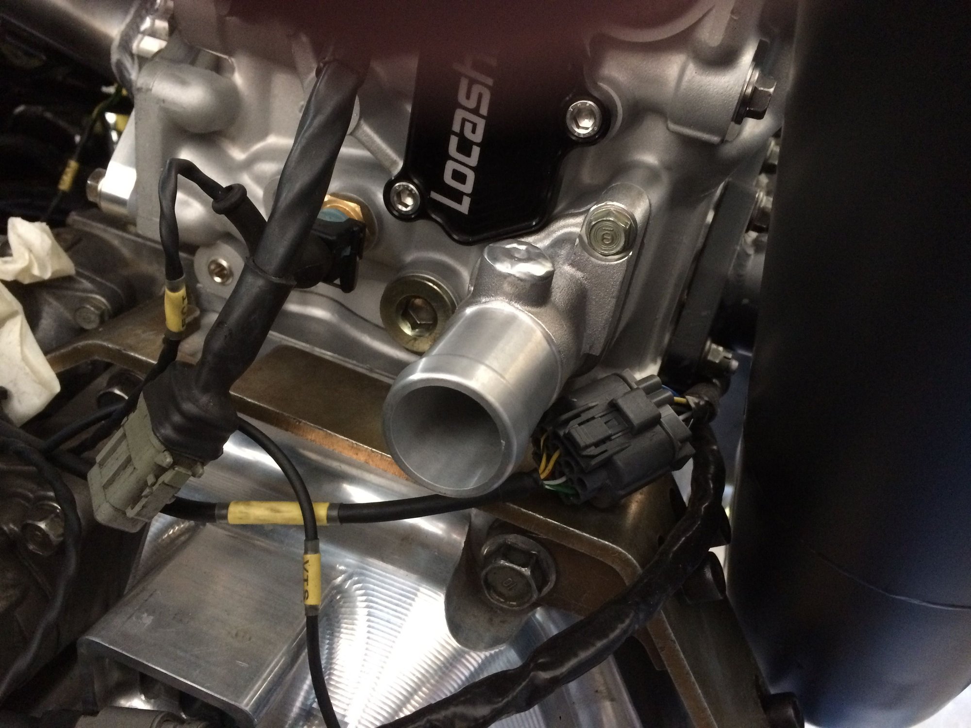

I also bought a new water neck to replace the old dirty one I had. I also pulled the oil pan off because I need to get a new drain line tube made as you can see in the picture below my old oil pan got destroyed when the motor blew.

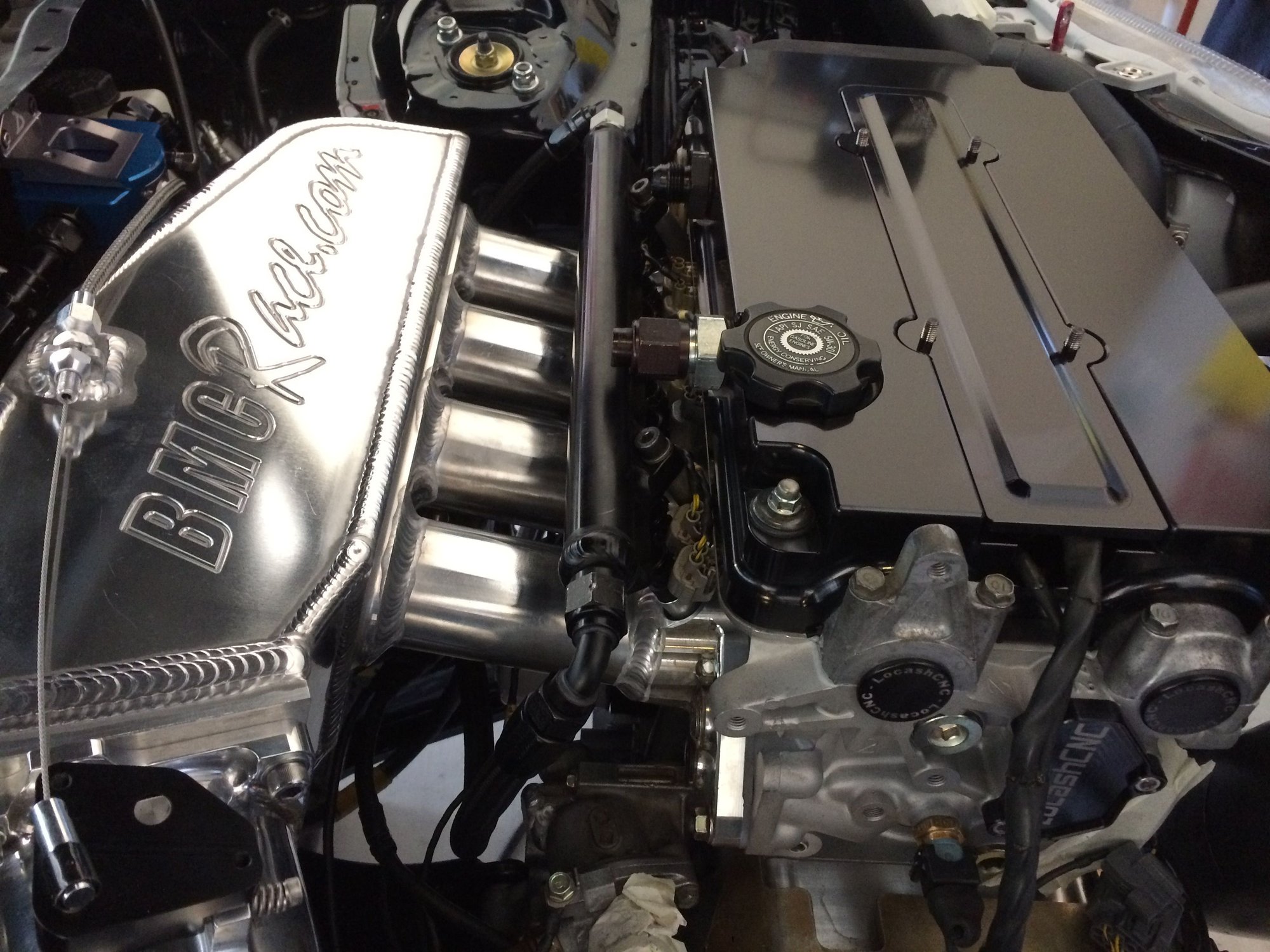

So here's some other stuff I am testing on my car, the last event I was in, I had a lot of issues with my oil catch can literally blowing oil out the filters and making not just a mess but a dangerous mess. Since I needed a new oil pan and had to weld on the new pressure/drain tube I thought I would make some changes by incorporating a little baffle so that crank case pressure wouldn't just blow up from the tube up into the oil catch can. You can see with the angle it's basically a shield that is block the tube entrance but having the little holes will still allow oil draining back from the catch can back into the pan.
I am going to be getting creative with the valve cover as well so I will get some updates on that when I get it done.

I had that problem too when at higher boost levels when the can was getting fuller

Yeah, the weird thing is I don't know if it is getting really full or the pressure is so high it spits the oil out of the filters. I am running 50 psi so tons of pressure starts building up, we've also noticed on the other race car during deceleration it is doing the same thing.
I am hoping that by adding a baffle in the pan and baffles in the valve cover it will help not push oil as much, I am going to modify the oil can a little as well.

What is the spout for as it dumps back into the oil pan? Also, what psi do you start seeing oil blow to catch cans? Or is it more relevant to the hp numbers. 25psi or 450hp and up?

It’s a baffle to keep oil from being pushed back up when crank pressure goes up. Now I only started seeing this oil issue recently and never had this issue before. I would say you probably wouldn’t see anything crazy under 30 psi.
