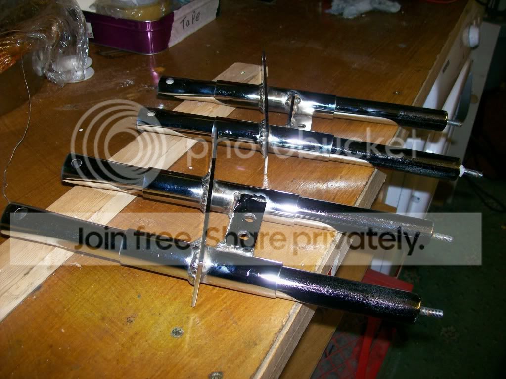

Anyway lol, small update. I was waiting for the rear wing mounts to come back from chroming, i went away on holiday and they hadnt turned up yet. But it looks like my neighbour came to the rescue..
Im really chuffed how they came out... If the weather is okay ill get them installed tomorrow

NICE! Should cleaned up the welds before they got chromed.
