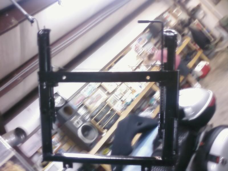

There is a DIY seat mount rails post somewhere on this forum. I've done my googling and searching. It was basically a how to mount flat mount seats (recaro, sparco etc) to stock rails. Anyone got that link?
Anyone ever tried that? I haven't checked to see if the stock rails are level or not. They may not be and the lower seat pan may compensate for it. Tips?
i got to get some better pics. but you are using a bottom mount seat right. I just drilled out the brads that hold the brackets to the rail. and bolted the rail in the car. measured the spacing front to rear and took some angle that i notched to fit in the rail and tacked it on the stock rails. took it out and welded. and drilled holes. I had to revise it when i got my fat boy seat
heres shitty pic of my current rail

Time is money, i could fab one, but the couple hours i save allow me to work in the lab and get more **** done, more publications, better resume, more money so i think im investing my money and time as best as i can.
Nice rail setup.

thank you sir.
