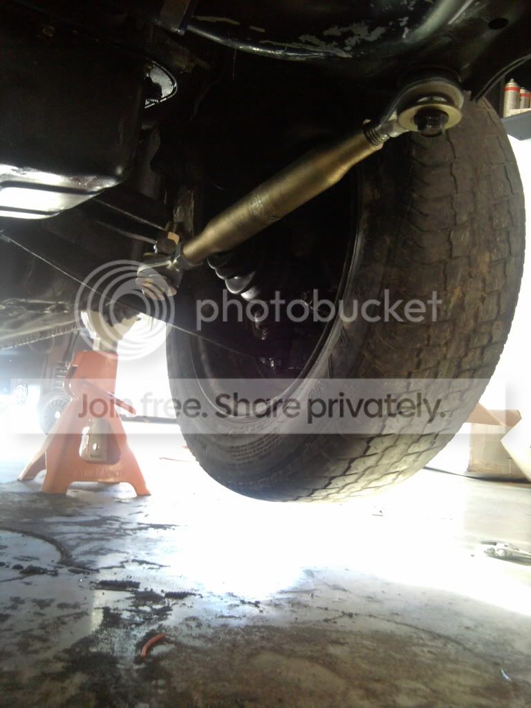

or you could be like these guys
Old Dec 29, 2010 | 04:03 PM
  #12360
Clipsed's Avatar
Posts: 7,217
From: Pasadena, CA, USA
Not a bad idea, but I'd be worried about the suspension compressing and the heim not having enough motion. They should have put misalignment spacers to give it more range of motion.

no jamb nut on the front either lol.....again thanks for the input guys, i think im ready. only really trust you guys
and anyone think 5/8" heim is too big
Old Dec 29, 2010 | 04:57 PM
  #12363
Clipsed's Avatar
Posts: 7,217
I bought 5/8" for my custom traction bar I'm making. I ended up buying 1/2" reducing misalignment spacers because the bolt was HUGE. Measure the hole on the kits joints that connect to the radius rod.(cut out that you have 2 pair of) That will give you the size that they basically cut it for. Doesn't look like it's 5/8" though.
