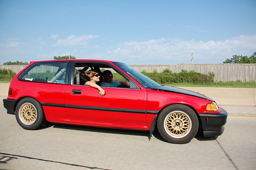

some pics a random duder (mr. meowsome ) sent me of my car from a meet...nice shots i think.
i've got new wheels now ,but not pics yet... thats definitely the best shot of my bay yet...its ok. good enough, not ryan quality though!

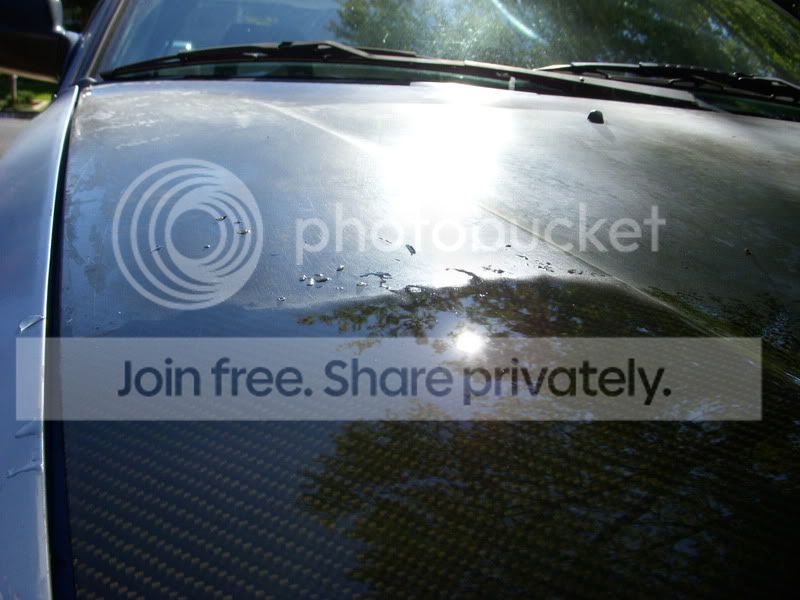

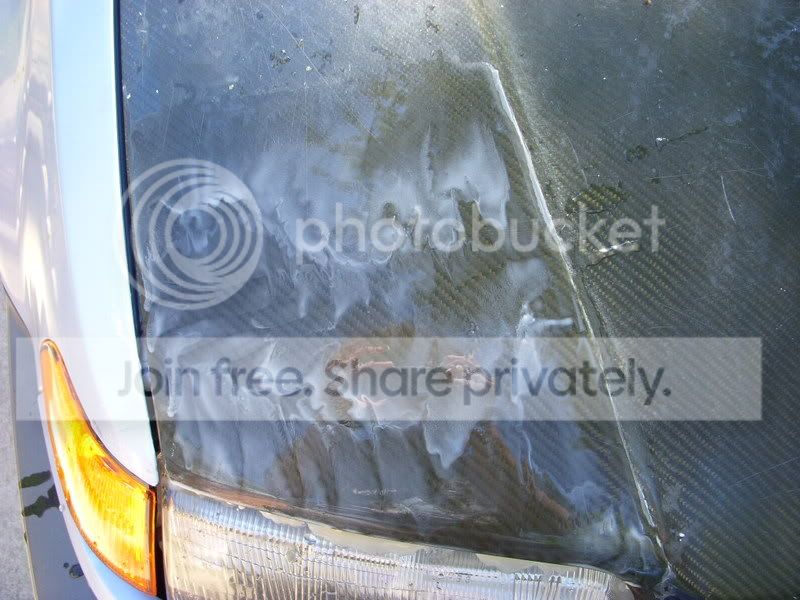

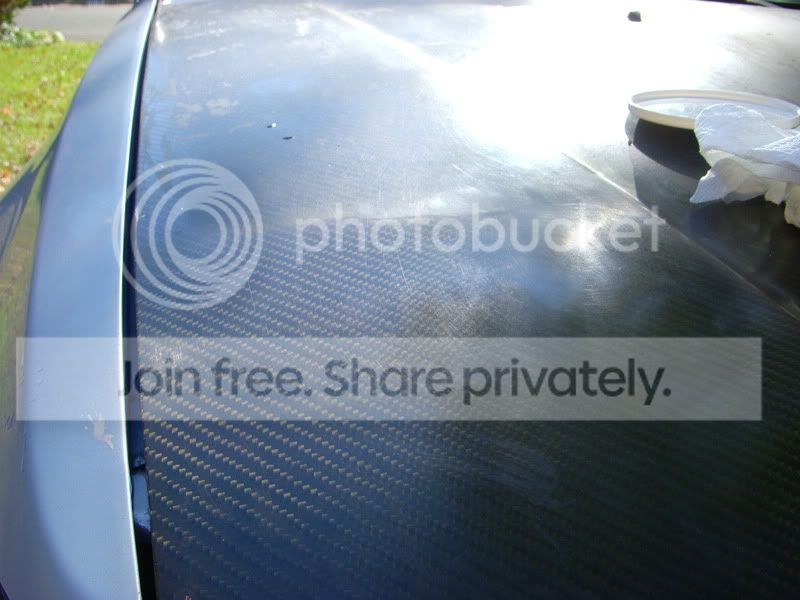

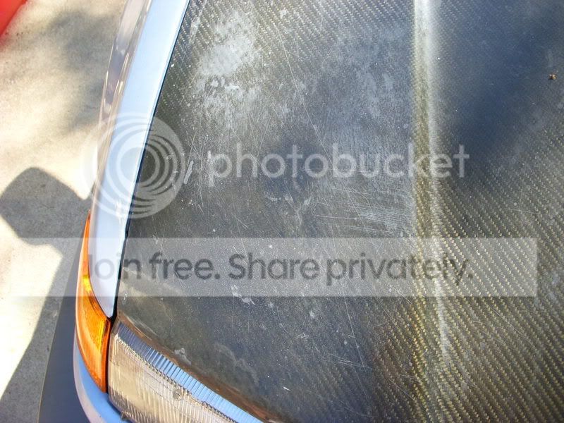

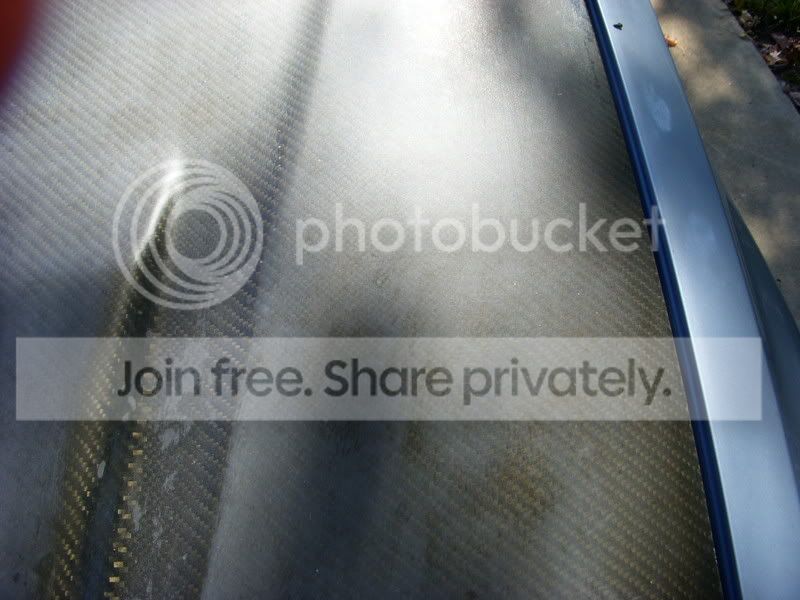

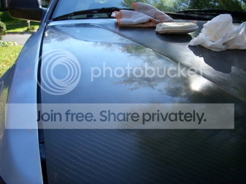

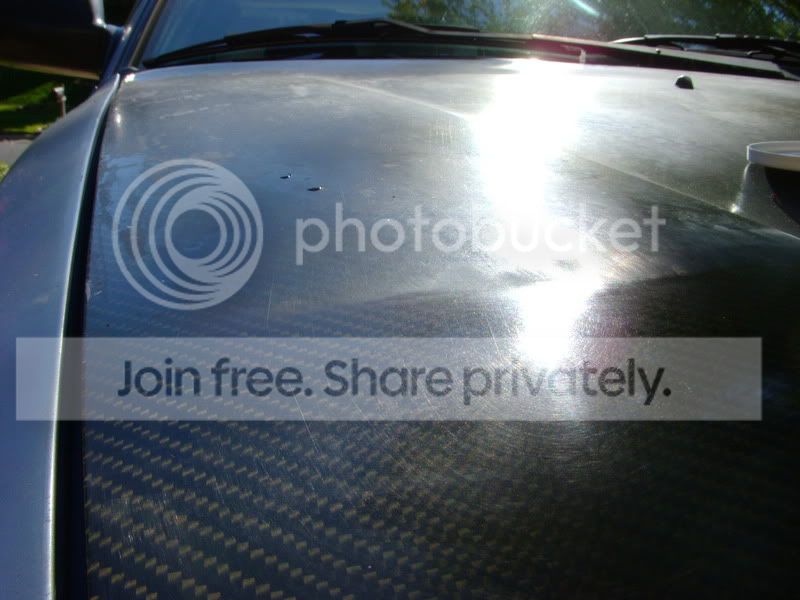

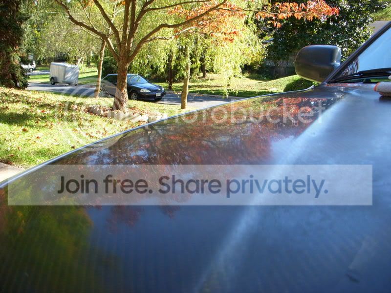

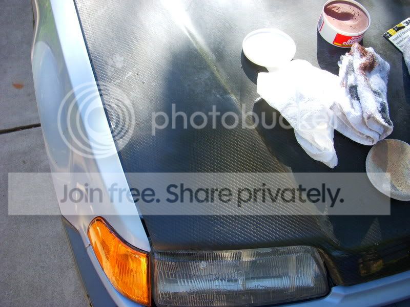

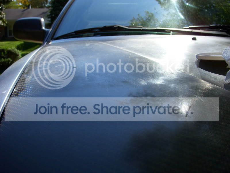

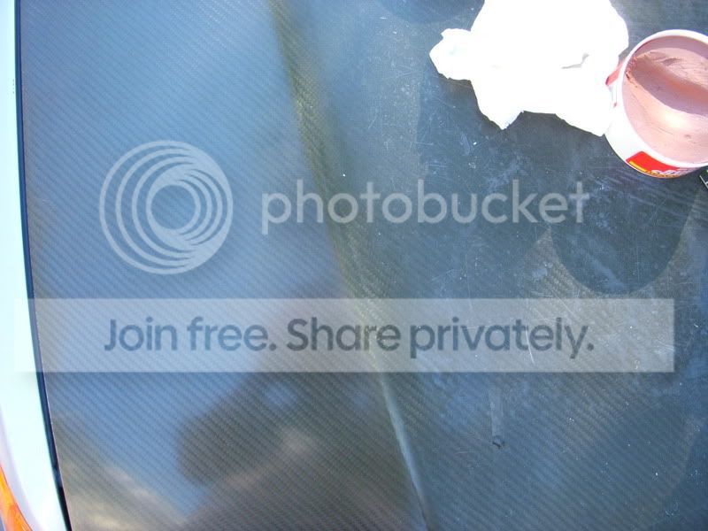

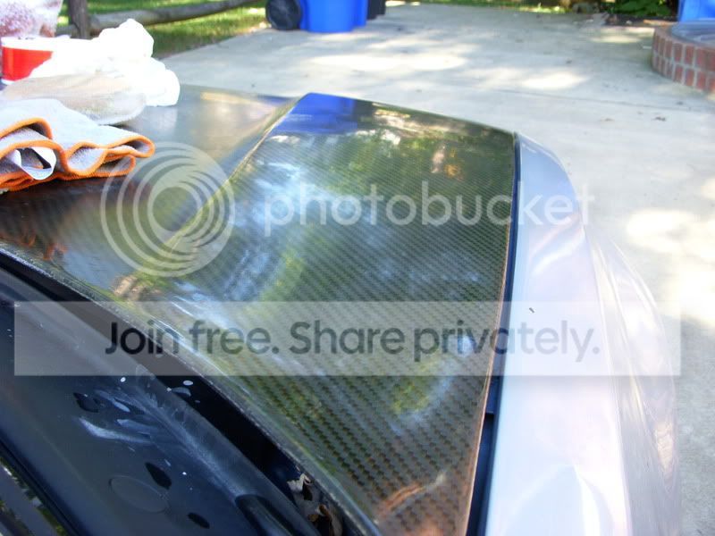

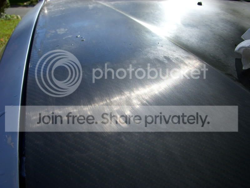

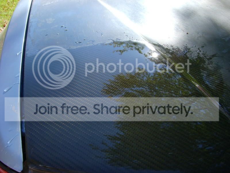

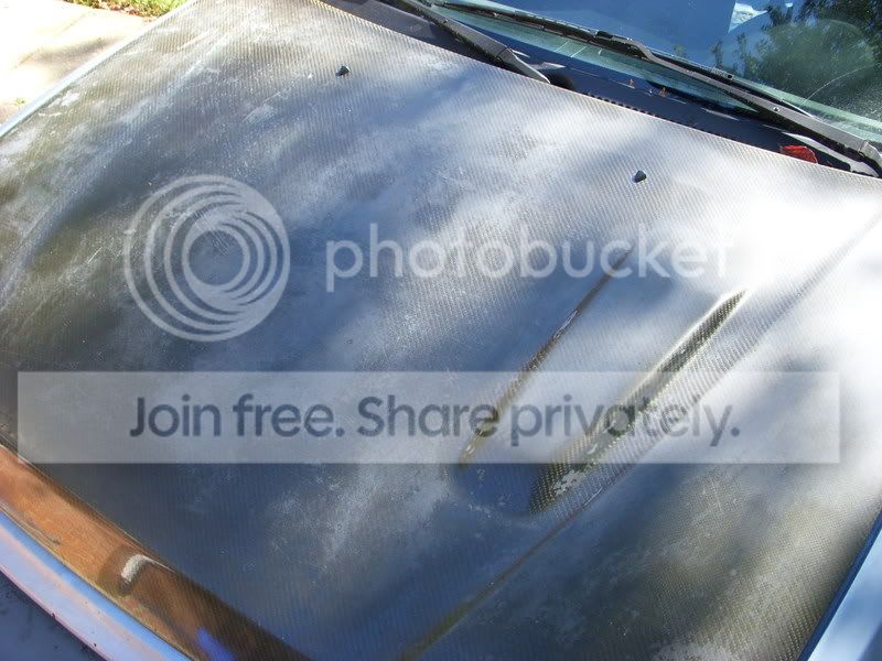

Tried restoring my carbon fiber hood this afternoon. I think what I did will be good for a while but I still want to buy a carbon kevlar hood if we ever get a group buy going.
Here's what it looked like to begin with:
Here's all the stuff I used:
Started on this corner first:
During wetsanding:
After I rinsed off the dirty sand water. Look how shiny it is!
After I dried the water off

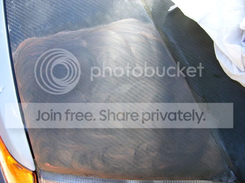

Turtle Wax Rubbing Compund to the rescue!
Taking off the rubbing compound was a BITCH because it would dry out immediately after applying it.
After that I used Meguiar's Carnauba wax:
Here's the finished product:
I know it's STILL not very shiny or anything but it's DEFENITLEY better than what I started with:
After I finished that little part I decided to finish the passenger's side of the hood off and see what it looked like:
Still not SUPER shiny, but it's a good start. I think I'm gonna buy a sanding block though for the rest of the hood since it'll make it a helluva lot more even. I'm also gonna try getting a buffer and use some of that 3M Marine polish/wax and see what that does.

looks good but i think after that wax melts off/dries it'll look like it did before. you should sand it smooth and have it recleared.
or do what i did.... paint over it! haha

Looks d3cent. In the future, don't wash or wax any part of your car in the sun though and you won't have the problem you did with the wax(among other things)
