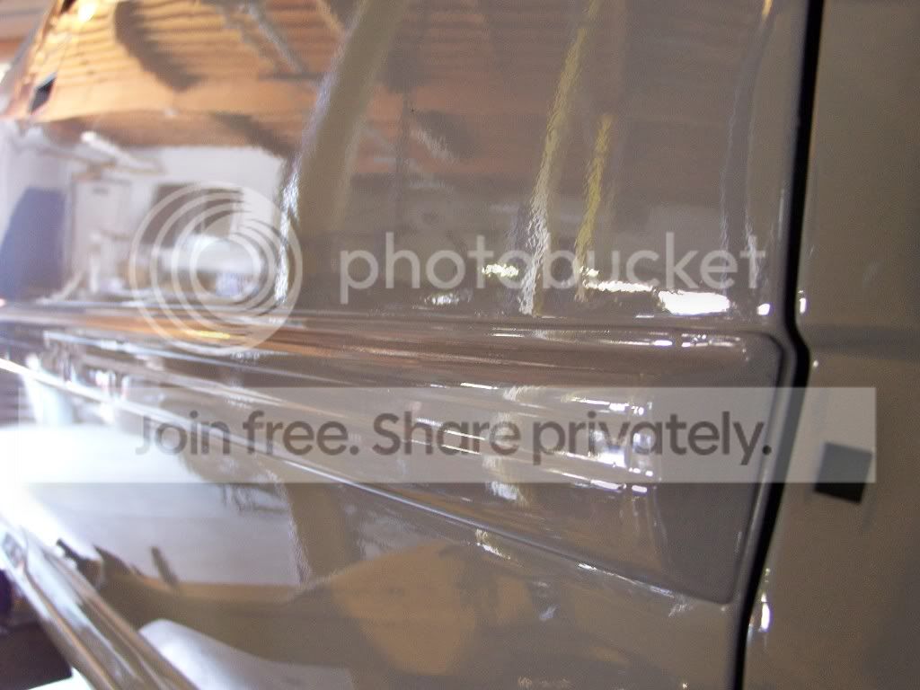

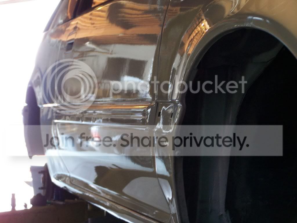

Mine was two stage if I'm not mistaking with mininal orang peel but enough for my to notice.
I was going to go through and do it when it starts to heat up
It aint all the bad but it aint all that great either

thats minimal? I should move to cali and paint cars...

yeah, that's actually quite a bit of orange peel.
Honestly, around here that would be a pretty fly *** paint job...seriously.
