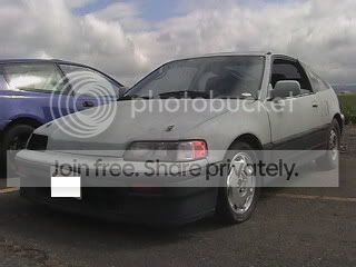

I feel the same way. I drive my crx hard. It was a daily driver, but i still used it for many Auto-X events and drag raced that car for 3yrs until I finally blew the motor. Now time to rebuild, and do it all over again.
Hopefully it will be back on the road late this spring.
