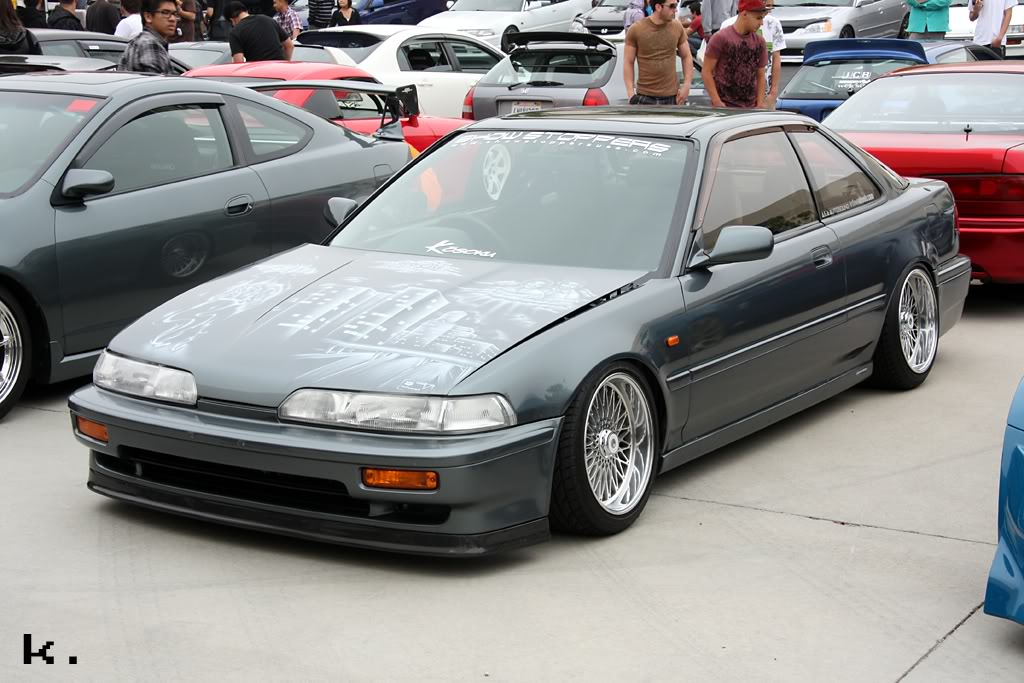

[QUOTE=kNOwLedGe.;
It's really not that bad in person. Not my steez, but not ridiculous either. Oh, and they're period correct wheels
Not my car.[/QUOTE]
Thanks for the pic kyle. Anymore pics from that day? You can email/pm them to me if you want.
The camber isn't too bad in person. Here's another pic that Kyle took from a different angle.

Old Jan 15, 2011 | 03:08 PM
  #45273
HeLLa iLL2ndGen's Avatar
Joined: Jul 2008
Posts: 2,576
From: Hayward, CA
Default Re: DA Integra's Only
Is that bronze tint?
