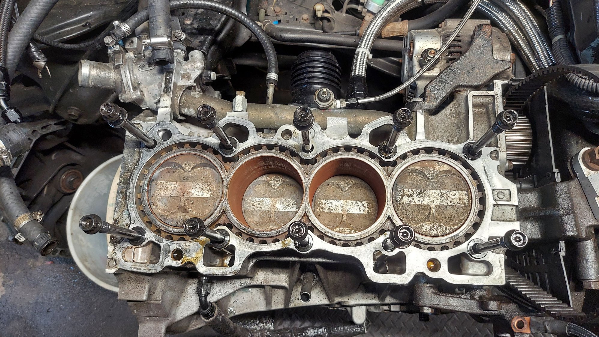

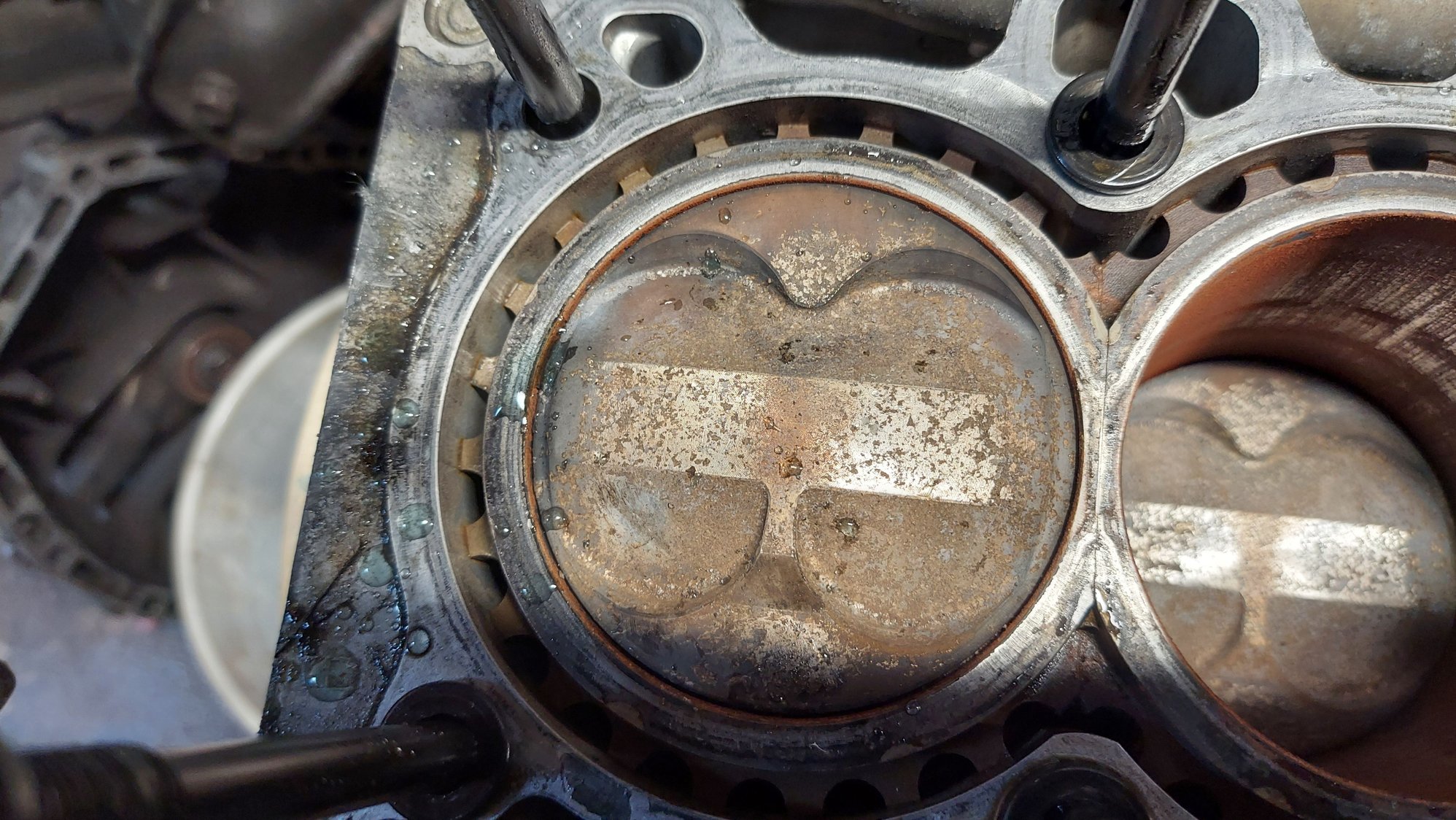

Lead deposits from the stupid cam2 racegas ruined my cylinder walls and injector. Walls are rusted and scored with lead deposits. Piston tops were rusted and pitted. Says its rusted like it sat outside in the rain for years. Injectors will need to be sent out for rebuild or some serious cleaning. I added 60% increase with no additional fuel. He added a cramp ton of fuel to the same result. So weird because there happened over the course of like six months
so once again its teardown and repeat.

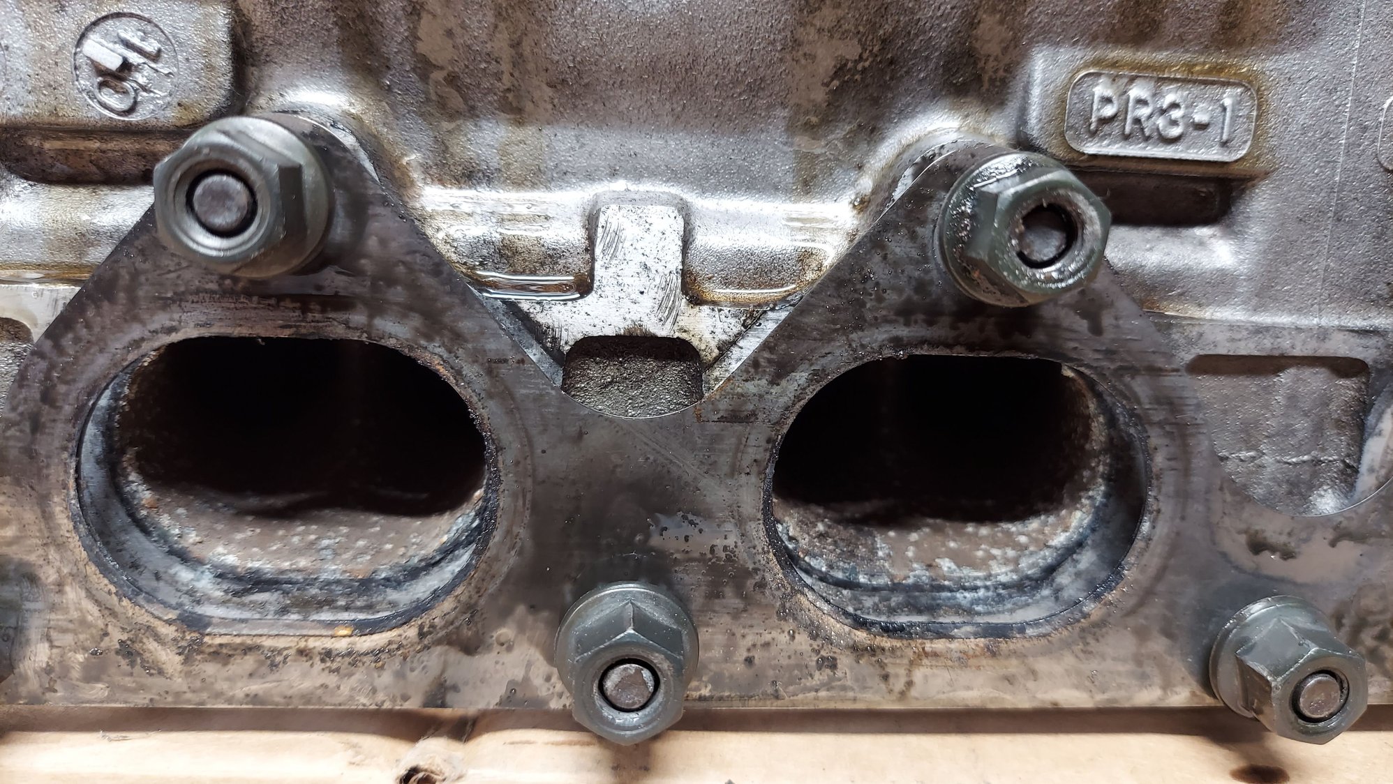

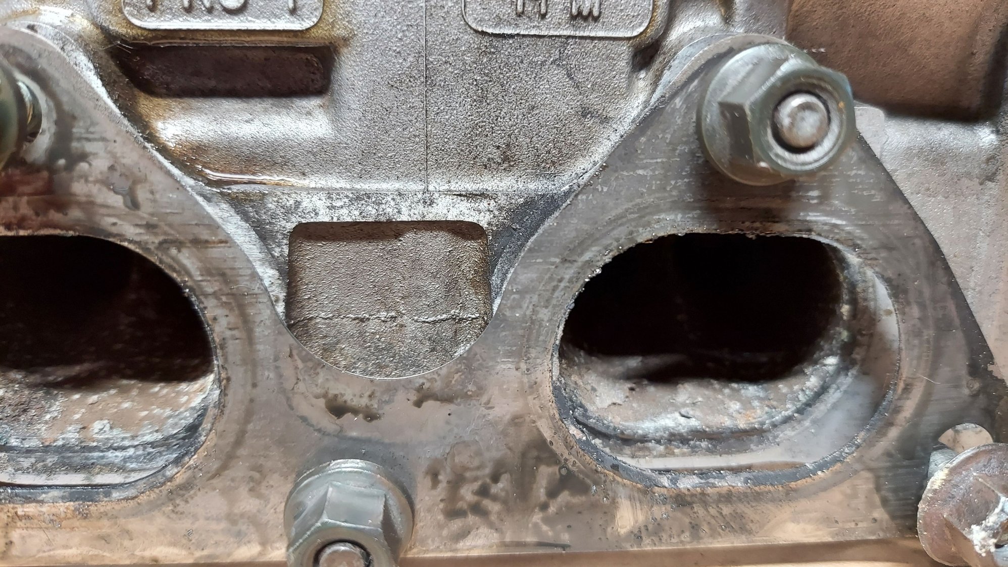

Leaded fuel pics

How long has that engine been sitting since it has run ?

Lol. Six ******* months if that. My tuner asked the same thing. Everything is documented here from when it ran on hondata. Started the install for the g4x ecu. And it idled poorly literally three times briefly before it died out. Then would do **** for months. Had me chasing my tail when it wasnt getting fuel all along. Due to the injectors being fucked. Internally, they prolly look just like the inside of my engine.
Spoke with an old car buddy some weeks ago. He reminded me, the he thought the cam2 racegas used to absorb water really good. So it was my fault for not empting the racegas, and running 93 octane thru the system. Live and learn. Now i need to do my homework on if the boostane octane booster will do the same thing. I can gladly go back to running that. I just dont remember if i was using it long enough for the car to sit and potentially do the same thing. Which im pretty sure it have, and didnt

Holy ****! Dude, I'm so sorry. I also run leaded fuel and leave my car for longer periods off but that has never happened before. Are you sure that's not water? What type of fuel do you run? I've been running a 50/50 mix of VP110 leaded and 92 octane pump. I have to replace my wideband every other year and my exhaust is white but other than that it's been fine. I should probably have my fuel injectors cleaned, it's been a while.

Eventually when i got the b16 bored to 84mm, i switched to 93 octane witha full 32oz of boostane. That got me to 104octane. Price was over hundred on gas(year or two ago mind you). I then remember that toledo sale cam2(racegas) locally at two different stations. Research showed that if was just rebranded sunoco 110octane. Ran that for literally one season i believe before i was done with the hondata issue. It sat with 1/8th of the cam2 fuel in the tank. **** the entire fuel system is prolly fucked. Something in the properties mite make it vulnerable to absorbing moisture. Or maybe the cam2 is more ideal for like 2 stroke dirtbikes or whatnot.
City 30mins up north from me sells 5 gallon vp fuel at their honda dirtbike shop. But the ***** a fortune.
I know turbolscrx down in kentucky runs the renegade stuff. And i dont think he has issues either

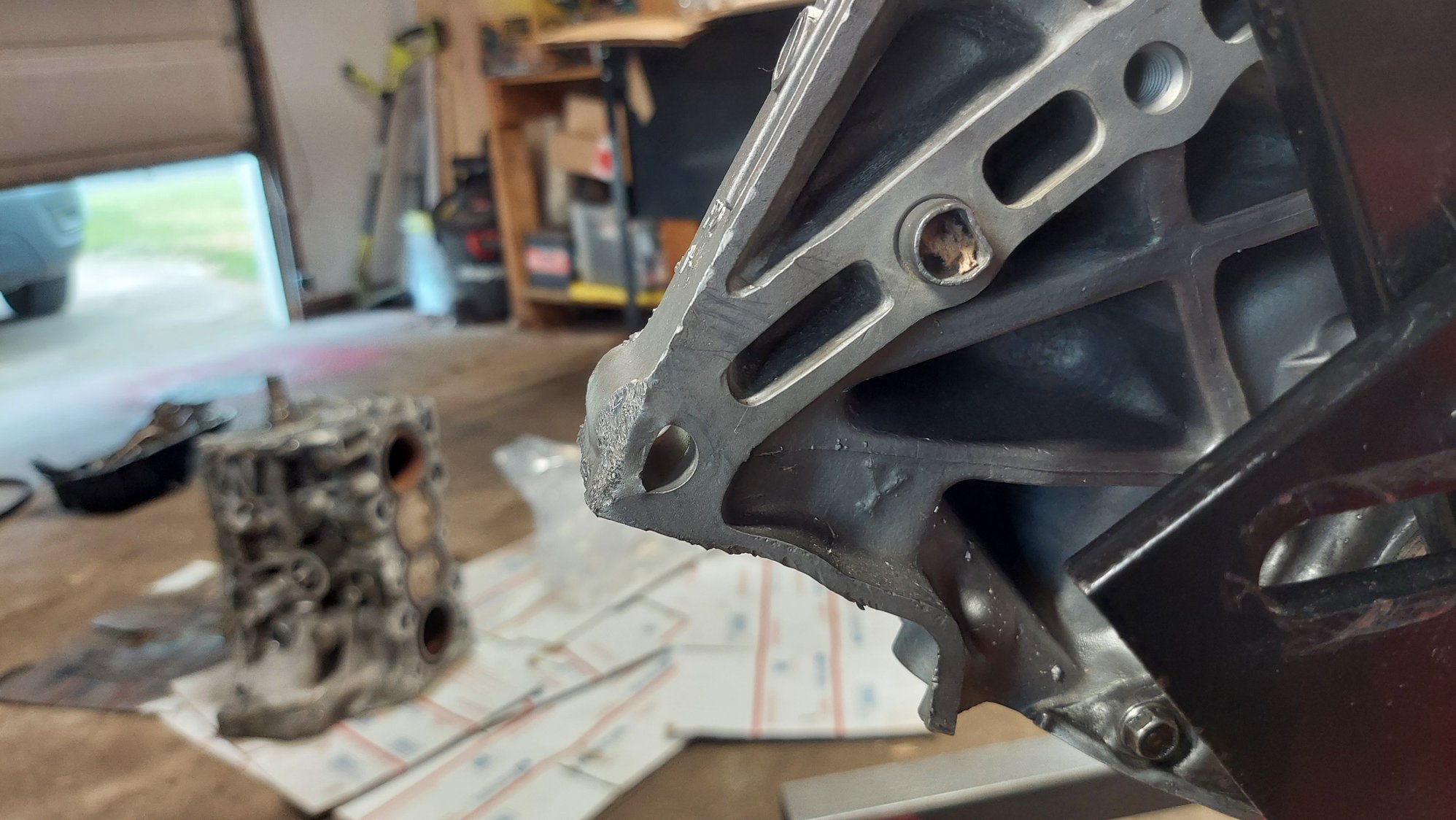

Finally got my block after being shipped here and returned to virginia twice. Box was fubbared. Naturally cause those ***** dont care. Just scanning and tossing boxes. Regardless how heavy or its marked fragile. Tranny mounting through hole was impacted and pushed in from being thrown around. Oil breather chamber port was spider web cracked also.

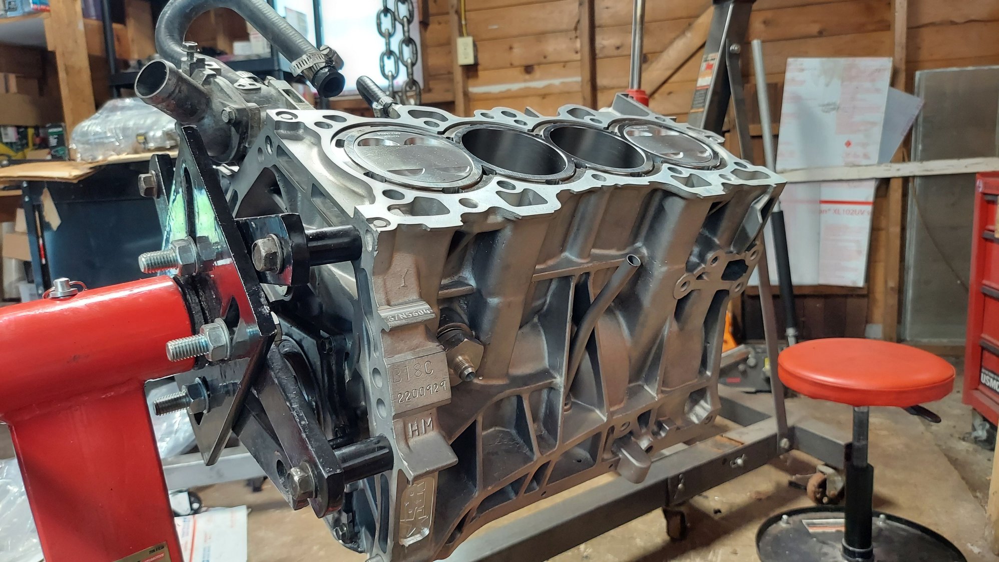

Started assembling the rest of the shortblock components. 2.0L 10.8 comp. The 10.8 traum pistons had alot more dome than the wiseco. Also took apart the old oil pump to check it out. And to see what all would need cleaned up or ported

Lookin good. You got a ramey block right? What clearances did they set the bearings to

Yea its a ramey shortblock. Its clearanced for 20w50.
-Mains are for the most part: .0024; .0025; and one at .0028
-Rods are at: 0021; and .0022.
They didnt send me the final deck height.
Pistons are wiseco -2.3CC, 30mm CH. static compression will be back to near 10.8 compression.
Got the surface lock, flywheel, and clutch installed. Then decided since im way more stout now than i was in my 20s, when i was lifting these tranny all the time, that i would bench it up again. Slid it onto my chest. Then pressed that bitch right up there no problem. ****** would go in. Did that like four times. Then decided to go get the jack lol. As im looking at it for overhead, i still had three tranny bolts threaded into it lol. Put them back i so i remember which length goes where.
Anyways, got it all back together. New speedfactory magnetic drain plugs and detent springs. From comparison, the speedfactory ones are longer and stiffer. Have prolly two days of engine bay work left. Waiting on headgasket from golden eagle. Gona order my torco fluids, then pick up some basic supertech oil to flush any debris for startup. Then change to the sr1 oil.
Still will have to pump out all the BS fuel out of the tank. And put the fuel filter in the cleaner
