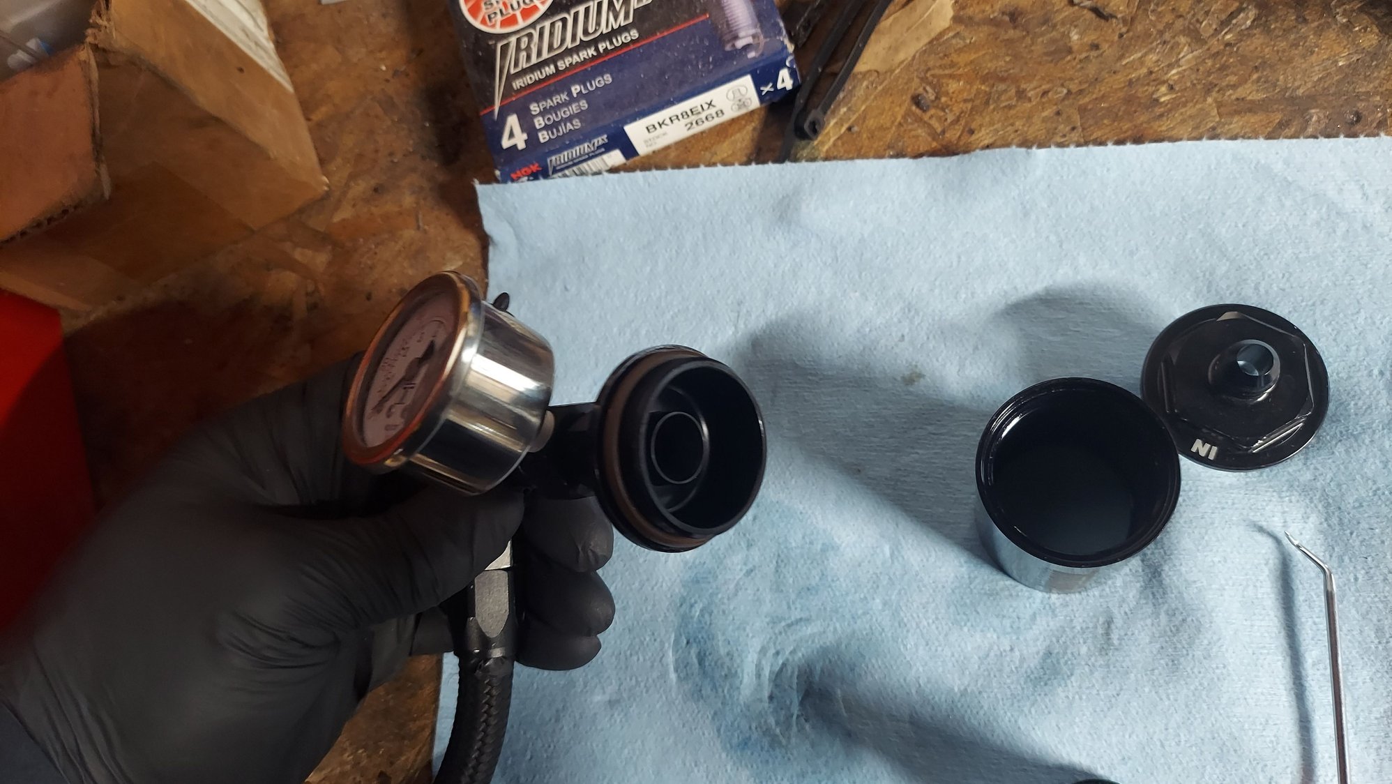

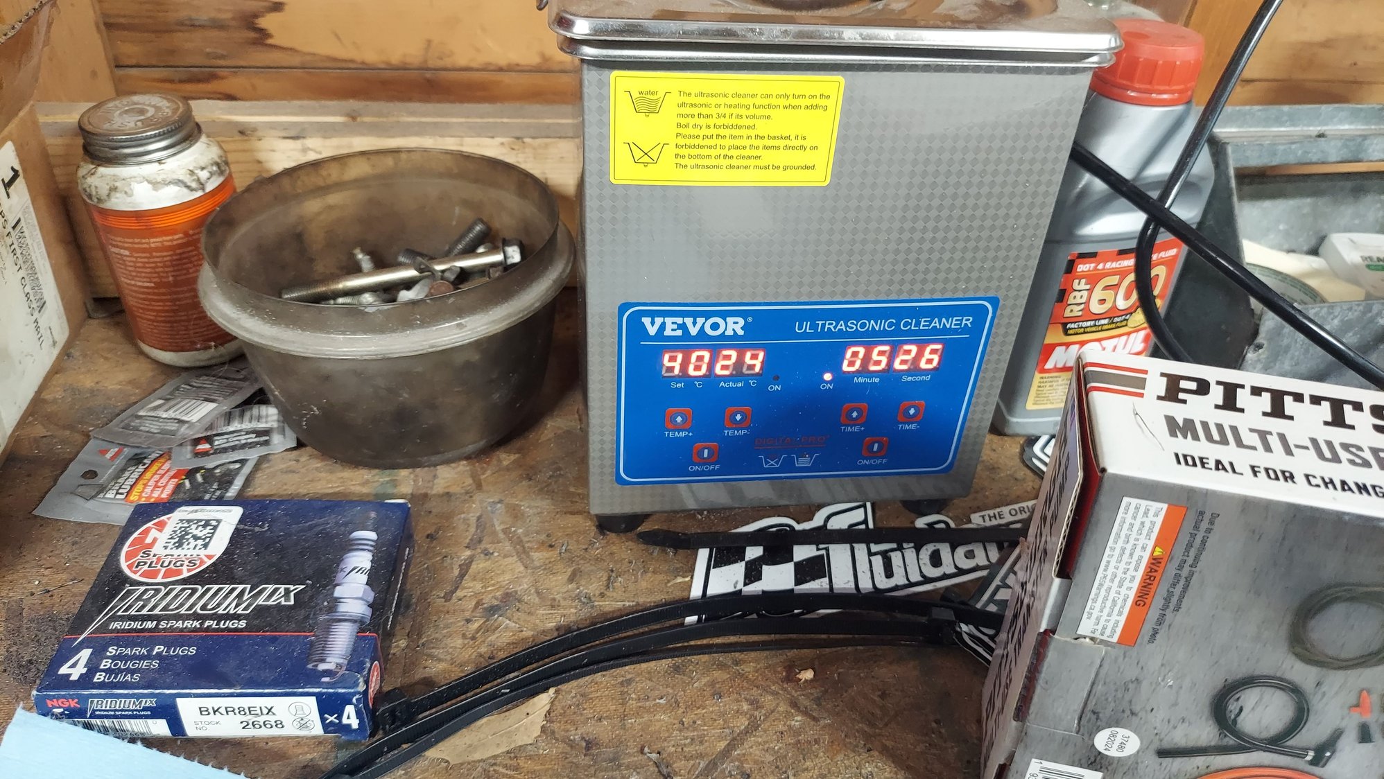

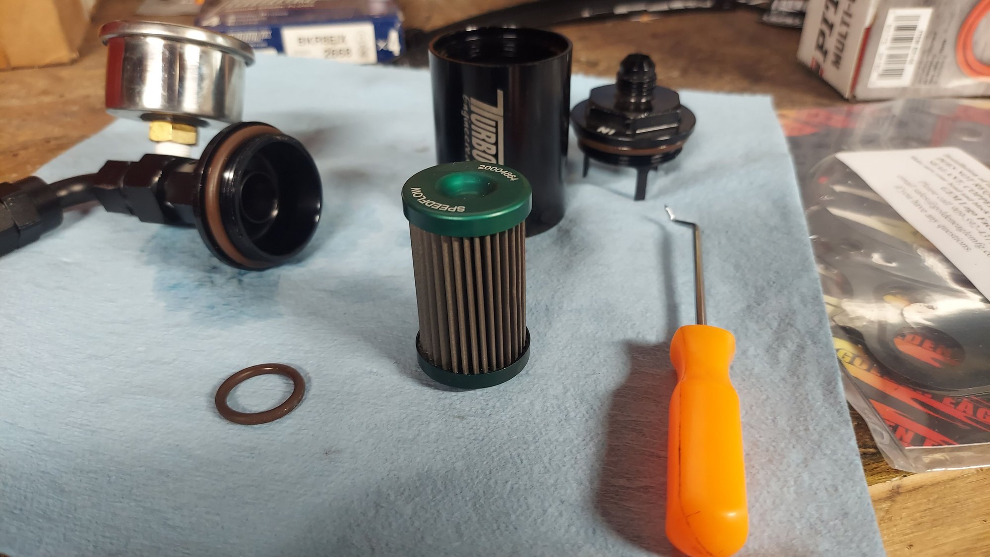

Took apart the inline filter which was pretty dirty
12mins in the ultrasonic cleaner and looks good as new

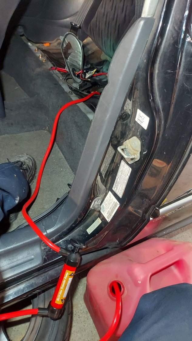

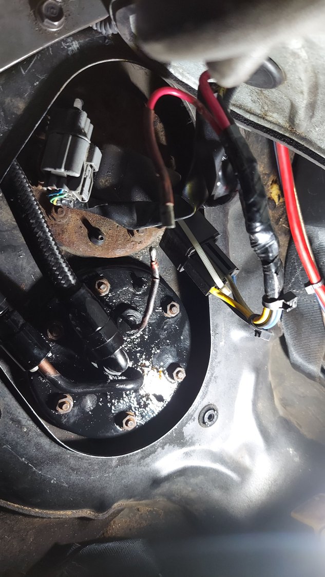

Harbor Freight hand pump worked really good for empting out the fuel tank. Didnt leak at all. Worth the 8 dollars

Why didnt you use the drain on the tank? Is that only on the newer civics?

Say what??? Lol. Didnt even know that was an option. Gona have to look it up now lol

Yea there should be a bolt on the rear driver side.

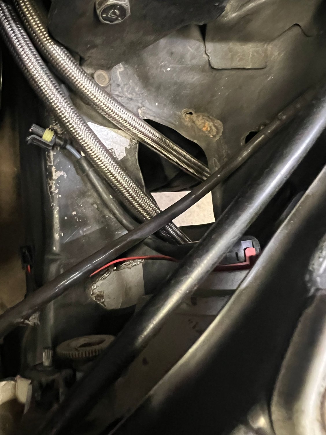

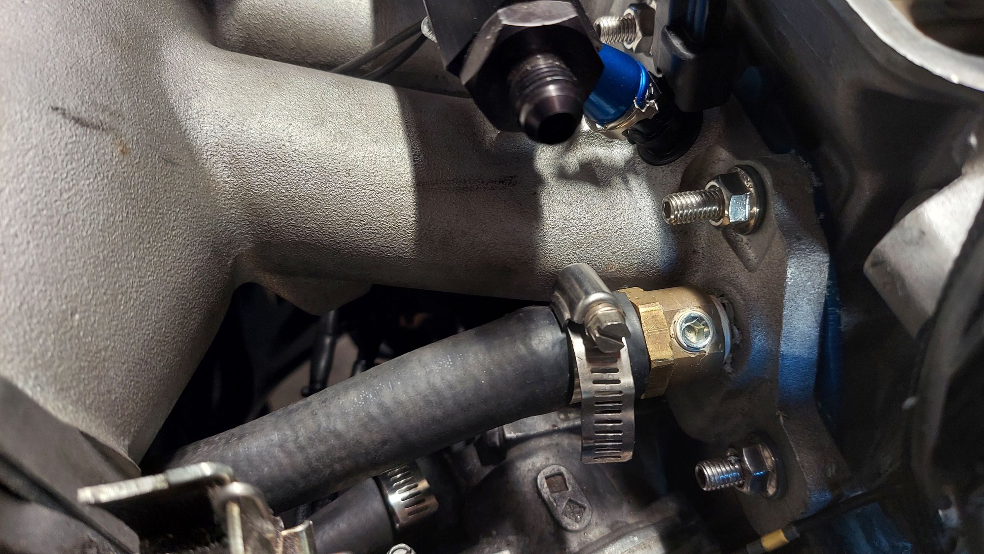

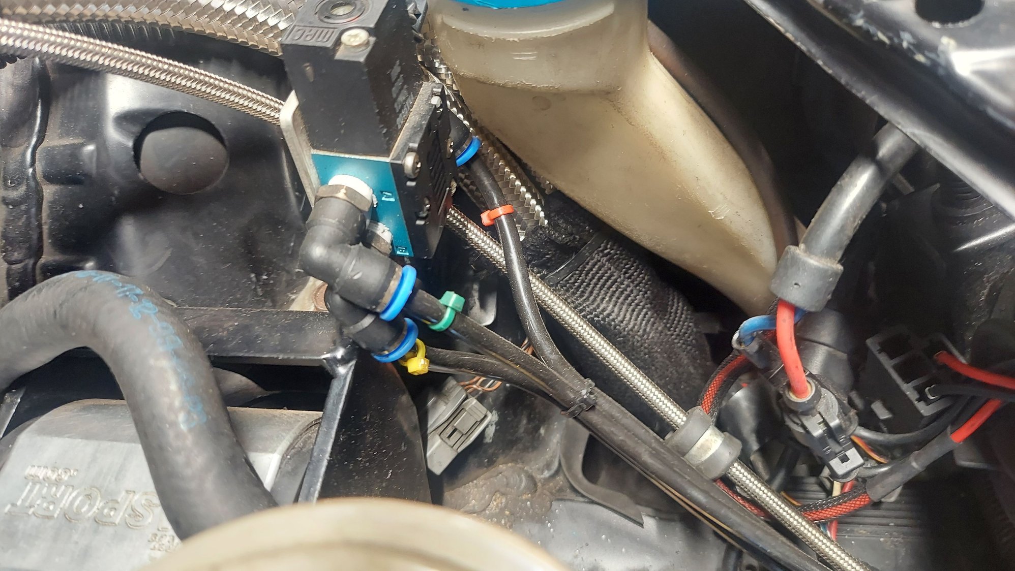

How are you routing your oil cooler lines? I have mine like this
my lines are ran very simliar to yours. However, im going over the mount, hugging the frame rail, zip tied to the hardline there, then over the alternator. I never like running any hoses near the crank pulley or the timing belt

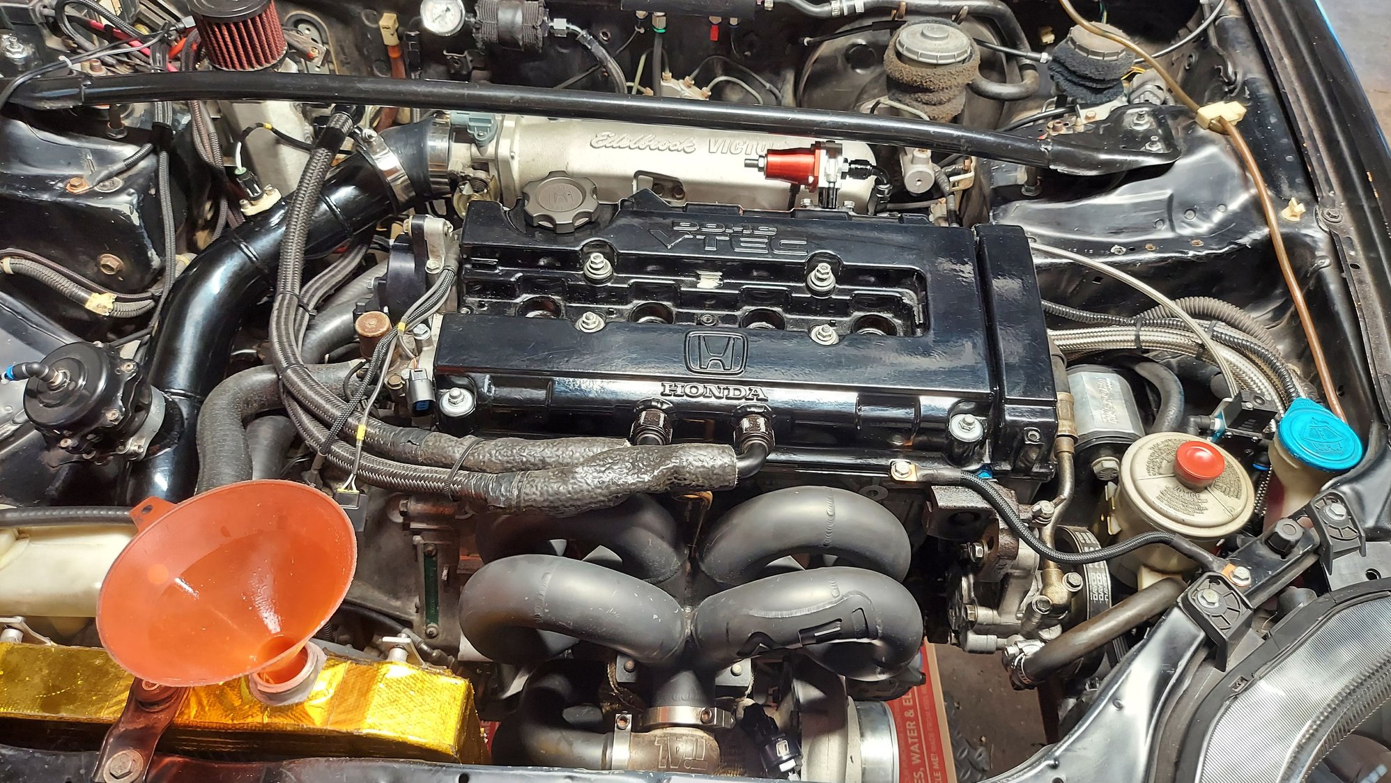

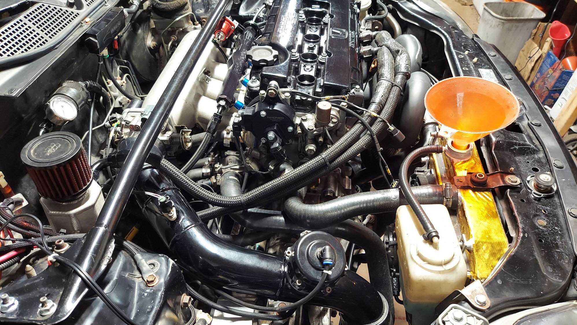

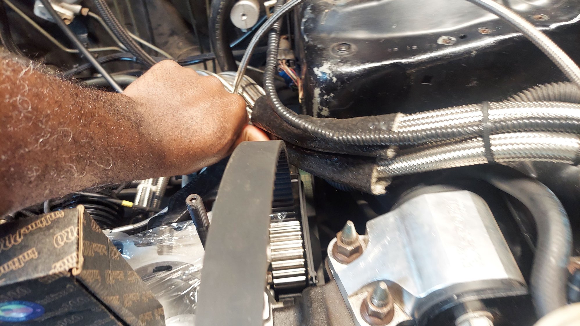

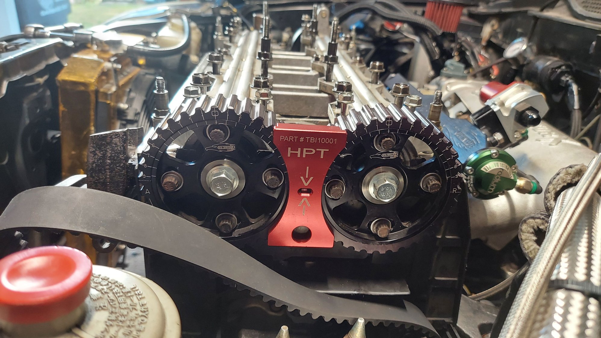

Got the timing locked it. Not happy with the belts tension at TDC. Even rotated it a few degrees prior to tightening the tensioner
Fuel hanger painted and out back into place
When i decide to finally get my coolant water sensor and guage setup, i will be using this port. The hose loops around to the thermostwt housing. Instead of using the radiator adapter or the fancy speedfactory thermostat housing
mechanical all done other installing the battery, new spark plugs, coils/plate, wheels and axle nuts. Also still need to fill the tranny fluid, gas, prime the engine, and bleed the coolant. Feels good to finally be done
Bonus pic. Looks what happen to these plugs. From whatever was happening with that BS cam2 fuel that only sat for six months

That hose is the coolant bypass hose to open the thermostat. Mine was leaking friday from where the clamp grabs and i attempted to bend up some straight 5/8th hose but failed so i just trimmed the hose back and reinstalled it.
Im never happy with the tension on my timing belt but i always pull up on the tensioner with 3/16 welding rod and get the tension i want like that.
Old Aug 11, 2024 | 04:17 AM
  #525
ls joker's Avatar
Loved
Joined: Dec 2009
Posts: 2,249
Likes: 161
From: toledo
Default Re: ''simply BLACK''
Yea i had the bypass hose rip on me before. On the dyno. We just trimmed it back aswell.
Not sure what you mean by pulling up on the tensioner with welding rod. Could you explain? Because i was about to look up secondary tensioners. I dont want to cut up my timing cover though. Theres enough slack at TDC to where i can forcibly slide the belt off the gears. So this needs to get addressed.
Edit..
I know what youre talkimg bout lol. Just another version of the coat hanger trick. Im gona pull thre overs off again. End up only have a few metal coat hangers left. Somehow used alot of them on smores during my bonfires. Left thd spring on the tensioner. Made a small j-hook from the hanger and hooked the spring. Was able to get it tighter. Does not slide off AS easy anymore.
