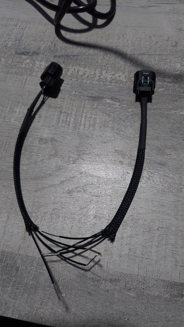

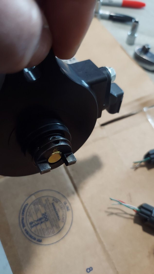

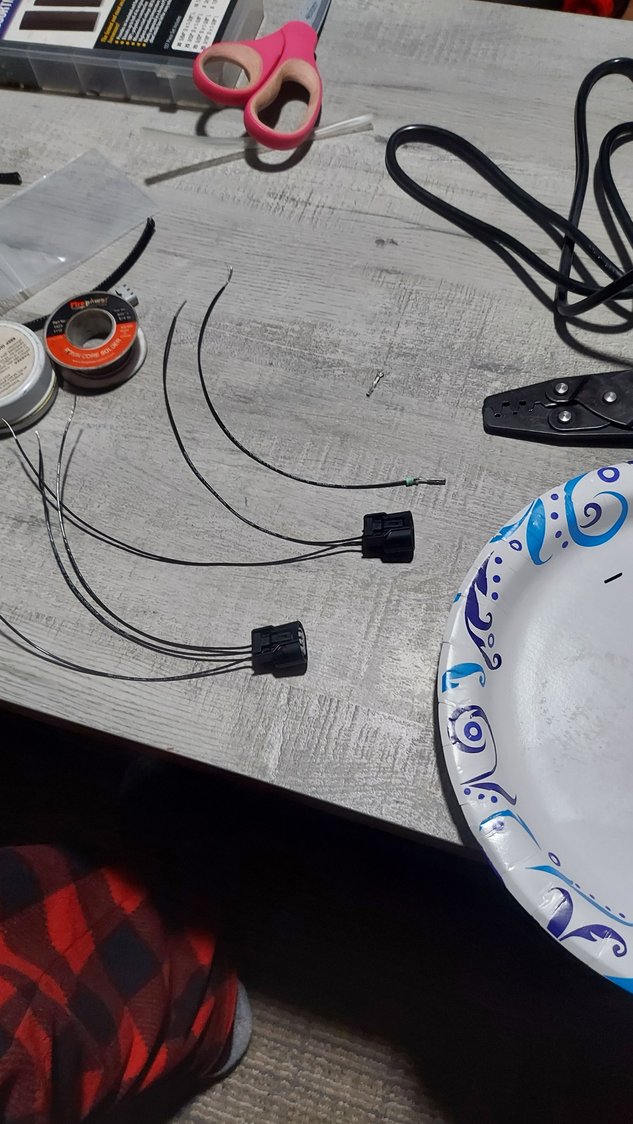

Built and tested the cam angle sensor pigtails and sub harness today. Going to honda tomorros to order my sensors. Then will building the trigger assembly. Finally, pinning the trigger harness.

No soldering! Use open or closed barrel crimps

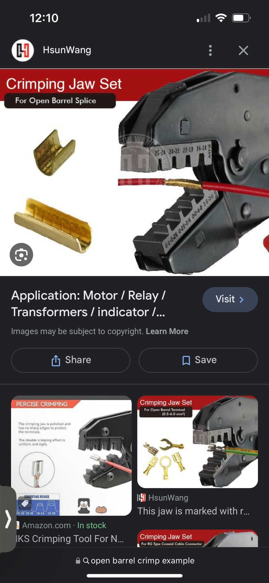

I too have been soldering my connections all these years and want to change that. Ive been wanting to get some open barrel crimps (not the tool but the actual crimp) for splicing wires. At least for under dash wiring. Soldering in there is a PIA.
Any recommendations on where to purchase from? I recently bought a cheap terminal set from HF and it was unbelievably bad. So that has put me off from buying any of the cheapo stuff I see on amazon.
I already have a tool for open barrel crimps, just need to get some crimps themselves.

Look at racespeconline.com.
For a good crimp, you need the proper tooling. Regular ole crimpers arent advised. Crimps and solders both can fail due to improper installation
Racespec is too expensive shop here
https://www.corsa-technic.com/item.p...category_id=64

Yeah I have the correct tool. I bought it when I was doing some open barrel crimps on an duetsch style connector for my injector harness I built so I could quickly swap back to stock injector for emissions testing.
Thanks.

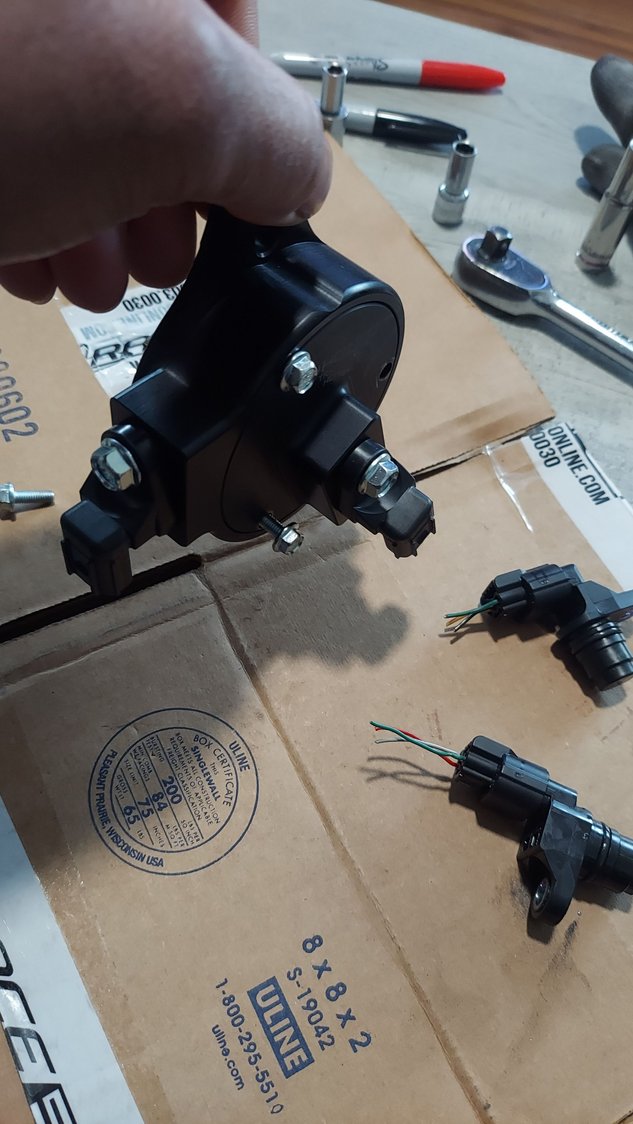

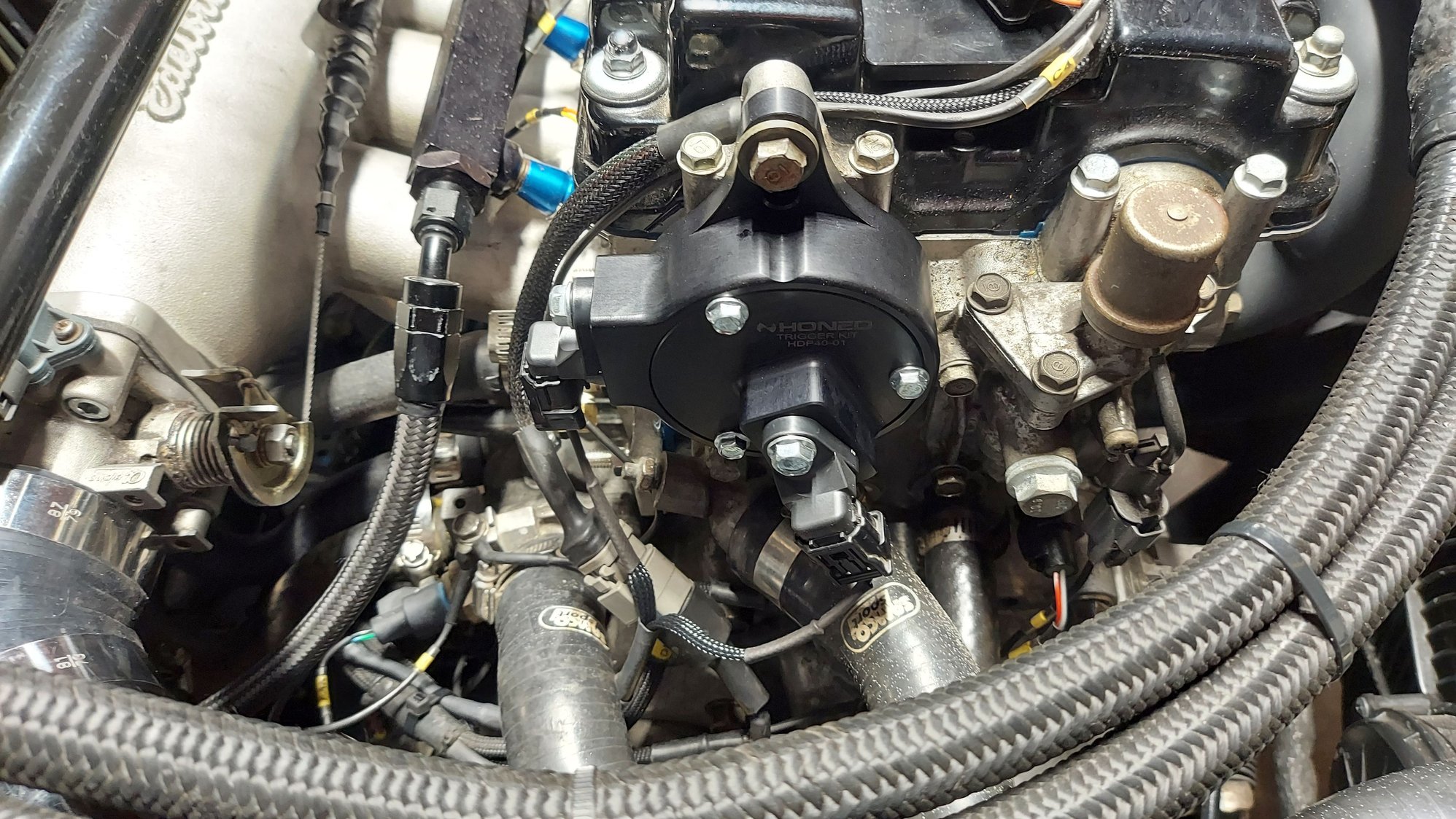

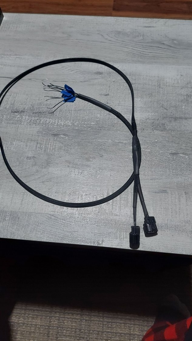

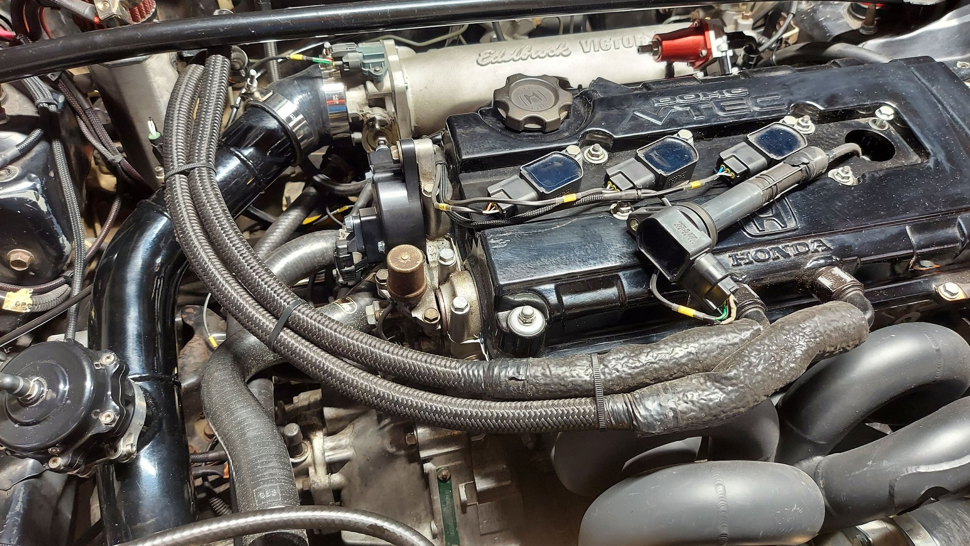

Got the sensors in and everything assembled. Since the engine vibrates pretty hard, i wanted to ensure that the sensors syncing the igntion signal doesnt vibrate loose, causing trigger issues later. I wanted to loctite the threads on the bolts. But the housing is aluminum, and i didnt have and PINK loctite. So i used a light coat of hondabonda on the threads. Used hondabond because i was worried about blue pulling aluminum in the threads in the future.
Got the harness on, routed, ran down to the ecu. Also pictured are some used extra sensors and connectors i picked up for future use. Or if someone purchases honeds trigger kit and is in need of k series cam angle sensors.

How do you read that part number list? I just want some open U open terminals and some open ring terminals for ground. Are any from eBay just as good? Copper is copper right?
I can't make sense of that site's number system. But I like how they rep HP

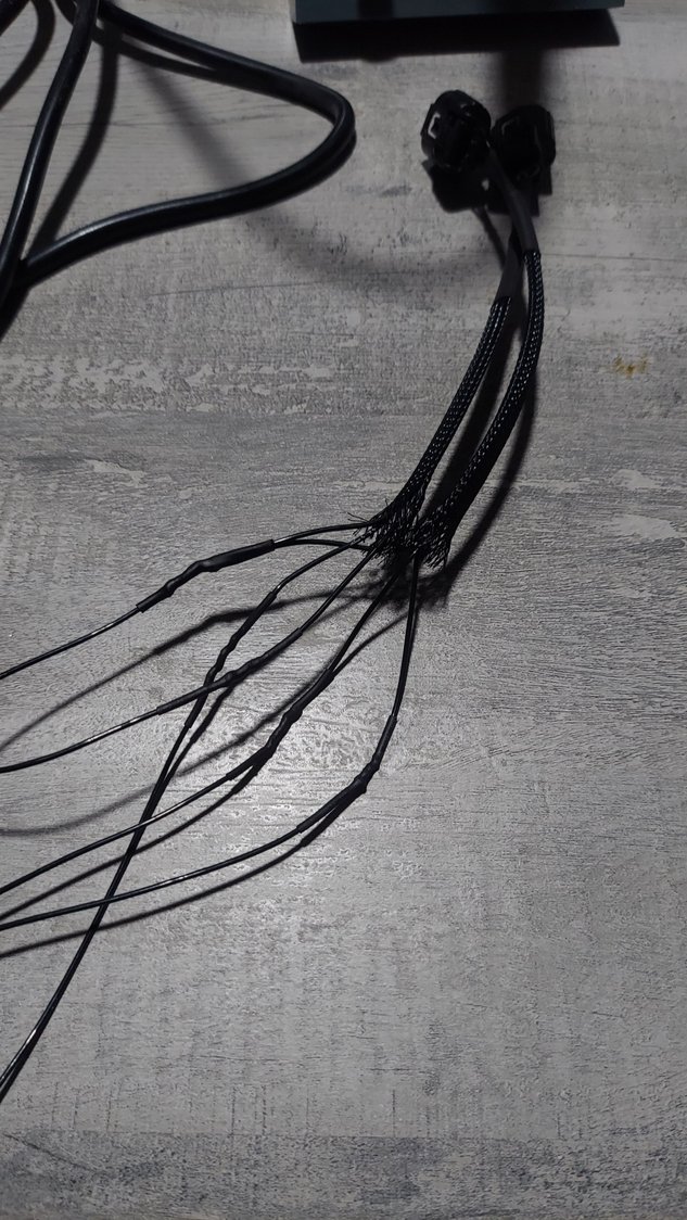

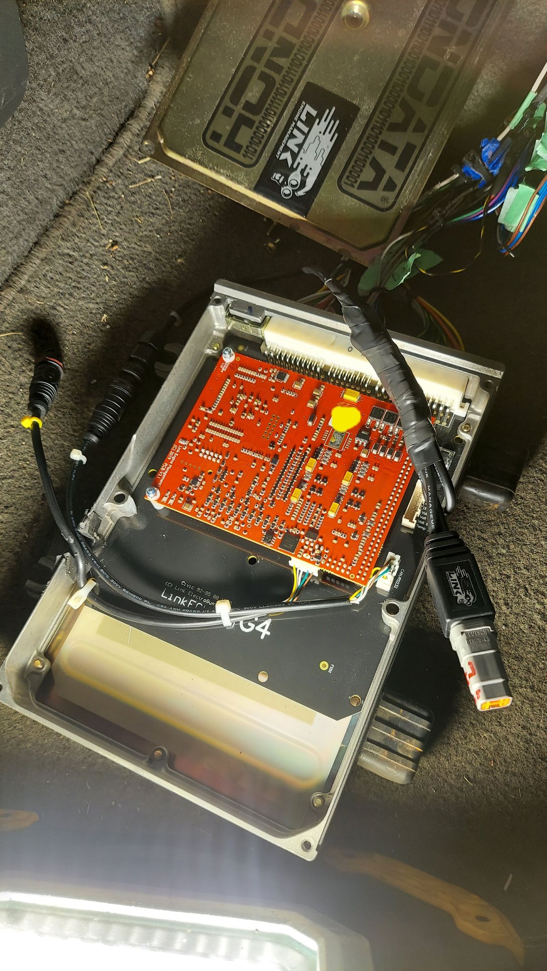

Ecu can bus side done. Ready to be plugged into the mating harness
