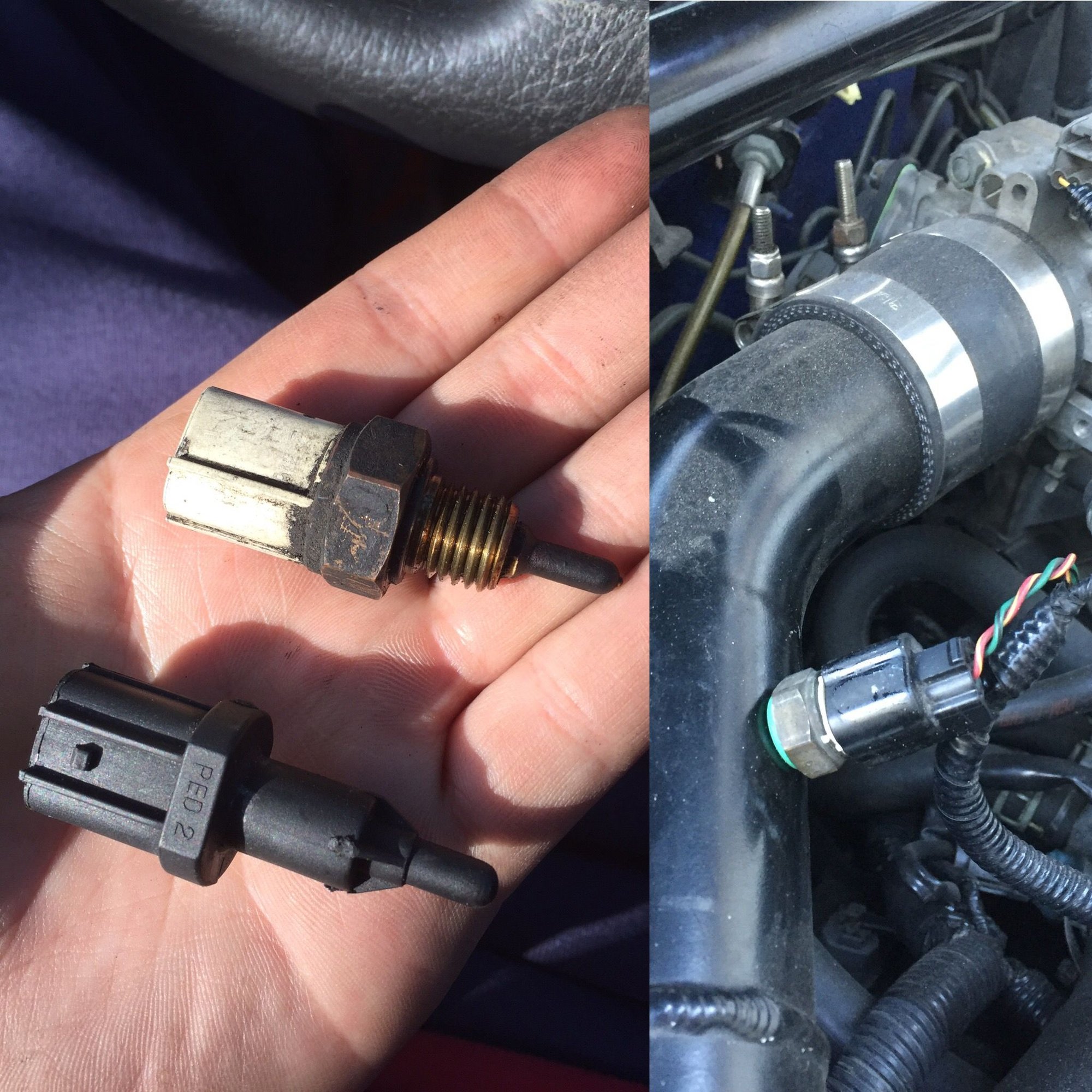

Finally got around to doing this
Took the sensor out of like a 04-05 ish Civic?
Before /after . Seems to have helped throttle response due to heat soak?? Not sure how much colder the air inside the charge pipe vs ambient air in the engine bay is
