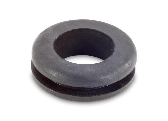

Use the one you already have and pick up a rubber grommet like pictured, take your IAT sensor into the store and see which will fit best, then remove pipe drill hole, insert grommet, insert IAT and done.

That definitely won't work on a pressurized pipe. It'll pop out constantly.

Uhh yeah, LOL! I wish my old SD card didn't crash because I had a funny pic of a friend's zip tie mod to keep it from popping out with the push in style. Rather interesting... but still would push out some. Why not just do it right?
