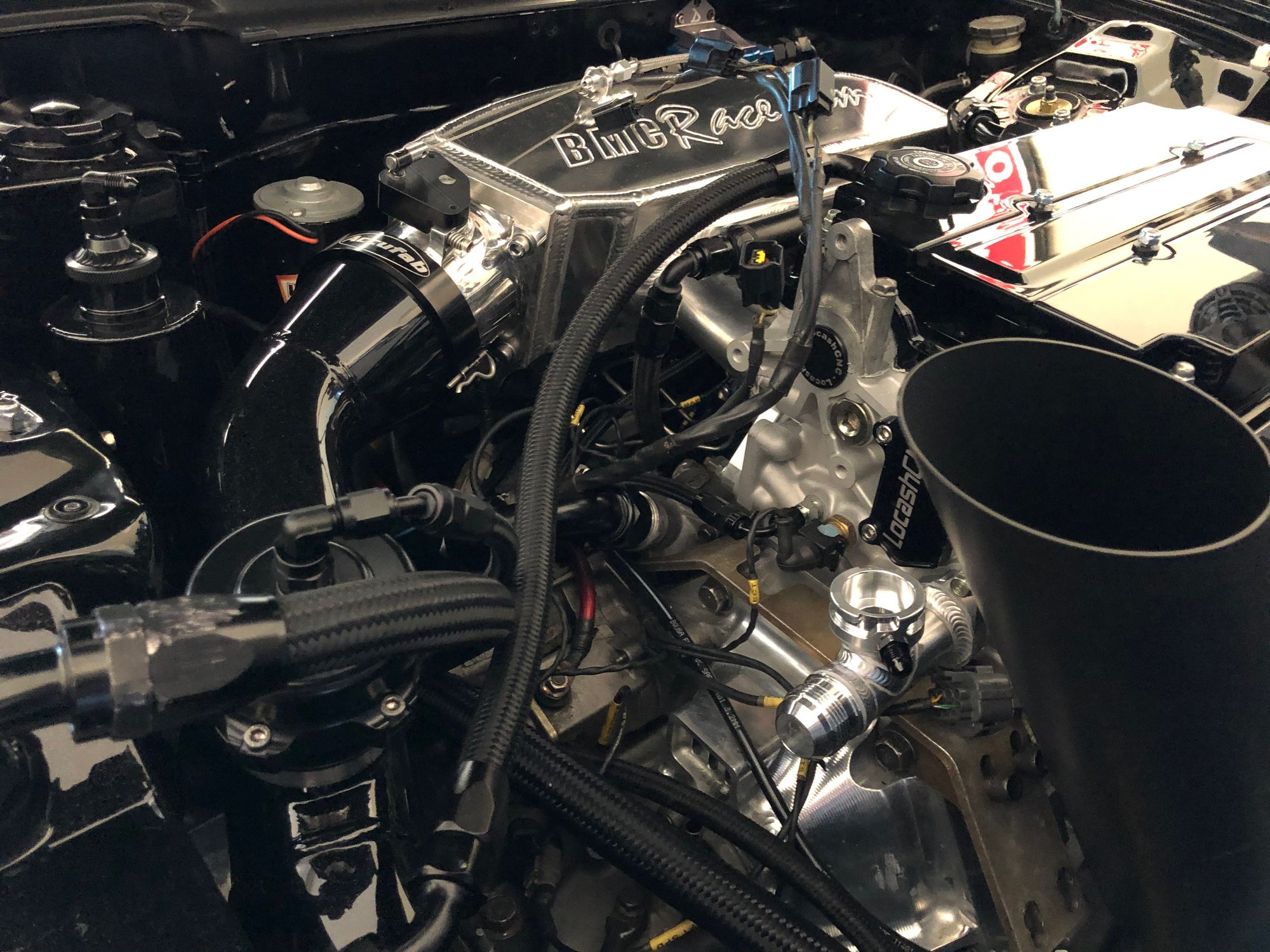

So I need a filler neck for my car and the original plan was to use the stock water neck and basically modify it so I can have the radiator cap with a -16 to run a -16 line.
So because I didn't have the motor together in the car I wanted to wait until everything was done and go from there. Long story short I was like screw making one, I will just buy one. So I go on the Speedfactory website and I see one that looks like it is just what I need, the picture below. I was like this has a nice little kick out on it and it should work perfect, well I get my order yesterday and it's that little stubby one that you see on my car LOL. Now I have no idea if Speedfactory screwed up or the picture they have of their product is wrong but I was like F it, I will make it work. The crappy part is the orientation of the nipple because my overflow bottle sits in the rear so I have to now buy a -4 90, my radiator cap doesn't seem to fit, oh and the flange they use is thinner than the stock flange so the stock bolts don't work.
Good thing I noticed that and didn't over tighten the bolts and screw the head casting.

The one in the picture is for a b16 cylinder head. The one you received is for he GSR cylinder head. K-tuned makes one that's pretty nice that works for the GSR head. I have the K-tuned one on my B16 it fits good and you can change the outlets to different sizes.
https://k-tuned.3dcartstores.com/GSRB18C1-Upper-Coolant-Housing-W-Filler_p_766.html
https://k-tuned.3dcartstores.com/GSR...ler_p_766.html
The one I got will do the job, just had to get a -4 90 degree hose so I can run to the overflow bottle that is towards the fire wall.

I just installed one of those filler necks on my B16 head. That curved neck is so it can go around the dizzy, which looks like in your case isn't an issue. And Speedfactory should really tell you that different bolts are needed. I can see that turning into a real nightmare for someone.

Yeah when you go to the SF website they have B-series filler necks and I saw the curved one so I clicked on it and it gave me options like -16 or 32mm and then GSR or B16 and I selected -16 and GSR thinking they made the curved one for the GSR. I just figured it was made for cars like mine that may not run a distributor and as you can see from my pictures the curved one would have been perfect, away from the up pipe and everything. The stock bolts not fitting was another thing, at least say they won't work anymore or provide 2, for 160 bucks the least you can do is provide a couple bolts LOL.
Once I put the filler neck on, my regular radiator cap didn't seem to work on this neck either, so yesterday I go to prime the motor and turn the water pump on and I notice water coming out from the filler neck under the cap. So now I know the cap doesn't seal properly and I call SF and they tell me I need their radiator cap A, another $45 bucks LOL.

Originally I was going to modify my existing filler neck and basically make it the way it is now except I was going to extend the cap portion higher, like close to the valve cover high. When I saw the curved filler neck though I was like score, I wouldn't have to make my own and what sold me was the curved portion because I don't run a distributor and was like this is great!! I didn't bother to call because they had an option to choose for GSR LOL.
It's a bit of a hassle but since I'm basically done and this is all I really need I was like F it.
