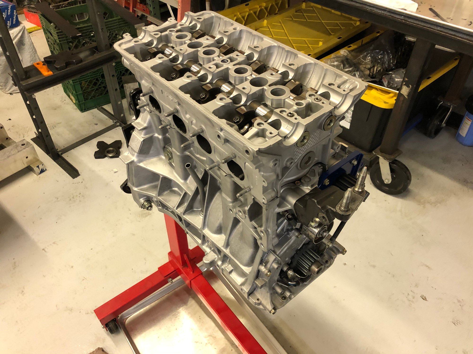

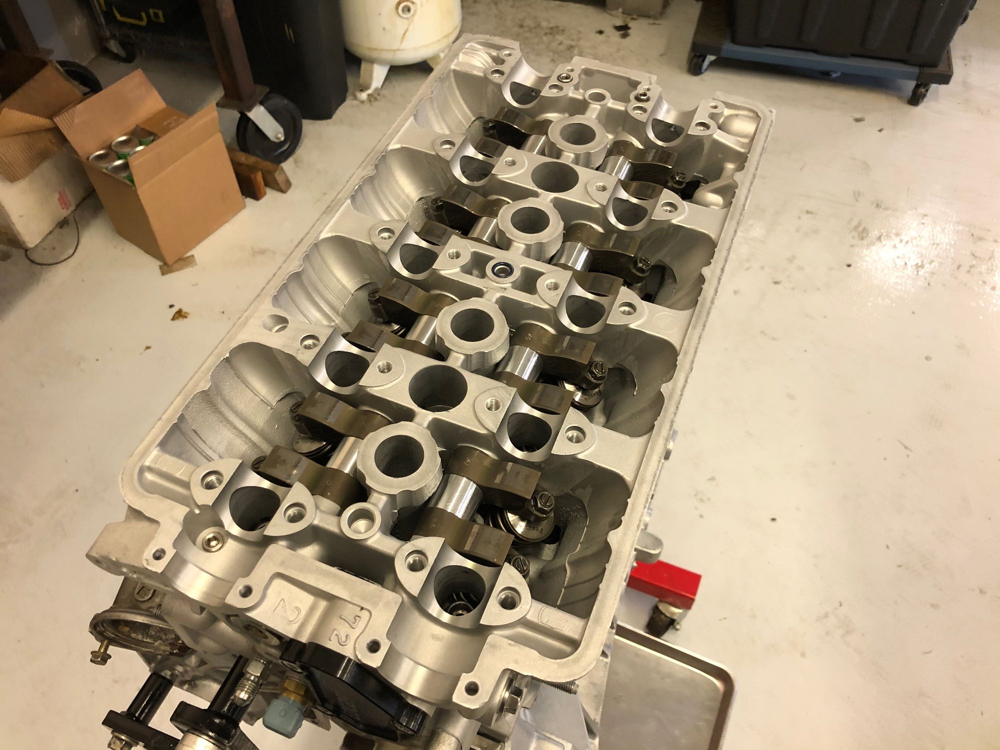

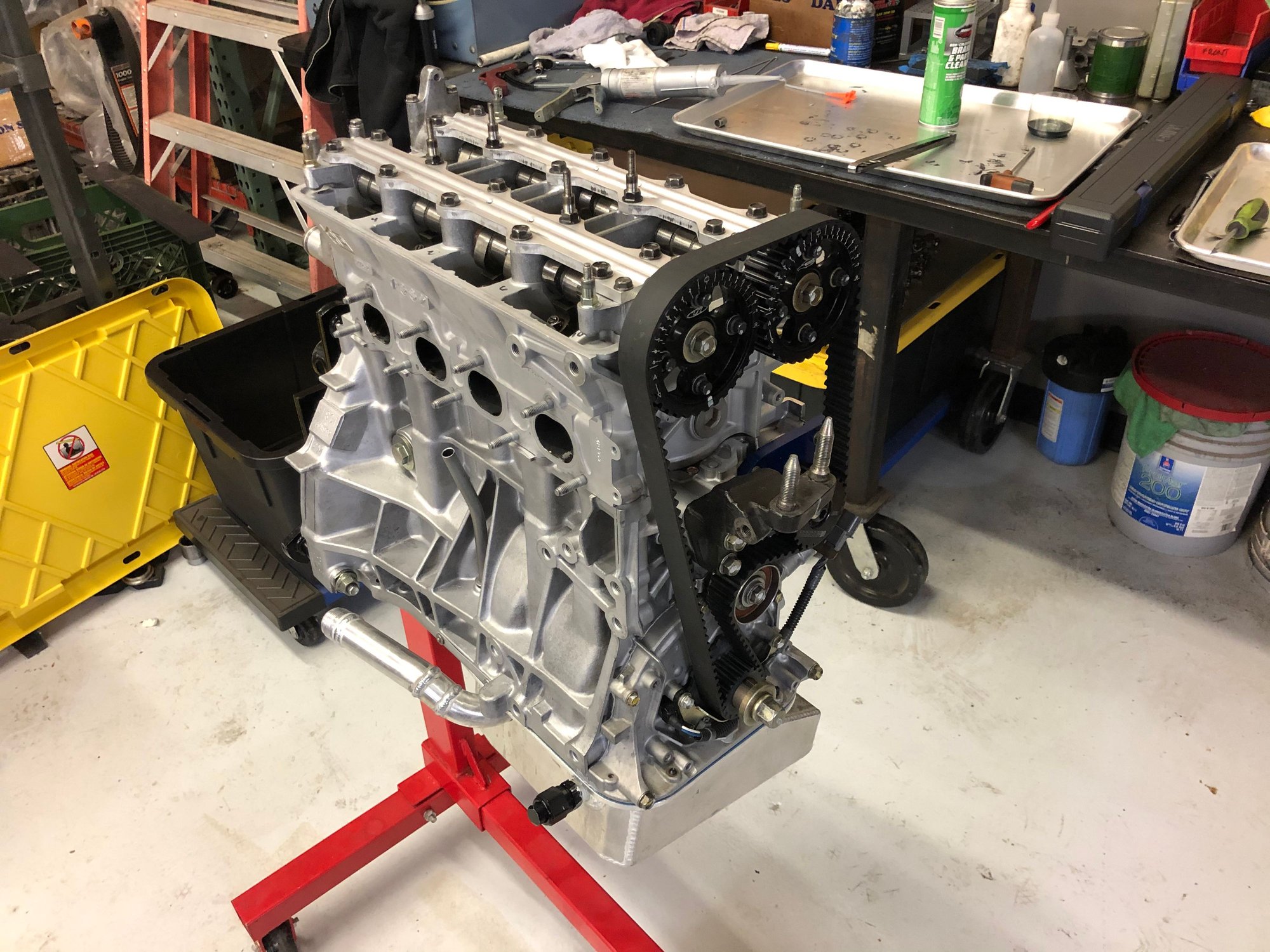

This was basically once I finished everything up and the second to the last picture of when it was getting ready for degreeing the cams.

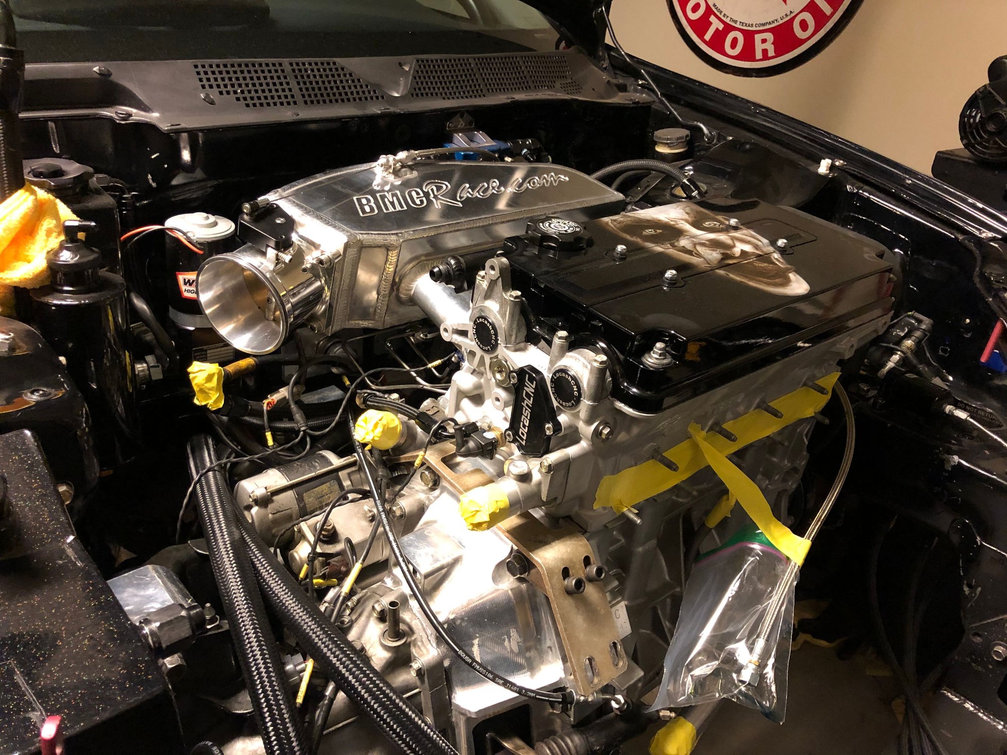

Got a few things done, ran into a few issues with the two nitrous lines. Because I built all these off the motor two of the lines were hitting the water tube so I had to remake two of the lines. I also got the nitrous lines partially wired up now so I don't have to do it while the motor is in. I then realized after I got the motor in that the fuel pressure regulator was literally sitting on the nitrous solenoid and wiring so I had to relocate that to another area of the bay, everything is a tight freaking squeeze in there.
Now I have to finish making the radiator lines, nitrous fuel lines, and a ton of other stuff but at least I am making some progress.

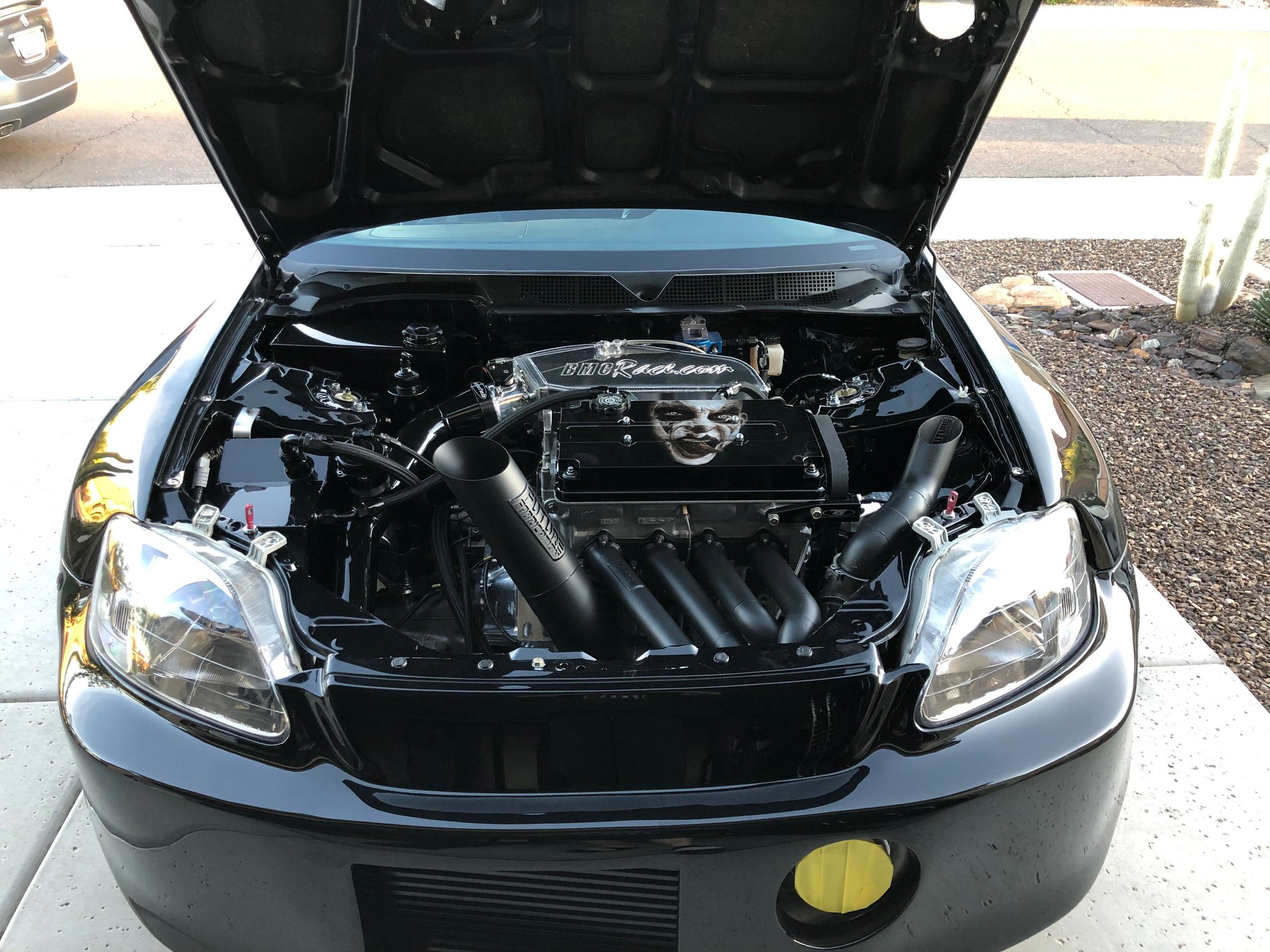

Just about there, there is so much room not having the radiator, fan and hoses up front, I love it.

A few picks, made some more progress!!

Love how the exhaust setup looks like you're throwing the devil's horns

Never noticed that but can totally see that now that you mentioned it LOL
