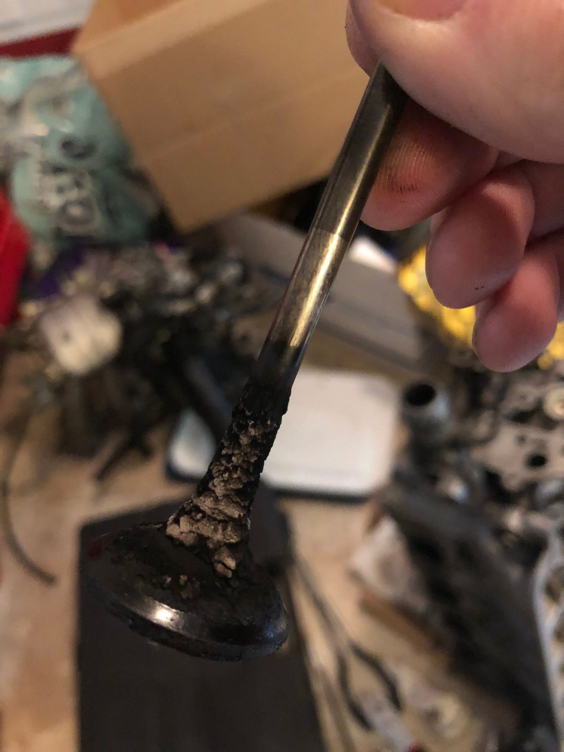

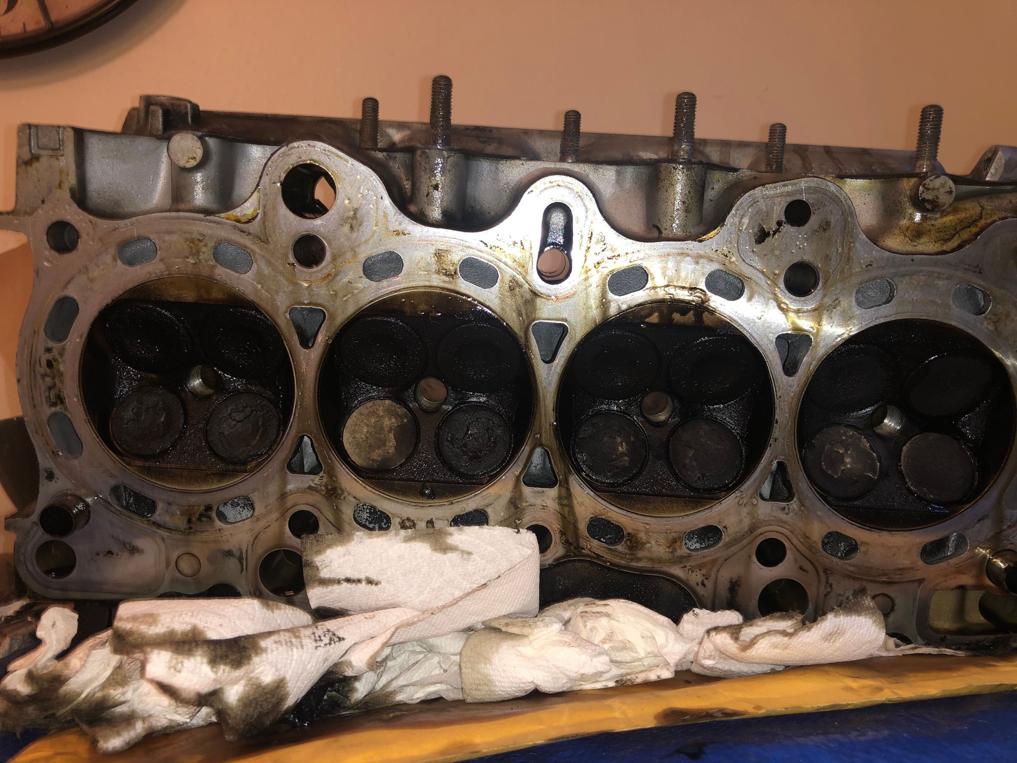

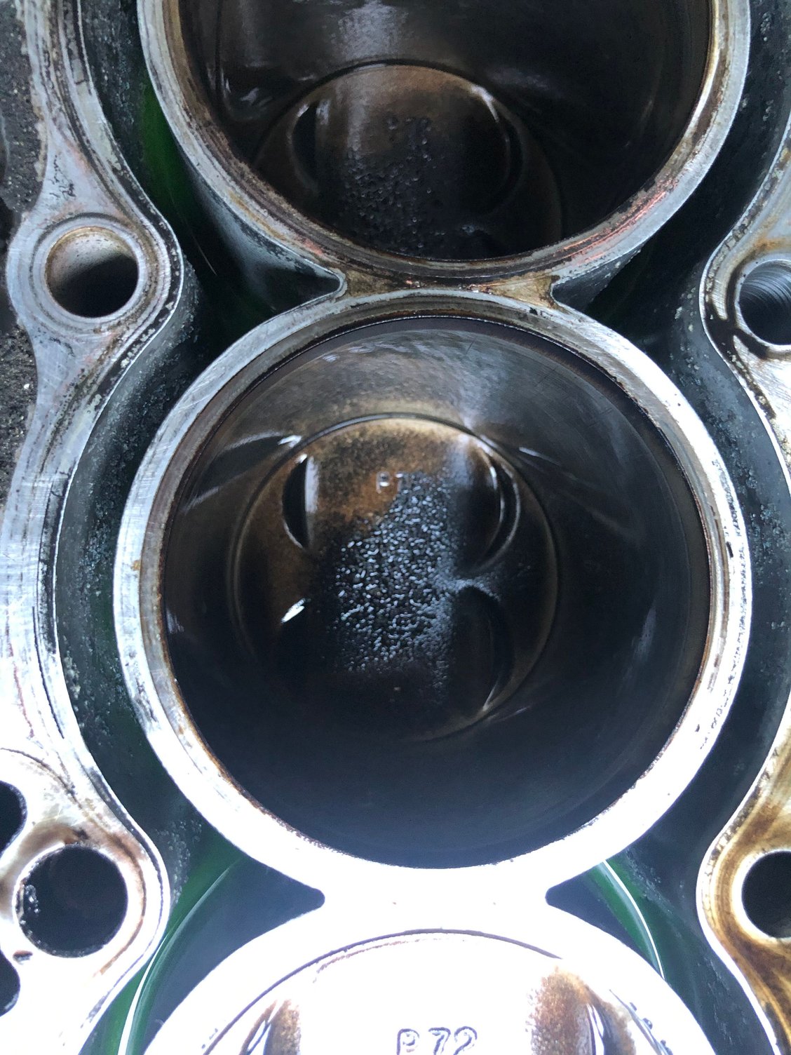

Thank you for your reply. So dry my low cylinder tested at 130 and after pouring a tablespoon of oil in , it tested consistent at 155ish. That was the only test I did before tear down. I have purchased a complete standard size re-ring kit. My cylinders don’t look damaged from what I can see, but I did find a burnt looking valve in cylinder 2 (low compression cylinder). I water tested the head and sure enough that valve dripped water past the seat after a minute consistently. Any advice? I am planning on cleaning, and lapping the valve hoping to fix the issue because it does not appear bent or to have a hole in it. And while I have engine apart I am repacking crank bearings, rod bearings, and piston rings to make sure it’s not the bottom end. Thanks 🙏🏻 Here are pics of cyl 2 and the head with the valve that’s not sealing. There is also a weird white buildup on my valves.
