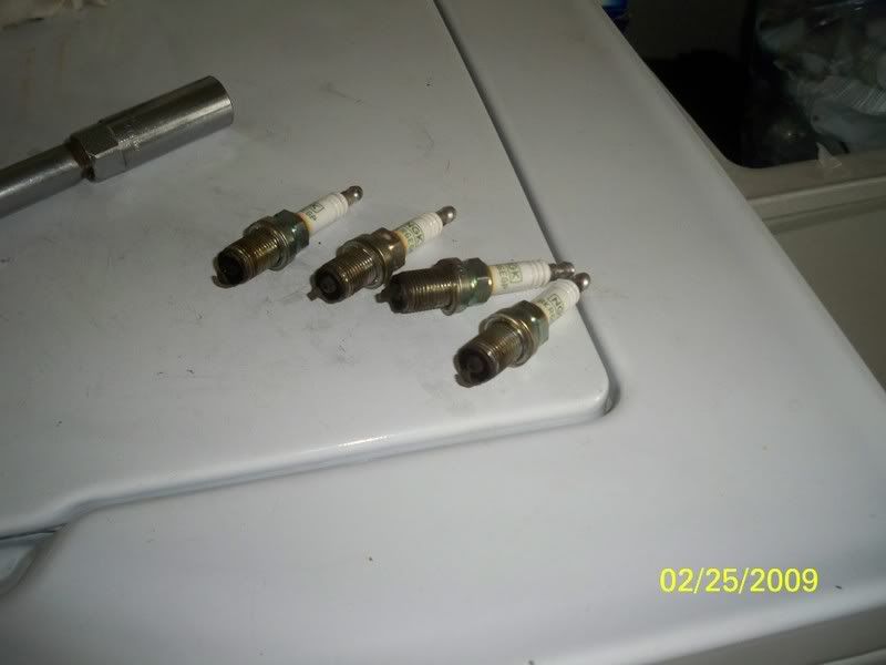

check your spark plugs, pull one out and post a pic.

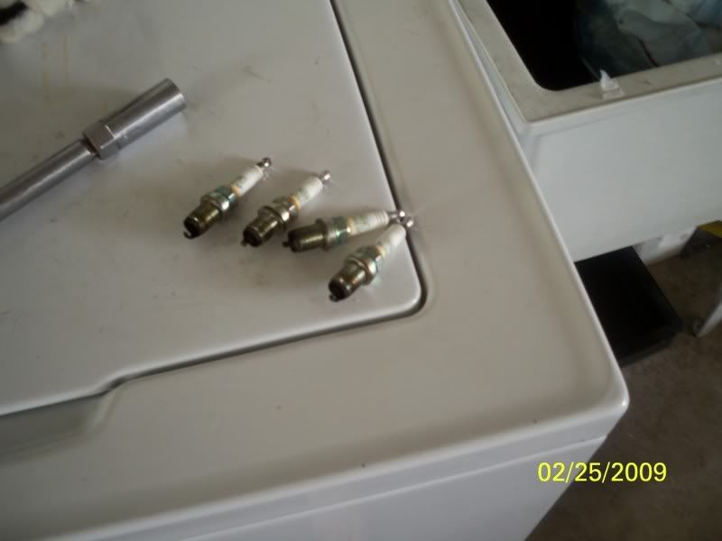

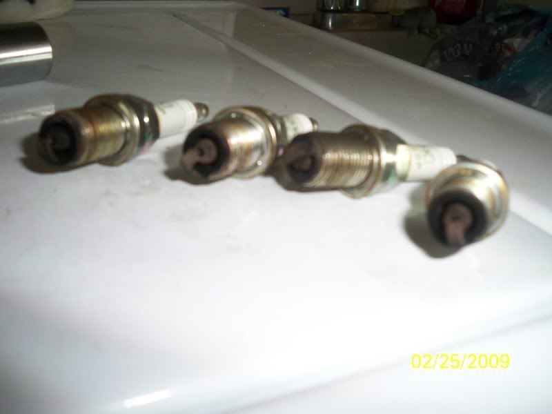

Default Re: check engine light on
Old Feb 25, 2009 | 11:27 AM
sirt_eg's Avatar
Posts: 765
From: 763
looks like carbon build up. Check your timing, and any vacuum leaks.
